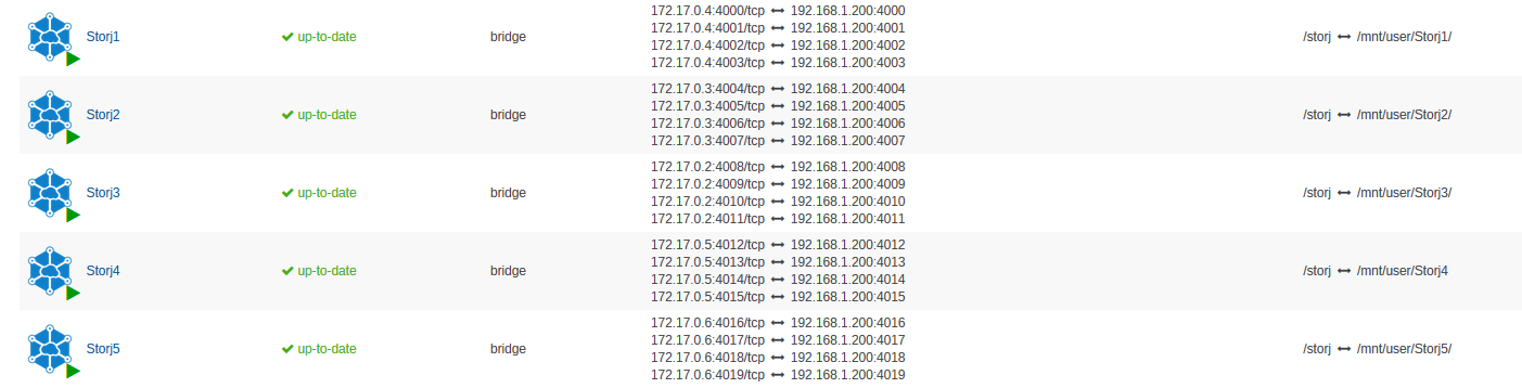

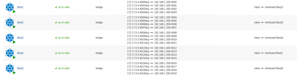

@MrChunky I have already running several Storj containers the problem is that despite having them in diferent ports and working unraid tell me that they are using the same ports. THe json files have differnet ports 4000 4004 and 4008 and the firewall has open this ports and reporting the traffic correctly Still in advance mode I don't see the container port field root@MediaCenter:~# docker exec Storj3 storjshare status ┌─────────────────────────────────────────────┬─────────┬──────────┬──────────┬─────────┬───────────────┬─────────┬──────────┬───────────┬──────────────┐ │ Node │ Status │ Uptime │ Restarts │ Peers │ Allocs │ Delta │ Port │ Shared │ Bridges │ ├─────────────────────────────────────────────┼─────────┼──────────┼──────────┼─────────┼───────────────┼─────────┼──────────┼───────────┼──────────────┤ │ dcea81e7741aeb8db49174ac5821d9035b00e532 │ running │ 2m 25s │ 0 │ 129 │ 0 │ 18ms │ 4008 │ ... │ connected │ │ → /storj/share │ │ │ │ │ 0 received │ │ (TCP) │ (...%) │ │ └─────────────────────────────────────────────┴─────────┴──────────┴──────────┴─────────┴───────────────┴─────────┴──────────┴───────────┴──────────────┘ root@MediaCenter:~# docker exec Storj storjshare status ┌─────────────────────────────────────────────┬─────────┬──────────┬──────────┬─────────┬───────────────┬─────────┬──────────┬───────────┬──────────────┐ │ Node │ Status │ Uptime │ Restarts │ Peers │ Allocs │ Delta │ Port │ Shared │ Bridges │ ├─────────────────────────────────────────────┼─────────┼──────────┼──────────┼─────────┼───────────────┼─────────┼──────────┼───────────┼──────────────┤ │ 6ec5490584a014188a8e3ae366d5e17ed7749bf1 │ running │ 2h 6m 4… │ 1 │ 120 │ 3 │ ... │ 4000 │ 505.73MB │ connected │ │ → /storj/share │ │ │ │ │ 0 received │ │ (TCP) │ (0%) │ │ └─────────────────────────────────────────────┴─────────┴──────────┴──────────┴─────────┴───────────────┴─────────┴──────────┴───────────┴──────────────┘ root@MediaCenter:~# docker exec Storj storjshare status ^[[A^[[A^[[A ┌─────────────────────────────────────────────┬─────────┬──────────┬──────────┬─────────┬───────────────┬─────────┬──────────┬───────────┬──────────────┐ │ Node │ Status │ Uptime │ Restarts │ Peers │ Allocs │ Delta │ Port │ Shared │ Bridges │ ├─────────────────────────────────────────────┼─────────┼──────────┼──────────┼─────────┼───────────────┼─────────┼──────────┼───────────┼──────────────┤ │ 6ec5490584a014188a8e3ae366d5e17ed7749bf1 │ running │ 2h 6m 4… │ 1 │ 121 │ 3 │ ... │ 4000 │ 505.73MB │ connected │ │ → /storj/share │ │ │ │ │ 0 received │ │ (TCP) │ (0%) │ │ └─────────────────────────────────────────────┴─────────┴──────────┴──────────┴─────────┴───────────────┴─────────┴──────────┴───────────┴──────────────┘ root@MediaCenter:~# docker exec Storj2 storjshare status ┌─────────────────────────────────────────────┬─────────┬──────────┬──────────┬─────────┬───────────────┬─────────┬──────────┬───────────┬──────────────┐ │ Node │ Status │ Uptime │ Restarts │ Peers │ Allocs │ Delta │ Port │ Shared │ Bridges │ ├─────────────────────────────────────────────┼─────────┼──────────┼──────────┼─────────┼───────────────┼─────────┼──────────┼───────────┼──────────────┤ │ 4dd54ed8e3b68fe752618e17055e4eec52114b4c │ running │ 15m 21s │ 0 │ 156 │ 1 │ 4ms │ 4004 │ ... │ connected │ │ → /storj/share │ │ │ │ │ 0 received │ │ (TCP) │ (...%) │ │ └─────────────────────────────────────────────┴─────────┴──────────┴──────────┴─────────┴───────────────┴─────────┴──────────┴───────────┴──────────────┘

@MrChunky Clould you post an screenshot of your port mapping column in the docker tab? In the port configuration in unraid I only have Host port not Container port...

For me it works If I have one in host and another in custom br0, the problem with br0 is that I have problems with port forwarding Unraid is reporting the port 4000 despite in the json file I have 4004 192.168.1.214:4000/tcp192.168.1.214:4000 192.168.1.214:4001/tcp192.168.1.214:4001 192.168.1.214:4002/tcp192.168.1.214:4002 192.168.1.214:4003/tcp192.168.1.214:4003 and now it works, don't ask me why root@MediaCenter:~# docker exec Storj2 storjshare status ┌─────────────────────────────────────────────┬─────────┬──────────┬──────────┬─────────┬───────────────┬─────────┬──────────┬───────────┬──────────────┐ │ Node │ Status │ Uptime │ Restarts │ Peers │ Allocs │ Delta │ Port │ Shared │ Bridges │ ├─────────────────────────────────────────────┼─────────┼──────────┼──────────┼─────────┼───────────────┼─────────┼──────────┼───────────┼──────────────┤ │ 4dd54ed8e3b68fe752618e17055e4eec52114b4c │ running │ 3m 54s │ 0 │ 101 │ 0 │ 50ms │ 4004 │ ... │ connected │ │ → /storj/share │ │ │ │ │ 0 received │ │ (TCP) │ (...%) │ │ └─────────────────────────────────────────────┴─────────┴──────────┴──────────┴─────────┴───────────────┴─────────┴──────────┴───────────┴──────────────┘ root@MediaCenter:~# docker exec Storj storjshare status ┌─────────────────────────────────────────────┬─────────┬──────────┬──────────┬─────────┬───────────────┬─────────┬──────────┬───────────┬──────────────┐ │ Node │ Status │ Uptime │ Restarts │ Peers │ Allocs │ Delta │ Port │ Shared │ Bridges │ ├─────────────────────────────────────────────┼─────────┼──────────┼──────────┼─────────┼───────────────┼─────────┼──────────┼───────────┼──────────────┤ │ 6ec5490584a014188a8e3ae366d5e17ed7749bf1 │ running │ 3h 16m … │ 0 │ 105 │ 3 │ 0ms │ 4000 │ 505.73MB │ connected │ │ → /storj/share │ │ │ │ │ 0 received │ │ (TCP) │ (0%) │ │ └─────────────────────────────────────────────┴─────────┴──────────┴──────────┴─────────┴───────────────┴─────────┴──────────┴───────────┴──────────────┘ THe only problem is that needs around 120MB or RAM and when is actually doing something I have read that it can take up to 1 GB
