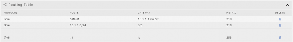

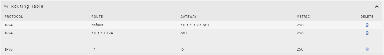

  23. Just got it working without editing the routing table. I just edited the docker settings instead, enabling br0.2, then selected br0.2 for the qbittorrentvpn docker and changed the IP to 10.1.2.54 and done. It's now sharing that other dedicated VLAN with the developer VM. It would probably be a better idea for me to put it in its completely separate VLAN but that will do for now, as I would need to shut down all the VMs/shares to edit the network settings and I can't do that right now (hosting some semi-important stuff). Thanks for your help by the way, happy you immediately found the issue. I will probably do some network redesign next time I do a planned maintenance.
  24. I'm still learning when it comes to networking (I started this pfSense project from scratch), what I currently have is my LAN network on 10.1.1.0/24 and I have a couple of VLANs on different /24 subnets. All of my "safe" LAN devices (such as my desktop, my server and most of its VMs and dockers) are in that same subnet. In Unraid, I have eth0 with "VLAN number" set to 2 because I have one VM using br0.2 instead of br0. That VM is in its own separate VLAN. When it comes to the routing table however, I only have what I consider to be the default settings: Not sure what to add/edit exactly. I wouldn't mind the docker to be in the 10.1.3.0/24 subnet but I guess it would require some additional route and/or something on the pfSense side since that subnet just doesn't exist currently for pfSense. I guess this is more of a general Unraid and routing question that has nothing to do with this thread at this point.
