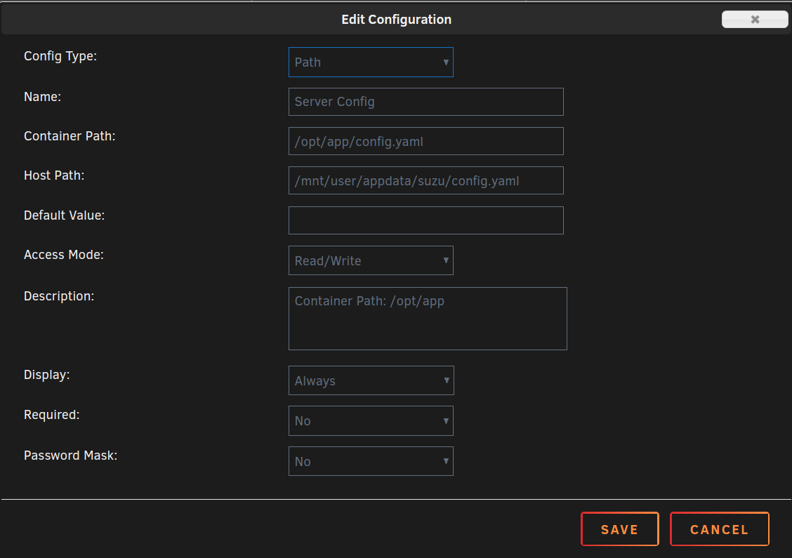

@404fox There is a default config file included in the server code (link here). You can override settings from this config by providing your own with a path variable in the szurubooru-api container like this in unraid However this is optional. You do not need a user-defined config for Szurubooru to run. Double check these: Ensure you are using both szurubooru-api and szurubooru-client. You need both in order to run this Verify the Postgres variables in the szurubooru-api container (Host, User, Password) Verify your Postgres server is reachable Verify you have correct Backend Host in szurubooru-client (should be the same IP as your unraid host) Verify szurubooru-api can successfully map the Api Port to 6666 (the default) as this is what szurubooru-client will try to access

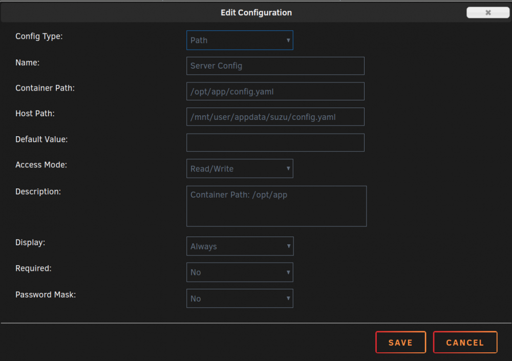

@mrguymiah the instructions I gave are still correct -- just forced a container update to make sure nothing had changed. Yes it is a path config type. Make sure 1) the file exists at the location you are specifying 2) you aren't adding extra slashes or anything to the path values. Here is what mine looks like
