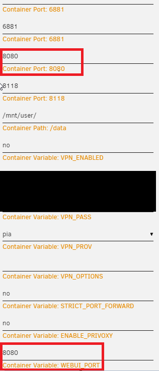

  15. Seems that the webui ONLY works when set to port 8080. changing it to anything else results in not being able to get to the gui. what gives?
  16. okay i lied, it did work after disabling the vpn, i guess I didn't give it enough time. But I have a new question. When editing the settings there are 2 areas that have port 8080, one labeled WebGUI and one not. What is the non gui port for? I Assume I only need to change the gui one to affect which port the gui is accessed from?
