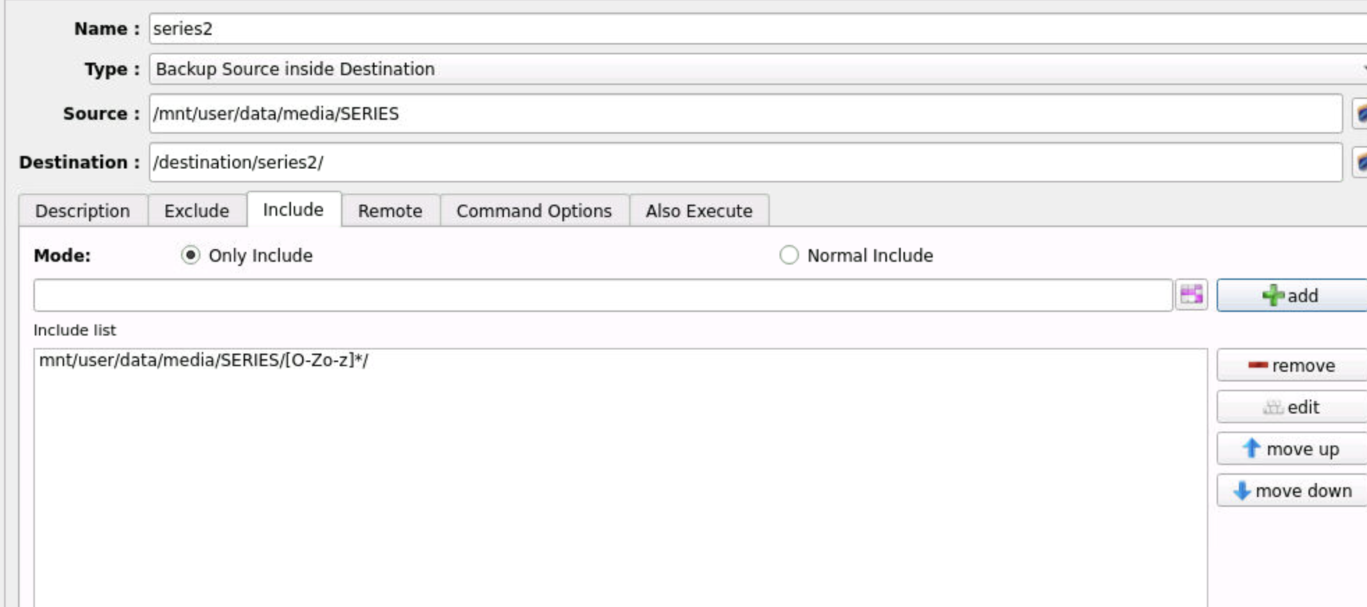

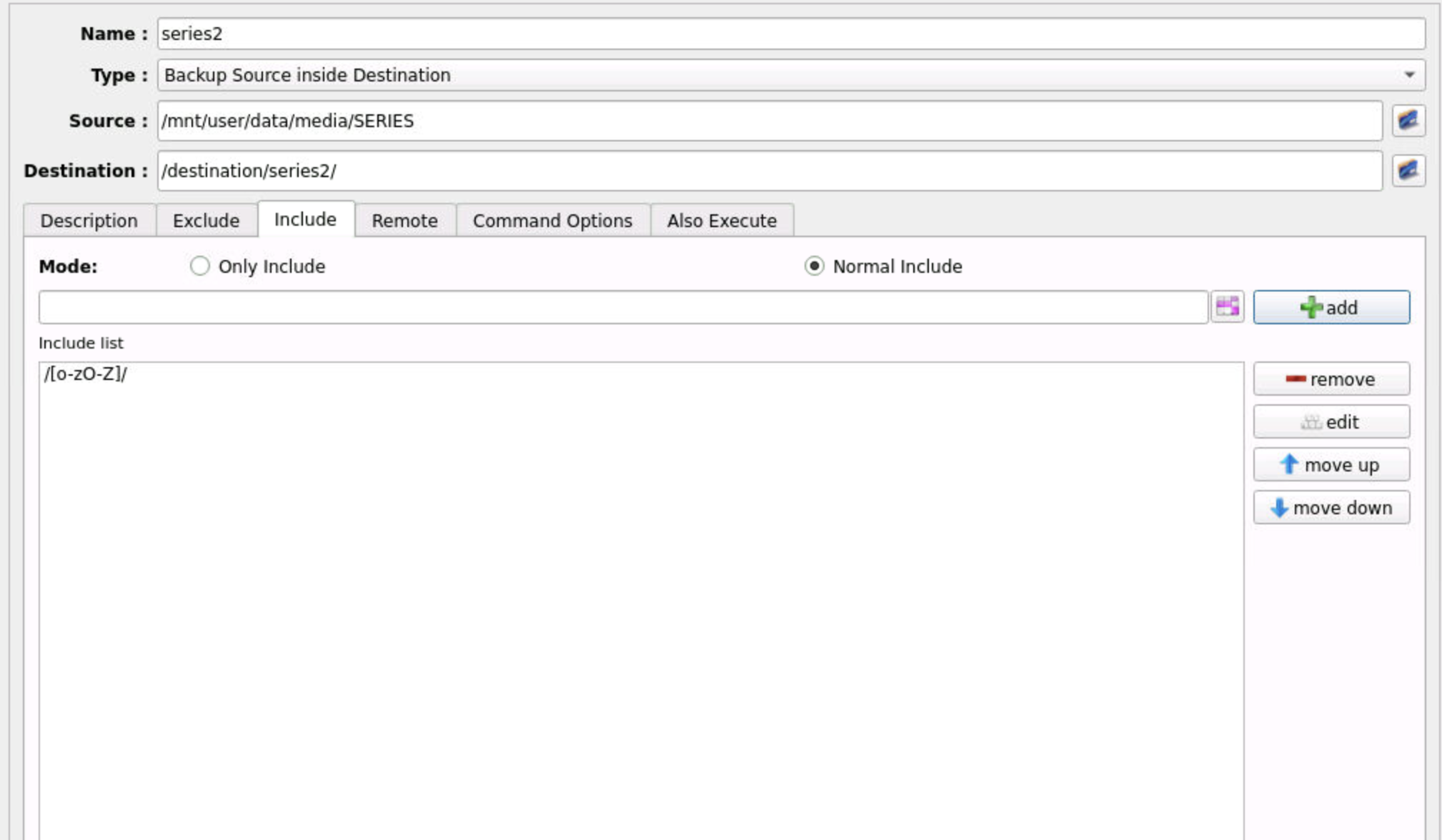

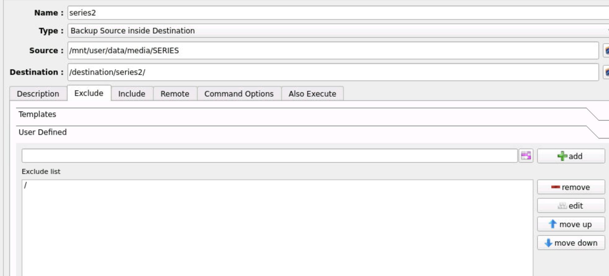

  17. it syncs subfolders and files. But i don't why i had to delete and recreate the exclude part. Also this should have worked without exclude and with only include. Anyway thanks i appreciate your help.
  18. thank you. I think it's good. For whatever reason i had to delete and recreate the exclude part but when i look at the command line (validate button) it's the same. For now it started to transfer folder starting with "O" right in the root of destination disk.
  19. using this it starts to transfer the whole directory : folder starting with a number and i stopped it.
  20. i tried many combinations
  21. if use the pattern editor with only include it backup the whole folder. If i don't use the pattern editor but i append the pattern at the end of the source it warns me nothing will be done as i included only tasks that will be skipped
  22. Hi, I'm trying to setup luckybackup to backup my server. Media files will backed up once and then backup will be updated 2 or 3 times a year so don't need a planification for these. Some of my media directories are larger than the backup disks. for example i try to split the backup of tv folder in 2 tasks. Each task backup to a different disk. For that i use pattern to backup a set of directories which name start with. When i use a single letter it works but not if i use a range like [P-Z]. Can i use it or do i have to split a task into several set of directories each one with the name starting with a single letter?
