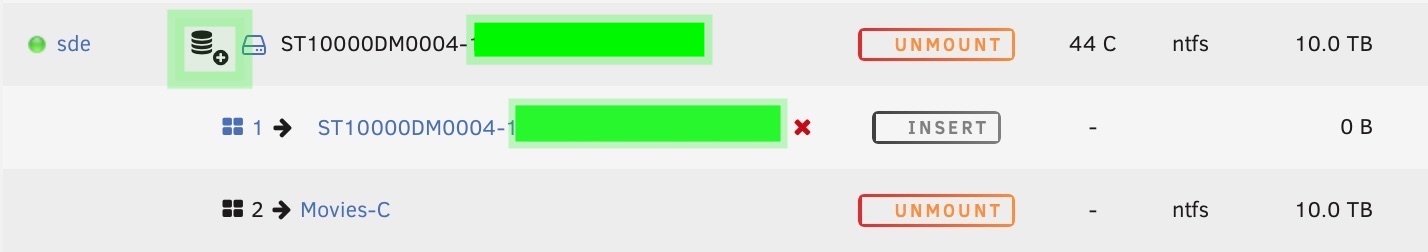

My UD attached disks have mostly had valid but not needed partitions deleted. The exception are the 10TB drives like the one pictured above. As the partitions usually reserved for EFI are not valid, they are not mounted. That said, when you expand the disk layout by clicking on the subscript '+' symbol, each partition has it's own 'Auto-Mount' switch that can be enabled/disabled. As I have no disks with valid partitions like this left, I can't grab a screenshot to show you, but it should be in the same column as the 'Auto-Mount' switches for the disk itself, but only visible when you expand the disk view to see all partitions. Hope that helps.
If you click on the subscript '+' symbol beside the drive icon in the Unassigned Devices tab, you can unmount/mount/delete partitions. Just be careful with the delete option if you use your drive on another system that might require that partition, i.e. an EFI partition.
