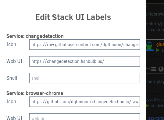

Text is all legible now, thanks!
[Plugin] Docker Compose Manager
No. Do you want a list of the plugins I do have installed?

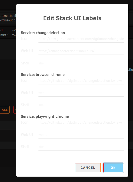

6.11.0 release. Tried resetting Firefox theme in case it might be interfering - no change. Behaves the same for me in Edge. Just tried changing Unraid themes - "Gray" renders the same popup this way: Solves legibility for me. Unfortunately I also hate the layout of that theme, so would still love to figure this out. (If only Unraid made color scheme and layout separate options...) In experimenting with the different Unraid themes, I thought this seemed strange with the "White" theme: Guessing that Unraid's theming function is not as robust as it could be.

Problem: Pop-up dialogs created by compose.manager don't use unraid webui theme, leading to unreadable text. I use Black color theme. When I go to Edit Stack, the menu displays: Not unusable, but then when I go to UI Labels, it looks like this:

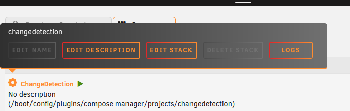

Thanks for making this. While we wait for whatever Docker changes await in 6.10, this is fun to play with. How about adding a Compose Logs button? Also, the plugin allows you to rename a running stack, then can't control it - i.e., you hit Compose Down button and it says no container with the new name is running.
