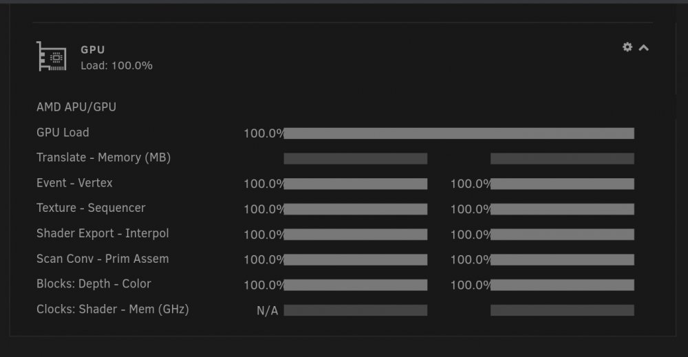

I did also build the kernel with the vendor reset patch. I only really wanted to use RadeonTop for the GPU Statistics as it's nice to have showing on the main screen in the UI. Here's a screenshot of what I'm seeing when the server is idle (GPU definitely not in use as the fans aren't spinning). Strangely, when I spin up a VM, the figures all drop back down and then appear to work correctly when the VM is running/under load.
