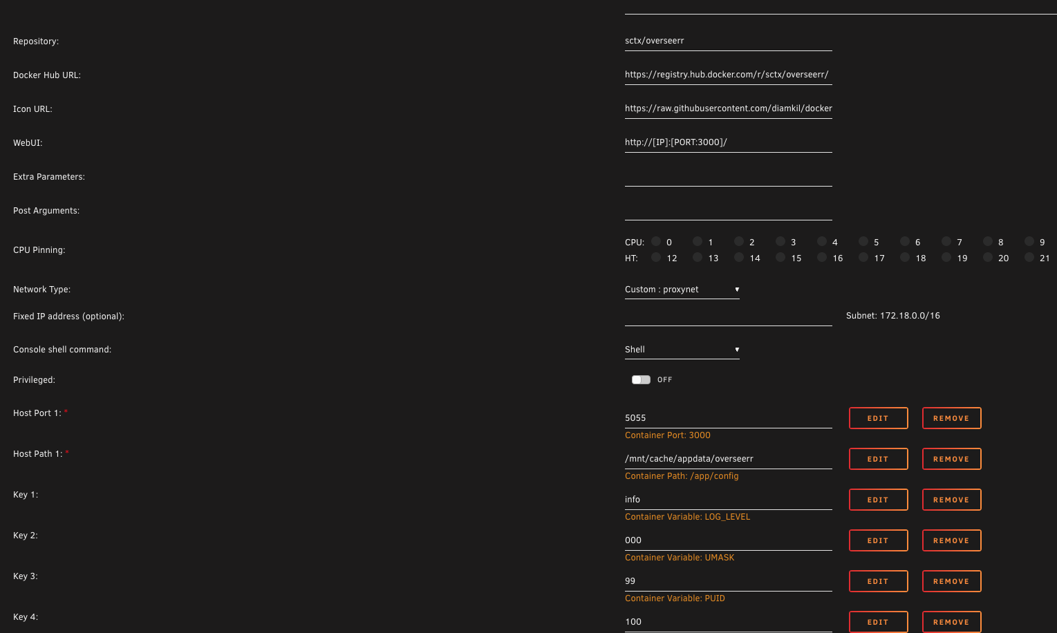

59 minutes ago, progrockusa said:
Anyone know why the app still tries to go to port 3000? Already reinstalled this from scratch, including erasing the app data folder
container settings
click
wrong port
looks like you have some incorrect settings in your container. they repopulated when you reinstalled because the container template persists even if you remove the appdata folder (templates can be removed by going to the docker tab -> add container -> select template to delete -> press red x to delete). I think if you'll just fix/change your ports it should solve your issue.
Here's pictures of my current working and proxied setup for anyone that might find it helpful. WebUI port can be changed by clicking "advanced view" in the top right of the container settings page.
container settings
click
wrong port
Can you try removing the container (and deleting the image) then fully restarting unraid?
Hey sorry, I got it working had to remove the template

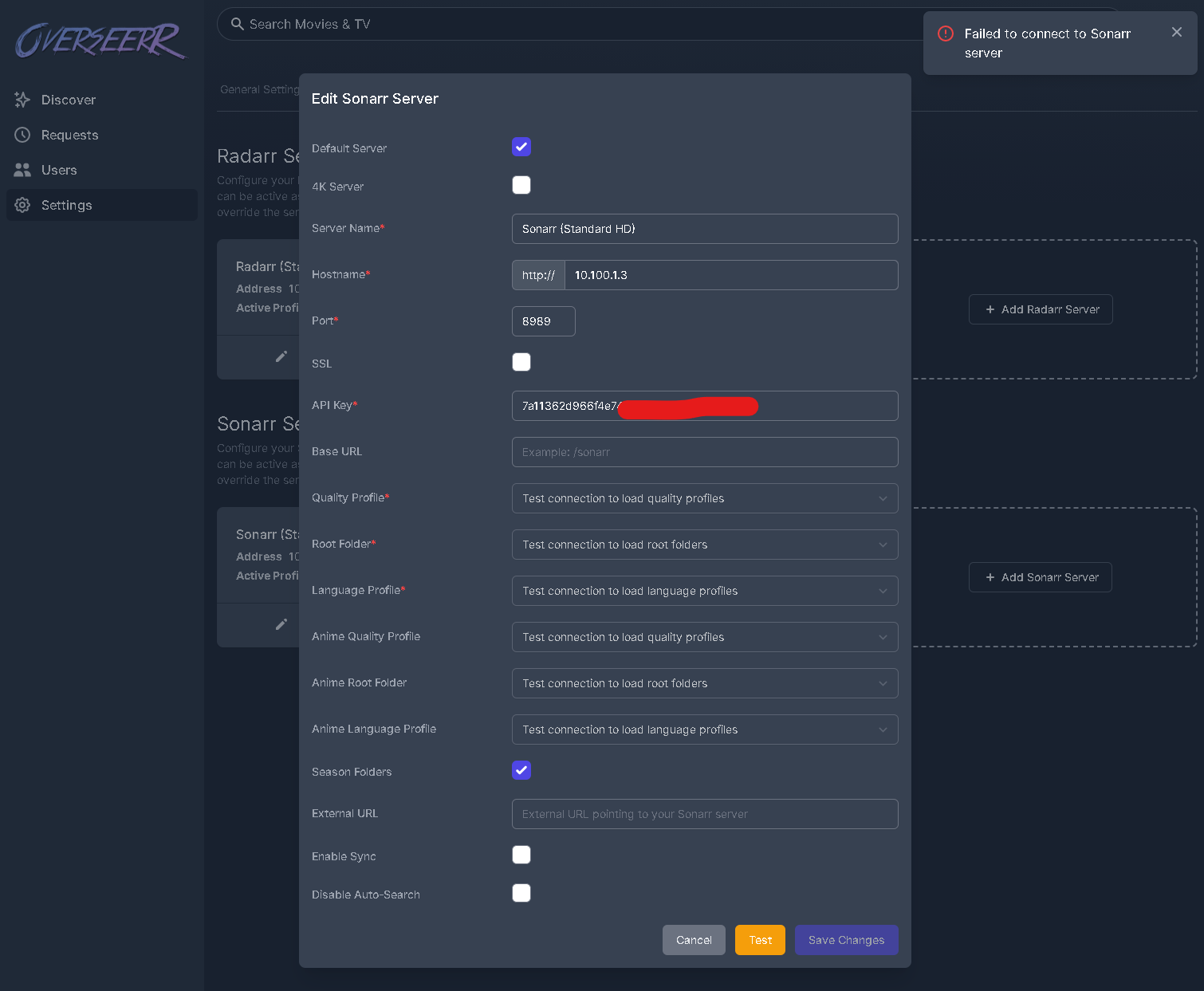

Is anyone else having issues getting Overseer to connect with Sonarr recently?
I don't get as much use out of Overseerr as I would like. So, I haven't noticed it until today, as I was having issues with the recent update to DelugeVPN, and I decided to go through and check to make sure all is well with the rest of my dockers.
When I try to connect to Sonarr in Overserr, it just says it can't connect. However, I can connect to Radarr (same IP/port 7878) just fine. I thought it may have been because I enabled the login page, but I disabled it, restarted and it didn't work. I made sure my API key matches, and even tried generating a new one and restarting Sonarr, but still no luck. Restarted Overseerr and Sonarr multiple times. Anything else I should try before deleting Overseer and starting over (really don't want to lol)?
Unraid server IP: 10.100.1.3
Overseerr:
Sonarr:
EDIT: Adding Overseer logs:

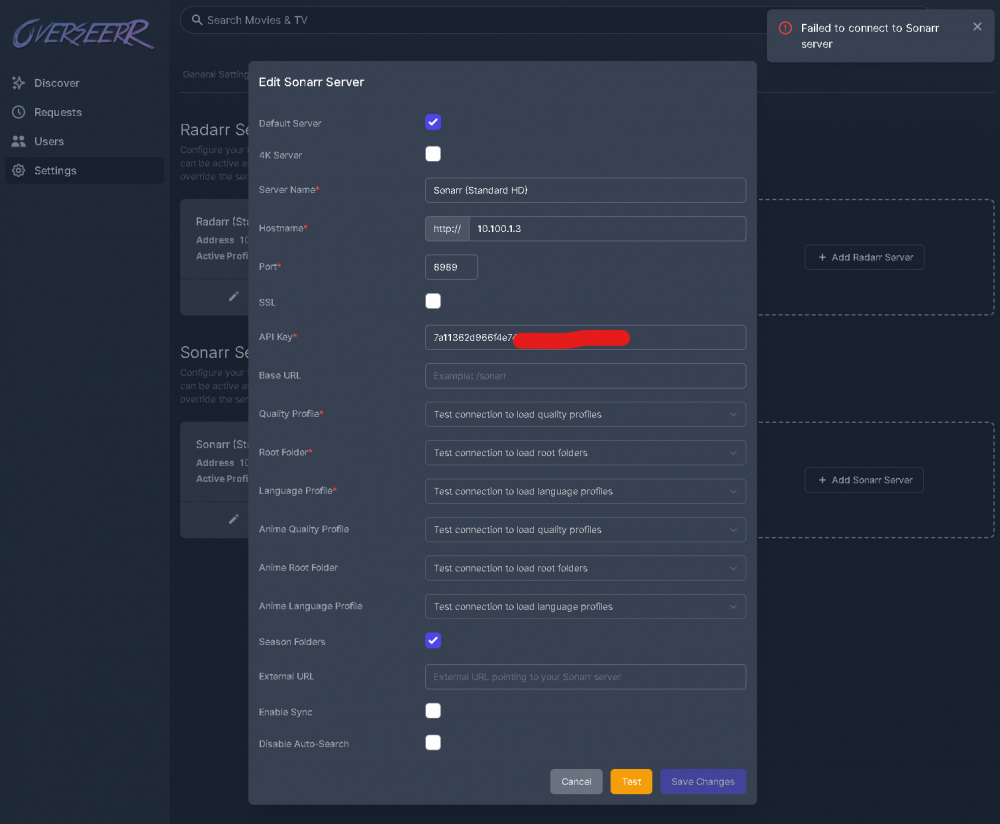

Overseerr:
Sonarr:

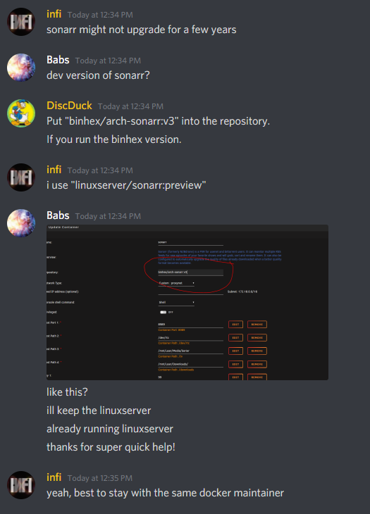

So the issue is with Sonarr version you need to update i was running BinHex and had to add :v3 to the repo and now working.
@binhex Any chance you can update the old repo ?
v3 is still not 'latest' release, its still marked as beta, and until this changes im afraid it will stay tagged as v3, as soon as it gets tagged as 'latest release' then i will merge the change from v3 branch to master and latest will then be v3, make sense?.
Yes it does! very helpful info thank you for your support and all you hard work

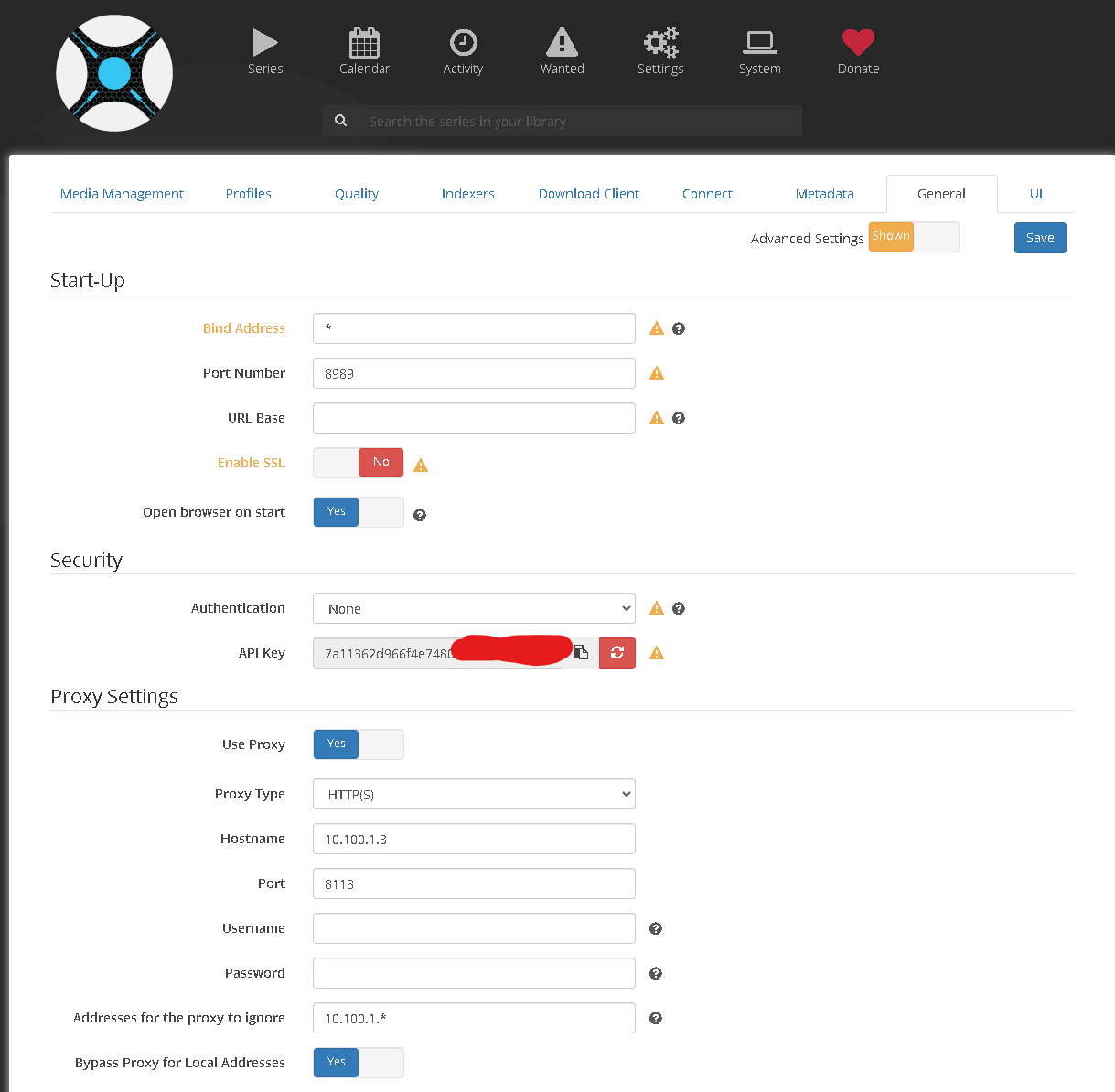

Go into sonarr and radarr, general under settings.
Under ignored addresses. Put your local IP example
192.168.1.*
Should fix it with binhex-deluge

In case it helps anyone...my problem above was solved by NOT using HOST ip  config for the docker. My RADARR and SONARR are hosted by UNRAID dockers, so I don't think they can talk to each other in host mode. Might be good to change this on the docker install? Maybe I'm doing something wrong..lol
Set a custom bridge IP and perfecto. I'm really curious how it worked in the first place...but whatever.
Edited by dja
Is anyone having trouble with setting up email notifications? For some reason the same settings that work perfectly in Ombi don't work here at all. I never get the test email.
