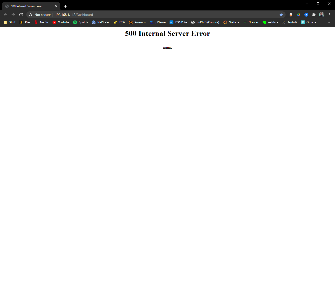

January 5, 20215 yr Hi Everyone, for some reason I can't seem to access the webGUI. I took a look at a few threads with the same issue and tried some of the solutions, but nothing worked or isn't applicable. I'm currently doing a pre-clear of two drives and a parity check. I'm able to access the machine via SSH and things seem to be working... All docker apps seem to be working just fine and are reachable via their respective webGUIs. That being said, I've attached my diagnostics file to see if anyone can help figure out what's wrong. I'll keep it up until the parity check finishes and I'll do a reboot to see if that resolves the issue. By the way, is "powerdown -r" the right way to gracefully shutdown? cosmos-diagnostics-20210106-0037.zip Edited January 5, 20215 yr by jbquintal added pictures

January 5, 20215 yr Author I rebooted the server as soon as my parity check finished. I'm able to access the WebGUI now. I'll update this post if it acts up again.
August 15, 20224 yr I'm not sure why this was so difficult to find or answer but here is how to correct the error without restating the machine. From the console, log in to the terminal using the Root account. Once logged in type the following command: /etc/rc.d/rc.php-fpm restart Done. You can now log back in via WebUI. Other useful Unraid commands can be found here: https://selfhosters.net/commands/
