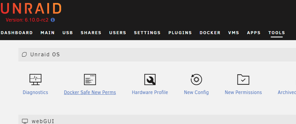

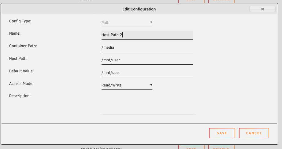

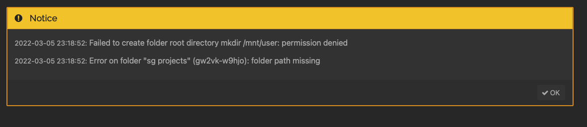

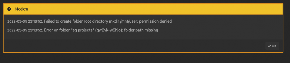

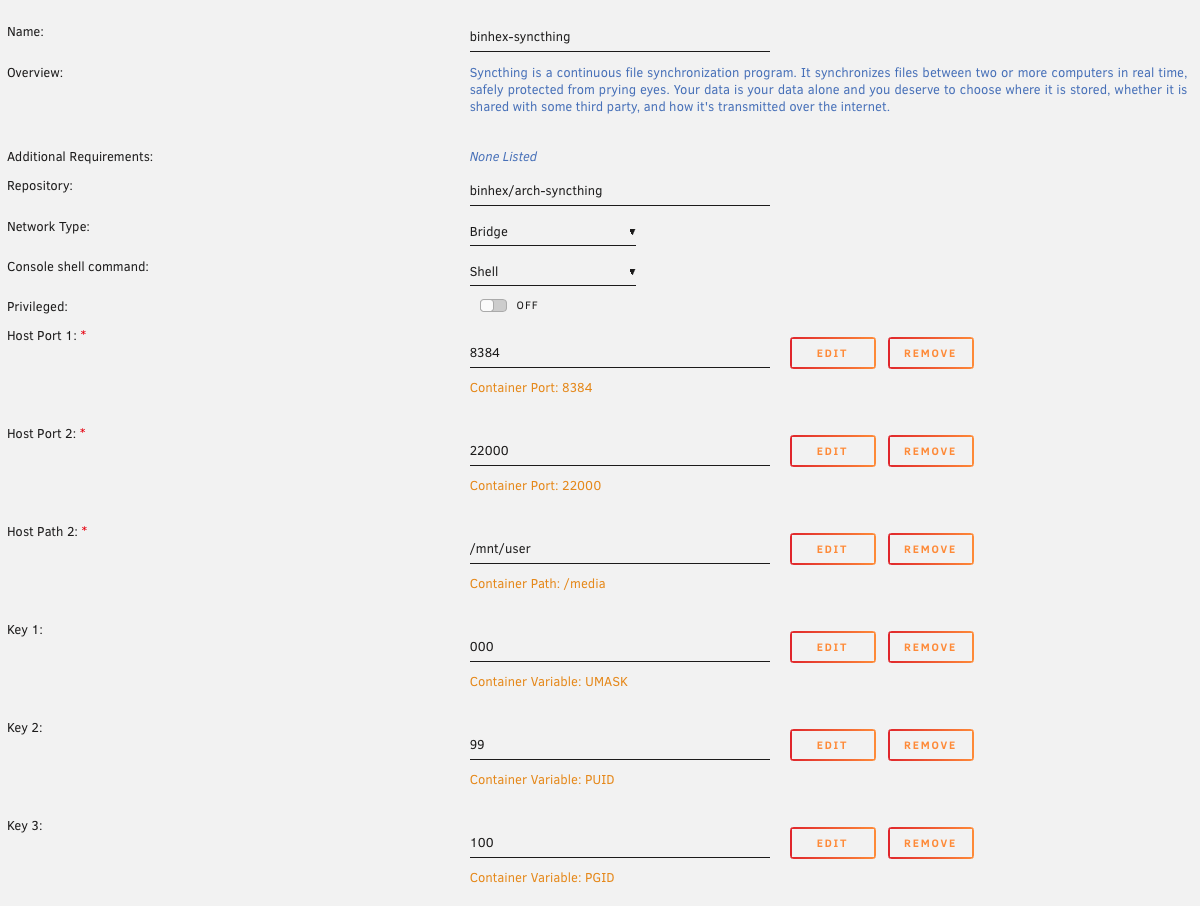

I am stumped at the same point:
2022-03-05 22:56:33: Failed to create folder root directory mkdir /mnt/user: permission denied
2022-03-05 22:56:33: Error on folder "sg projects" (xseqs-rkkhk): folder path missing
I am running unraid 6.10.0-rc2 and under tools I do not have Docker Safe Perms icon - should it be there?
Also the folder I am trying to sync is one of my samba shares.
The Docker is a new install and the config is the default setup.
But any samba share folder has the same error:
What am I missing?

What have you set the paths to in web UI of syncthing, it should be referencing /media not /mnt/user
Sent from my CLT-L09 using Tapatalk
Thank you binhex
Yes I was using   /mnt/user/sg projects   as the folder path in the Syncthing web interface (webpage)
So installing the docker again (just in case) and leaving all the docker setting at they default.
Create a new folder in the Syncthing web interface using    /media/sg projects   and the syncing work with all my user shares!
Thanks again.

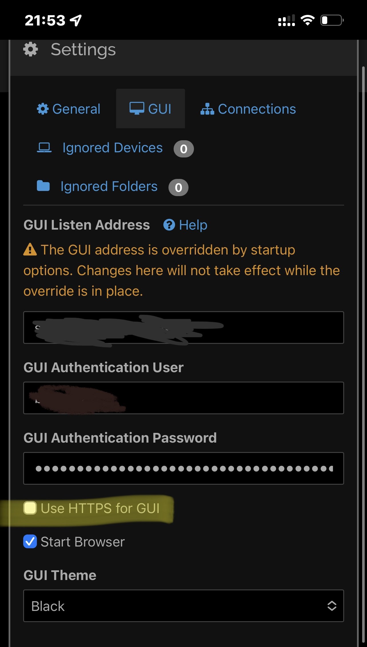

Pardon my idiocracy: trying to enable option highlighted in attached pictures. Everytime I enable this I can’t access Syncthing on network outside of my Home. How do I point this towards SSL certs that Swag writes already?
Edited by blaine07
Dummie me
you might be better off asking this on the SWAG support thread as no doubt somebody has already done this (i dont use SWAG).

Thanks for creating this unraid template @binhex.
Anyone having issues with the https redirect using this template?
If I enable "Use Https for GUI", it doesn't seem to redirect to https as it should.
This works perfectly with my non-Unraid installs of Syncthing.
On my 2 unraid servers it just goes to the http gui and does not redirect.

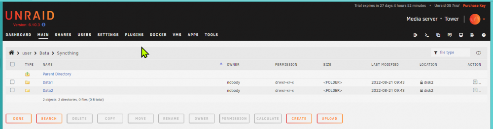

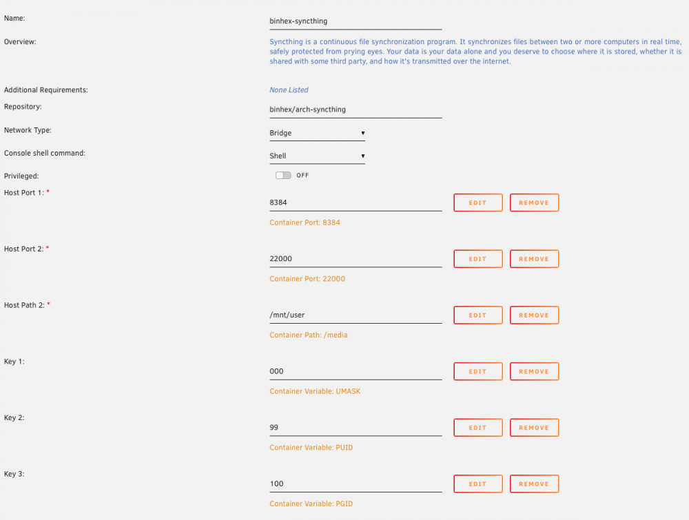

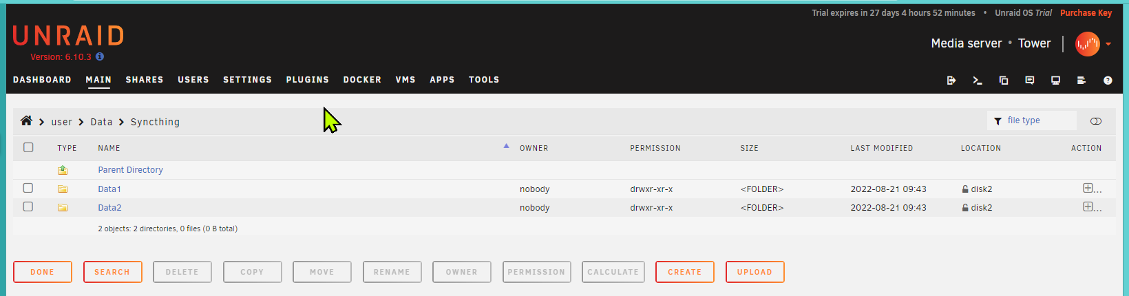

I test your Docker but i don't see where data store on my Disk....
Folder patch:
Mappings:
Nothing on patch: /mnt/user/Data/Syncthing/
But Sync still running with very low IO data transfer??? It write to docker.img??
Edited by meomapvn
Add more detail.
