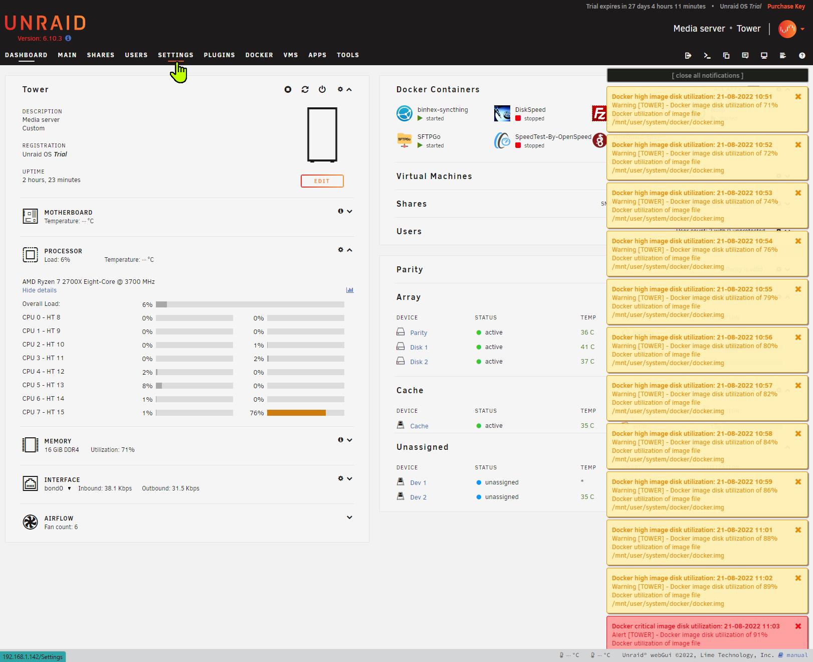

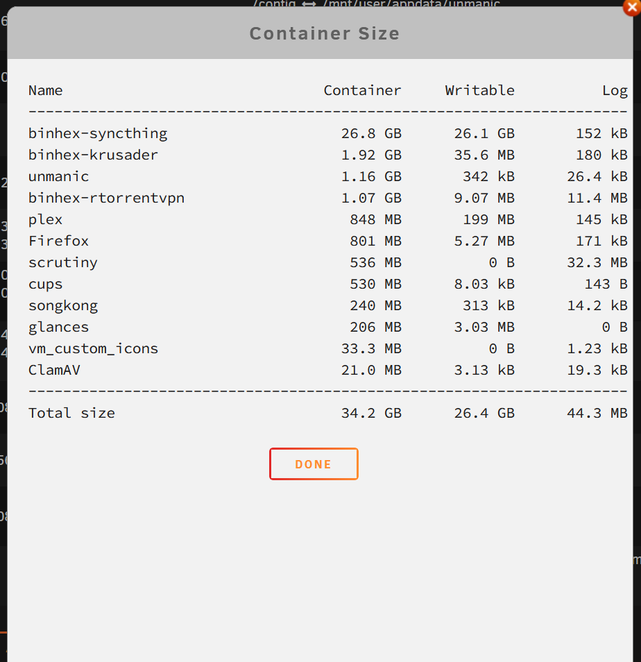

I did the same mistake and now even ive change the Path and my Syncthing are working correctly my Syncthing container claim 70% of the Docker. Can you help how can i reclaim the docker image size?
simple, left click syncthing, edit something, edit it back to what it was, scroll to the bottom and click on apply, this will delete the container freeing up space.
Thank Binhex just simple as that. it resolve the issue.

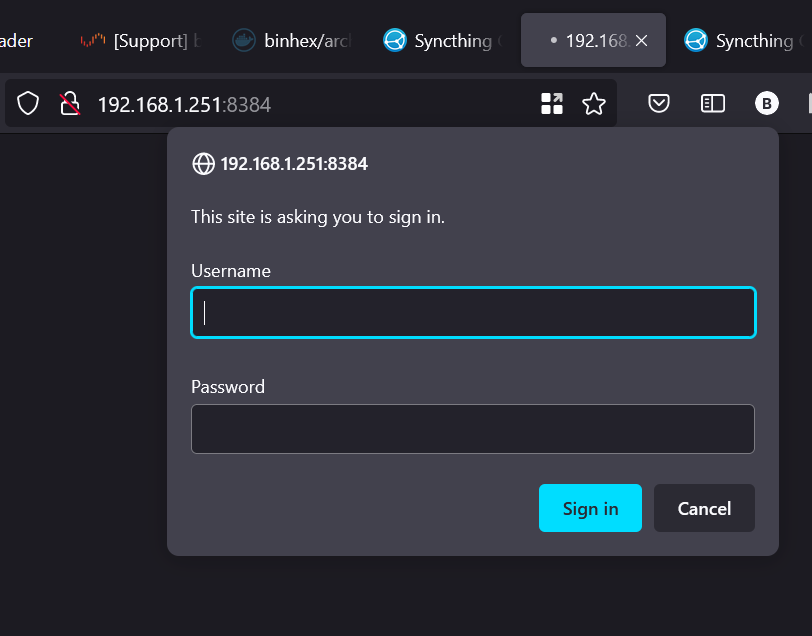

Hi all, thank you for creating and supporting this app. I'm still learning, so please bear with me because this sounds like an utterly stupid question.
I installed the binhex syncthing UI in Unraid. When I go to the Web UI URL, it asks for credentials. I can't find anything about default credentials, canceling out doesn't work, and my Unraid user credentials don't work either. Is there a default username and password?
I'm sure there is something basic I'm missing but any help is appreciated.
nope there isnt so im at a loss as to what the credentials could be!. in any case you can get around this by shutting down the container and then editing the following file using notepad++ (not notepad!):-

delete the values for <user> and <password> so that it ends up looking like this:-
    <gui enabled="true" tls="false" debugging="false">
        <address>127.0.0.1:8384</address>
        <user></user>
        <password></password>
        <apikey>Yv9cStziiWXz3TNRRbqSQbqazQe575Xn</apikey>
        <theme>default</theme>
    </gui>
save the file, then start the container.

Thank you! That did the trick. Appreciate the quick response and idiot-proof instructions.
