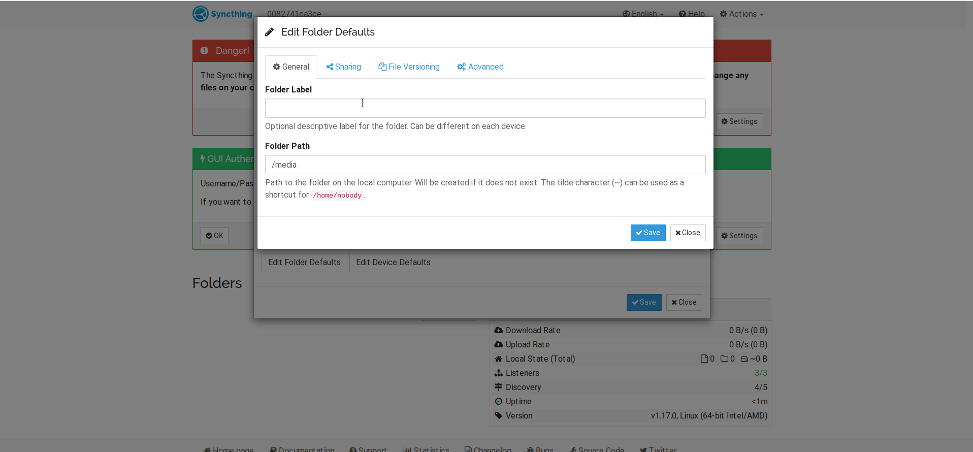

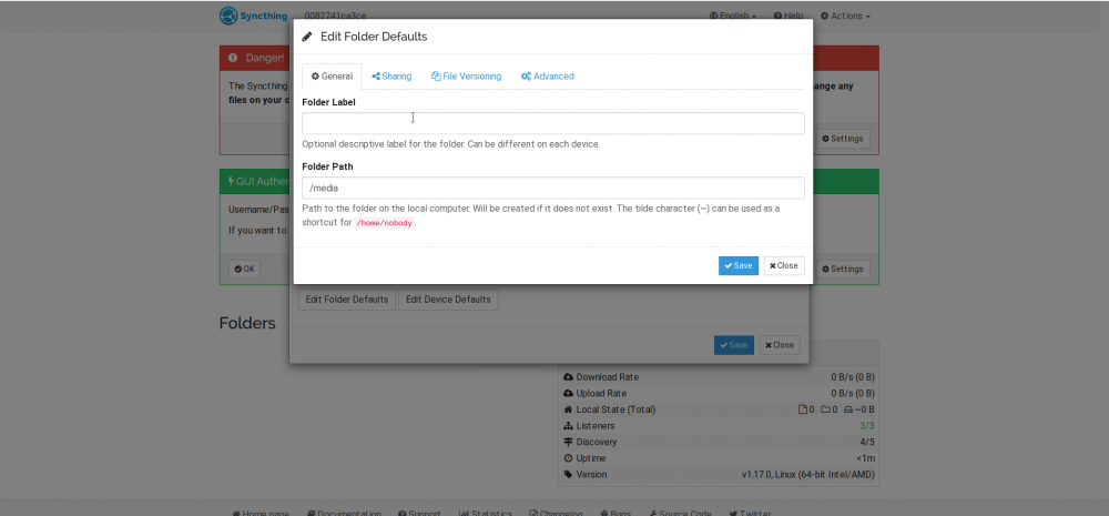

  • Nothing wrong with your container but if you use the default path in syncthing itself for adding folders to it will be at '~' AKA '/home/nobody' and will save the data into the container image and fil

E.g. you create the /mnt/user/media/Sync/Daniel folder on unraid, you give /mnt/user/media/Sync as the map to /media in the template, and then in give select /media/Daniel as location for the sync.
On 6/15/2021 at 10:42 PM, salotz said:
Nothing wrong with your container but if you use the default path in syncthing itself for adding folders to it will be at '~' AKA '/home/nobody' and will save the data into the container image and fill up the docker.img really quickly. I suggest changing the defaults such that the default path's line up with the mount to the host FS (whether that is making the default be `/home/nobody` instead of `/media` or changing the syncthing config). I in the end not a big deal to someone who knows what they are doing, but did take me some time to figure out as I was hoping defaults would have sane behavior and I wouldn't have to fiddle.
Thanks for making this :)
For newbs that are trying to get this to work, run the docker with default settings then change this in syncthing and make sure if you manually specify patsh you use something that starts with `/media`.
This is 100% my issue. the home/nobody shouldn't even be a thing with /media set up properly in the docker config. I had my host set to user/syncthing and left /media alone for docker path. then my docker image file ballooned to 100% in 10 minutes. Thank you for posting this. this is with Binhex-Syncthing as of 2/16/23.

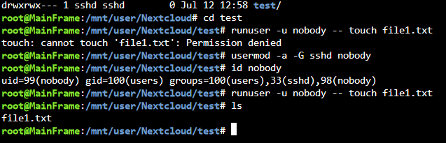

Unfortunately, I have a problem with the access rights to individual folders. Some folders are created and edited under the user sshd. With this folder I get the error message "permission denied". The container gets the PUID GUID from the user nobody i.e. 99:100. So I thought to work around the problem I add the group of sshd to the user nobody. The folders have read and write permissions for members of the group (rwxrwx---). If I try to create or delete a file in the corresponding folder via the UnRaid cli with, for example, "runuser -u nobody -- touch file1.txt", it also works, but it doesn't seem to work in the container. Is there any other reason why this error can appear? If I start the container with PUID:GUID 0:0, it can access everything as expected... However, this is not a good idea, as we know. Does anyone have a tip for me?
Thanks in advance.
Thanks in advance.
Which folders are we talking about here? Give the full path
Sent from my 22021211RG using Tapatalk
It's the Nextcloud Data Share located here:
/mnt/user/Nextcloud
/mnt/user/Nextcloud
and i assume you have a NextCloud docker container right?, if so it will be that container that is generating files/folders with user/group sshd not syncthing.
Yes that is correct, and i want Syncthing to take these files/folders and put them on my other syncthing machine. The folders are setup as "send only". And it's on the sending machine which i have the permission problem.
Edited by Orkopaede
ok then you either need to set the nextcloud docker container to run as user 'nobody' group 'users', or switch this container to run as the same user and group as defined for your nextcloud container (sshd), you need to set consistent permissions for both containers if you need to access files/folders created by either.
Ok, I'll try that. I really hoped that if I gave the user nobody the group sshd he would be able to access it too. I also just saw that the Nextcloud folder belongs to the user group. However, the user nobody also has the group user.
Is there an easy answer why it's not working like that? I mean that's the hole point why it shouldn't run with root account. Right?
I did a short test again to check if I understood the topic of access rights correctly. I took the sshd group away from nobody and then tested the following and it works as expected.
Okay, I found it... I looked at the group membership of nobody in the cli of the Syncthing container, which of course did not have group 33 (sshd/http). Where should he get that from......  I think the easiest thing would probably have been to assign the folders to the 100 users group. But well, I've learned something again. In any case, thanks a lot for your help.

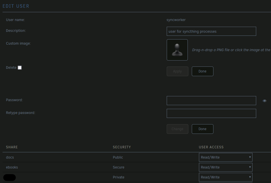

I'm having some issues starting the container. It seems that either there are some permissions problems with the start script, because if I set the PUID to 0 (root) the container starts correctly or I need to configure the user for this container differently.image.thumb.png.59071bf0b778152e1278a265cc4e1f36.png
This is the user info: image.png.47e69e059a8210d121ff1175f30b8516.png
The rest of the container config is all the defaults. Though I did add a mappings to subfolders of
/mnt/user
The user has read/write access to the relevant foldersimage.png.ca044c5cb891135df801c79918164018.png
and the appdata share as well.
I'm a bit stumped on what could be the problem.
Thanks!
Edited by DarkInspiration
typos and grammar
These permissions only apply to network access, not local.
You need to check the permissions of the actual folders/files on the filesystem.
There isn't much reason to make a user if it's not going to do network accesses and it'd be simpler to run as the default nobody:users (99:100).

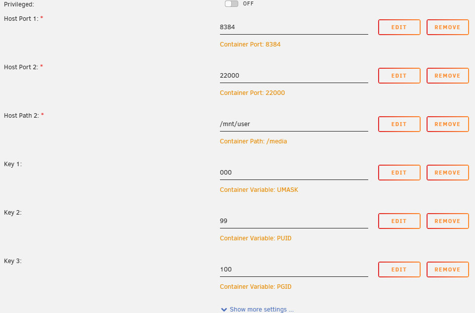

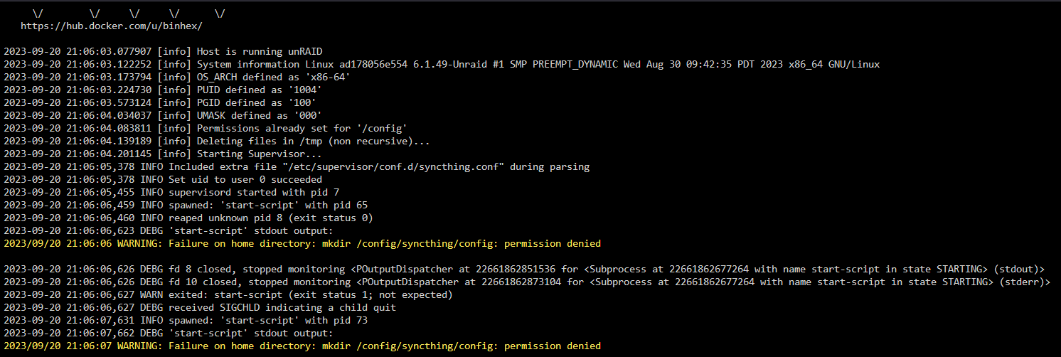

hi i have been trying to fix this permission issue with syncthing not being able to change the default folder at all, and freely create folders as well, i was wondering if you know any tips or advice that could help me resolve with this issue, that would be appreciated,
syncthing logs.txt
ps i have left the container settings as default for now
Edited by mr_syd20
Post your container settings, but you would typically NOT have /mnt/user in the container, that's a host path that's mapped to something else in the container.
Syncthing has stopped working for me. I'm trying to add a folder path: `/media/Backup/test_me`
Syncthing creates a test_me folder in my Backup share
But then it apparently can't create `.stfolder` because I immediately get the Folder Marker Missing error.
Here's my config:
Edited by RichardU
This solved my problem, only in unRAID folder sync did I activate the "ignore permissions" option.
