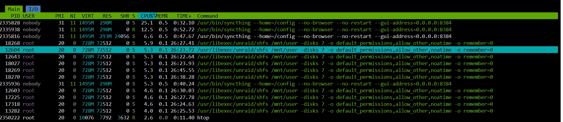

Having my first issue with Syncthing(v2.0.6) on UNRAID 7.1.4. It is useing a lot of cpu resources while seemingly doing nothing. Syncthing is not scanning, transferring data and I dont use "watch for changes". In the past it would us 0% cpu and just site at idle. Now I can pause all folders and remote devices(another UNRAID server with the same specs) and I still get this unless I stop the docker. I have reverted back to older versions of syncthing and nothing has worked. I need some help, Thanks.
Same here, Since the update and database conversion, my idle cpu usage increased about 5% give or take and one of my syncing folders was not always scanning to 100% completion, and sometimes needed the syncthing docker to restart to finish that folders scanning. I thought it was unrelated to my idle high cpu usage.
However I removed that folder and readded it to syncthing , let it scan back in and once complete the cpu usage was back to my nominal usage.
This suggests to me a corrupt / damaged database when it converted one or two updates ago, and was somehow linked to my cpu usage.
So I would suggest removing and readding syncing folders and see if that works for you too, I was lucky as i had a obvious faulty folder share to try first, my other 5 shared folders appeared to be fine. hope that helps
Thank you, that worked! I actually had a folder that I was not syncing at the moment and it was paused and it did not have a destination folder on the other end. This was my problem, deleted the folder and all is good. Funny thing is I have had the folder there for a good while through many updates and it was never an issue. Anyway thanks again
