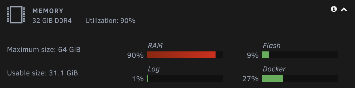

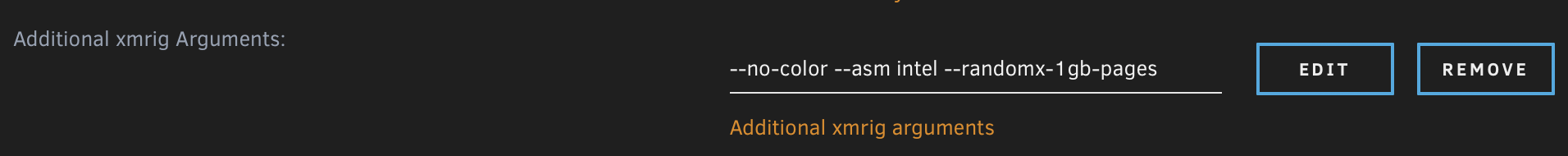

What am I doing wrong... In log
* HUGE PAGES supported
* 1GB PAGES supported
randomx failed to allocate RandomX dataset using 1GB pages
Settings
--no-color --asm intel --randomx-1gb-pages
Running privileged
Near the top of the log it should show a line that looks like this:
* MEMORY 12.1/31.1 GB (38%)
What does yours say? The container likely reports that you have a higher RAM usage than you actually do.
I'm currently researching a similar issue for @SPOautos.  If you don't mind posting your diagnostics.zip it might help me find the cause a bit quicker 🙃
Edited by lnxd
* ABOUT XMRig/6.10.0 gcc/9.3.0
* LIBS libuv/1.34.2 OpenSSL/1.1.1f hwloc/2.1.0
* CPU Intel(R) Core(TM) i3-8100 CPU @ 3.60GHz (1) 64-bit AES
L2:1.0 MB L3:6.0 MB 4C/4T NUMA:1
* MEMORY 11.2/15.5 GB (72%)
Without XMrig running, i'm only at 15% ram utilization
So yeah.. something wrong
Edited by G Speed
Can you please stop xmrig and post the output of:
free -m
And also show me a screenshot of your RAM usage from the dashboard:
688459108_ScreenShot2021-04-09at8_18_40am.thumb.png.095528375574ca311980c4aedf5fa8e5.png
Also, please start the container again and post the output of this if there's nothing in there you don't want to share on the forum:
top -n 1 -o %MEM
What you just posted shows that the container can see 1 NUMA node, so the RAM requirement for 1GB Huge Pages on your host would be 3GB * 1 = 3GB, and you don't have enough RAM available to the container when it is launching. So there's something else that's unexpectedly being allocated RAM and preventing XMrig from being able to access it, I'm guessing it's QEMU but I'll await your response 🙂
If you think XMRig is using more RAM than it should, you can add eg. --memory=4g to Advanced > Extra Parameters on the Edit screen to limit it to eg. 4gb like so:
free -m
top -n 1 -o %MEM
What you just posted shows that your CPU has one NUMA node, so the RAM requirement for 1GB Huge Pages on your host would be 3GB * 1 = 3GB, and you don't have enough RAM available to the container when it is launching. So there's something else that's unexpectedly being allocated RAM and preventing XMrig from being able to access it, I'm guessing it's QEMU but I'll await your response 🙂 If you think XMRig is using more RAM than it should, you can add eg. --memory=4g to Advanced > Extra Parameters on the Edit screen to limit it to 4gb like so:
1539471591_ScreenShot2021-04-09at10_41_29am.thumb.png.97fc90f9d5c6e81bccf8ee6c7b07578d.png
Probably not, it's much more profitable to mine Ethereum, it's kind of a waste GPU mining Monero. For GPU, check out PhoenixMiner in my signature, it works with both AMD and Nvidia cards.
At work right now, I will do when I get home, but to answer some of your question
Correct, I have it limited to one numa mode
With xmrig off that screen shot would show 15% usage
In the docker page, when xmrig is running it's using approx 2.Xgb
No worries, and between 2-3gb sounds about right. It's like I said, the dash doesn't report allocated RAM just used RAM, whereas XMRig will report allocated RAM + used RAM. So if the dash shows around 15% before XMRig launches, and XMRig shows 72% when it launches (and is only sitting at around 300mb overhead), there's something unaccounted for that at least one of the above steps should solve.
I'm thinking once you force your host to drop caches XMRig should have a fighting chance. As you noted the other day though, even with your huge pages set to 1gb, we're only talking a 1-3% increase in efficiency / hash rate. You said you have an Intel CPU and you limited it to 1 NUMA node. I'm guessing you have a Xeon/s then? If that's the case, your hash rate will likely benefit more from changing to the latest-root tag so that XMRig can see what hardware you really have and optimise things accordingly.
XMRig reports how much RAM it's using a few lines down from what you shared in the logs, Eg.:
1gb Huge Pages Enabled with 1 NUMA node:
randomx allocated 3072 MB (2080+256) huge pages 100% 3/3 +JIT (144 ms)
1gb Huge Pages Disabled with 1 NUMA node:
randomx allocated 2336 MB (2080+256) huge pages 100% 1168/1168 +JIT (241 ms)
The container will use what it says there + around 300mb.
Edited by lnxd

For those who have dual Intel Xeon E5 2650-3 (or maybe others Xeon CPU too) I remove the first 6 cores and their threads and now I have 5000-5500H/s instead of ~3500H/s or less on anything else I tried:
What I tried = 1 more core/threads plus or minus, all of them, only the first core/thread removed like the OP said, and more.
p.s. I also use the OP script and this as additional arguments:
If that can help anyone 😎

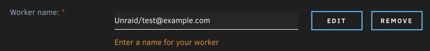

Hi, it's me again :)
How and where do we put our email/password from nanopool?
I just found out that we need that to be configured to change the min/max payout
Hey @Steace!
Yup you sure do. Otherwise it'll be a looooonngg time to payout. Just make sure you note their transaction fee when you're reducing the value.
If you slip it into the worker field it should work, eg. Unraid/[email protected]. Then just let it mine for a while before trying to update the payout threshold on the Nanopool website.
Edited by lnxd

Running xmrig as uid=0(root) gid=0(root) groups=0(root) with the following flags:
--url=stratum.ravenminer.com:3838 --coin=monero --user=REvztdeD9c1Z3Nc2er5gB7Y9ZM4PUqoxUY.Unraid --randomx-wrmsr=-1 --randomx-no-rdmsr --no-color --asm intel --random-1gb-pages
./xmrig: unrecognized option '--random-1gb-pages'
