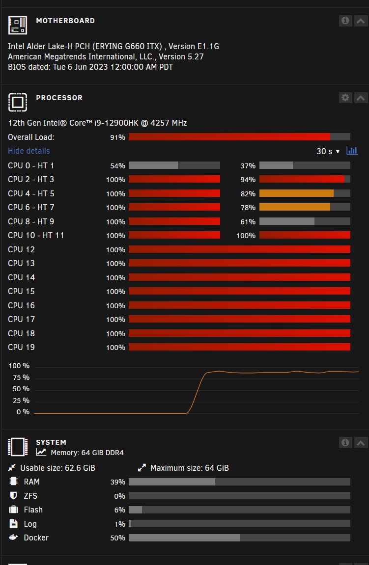

Can anyone look please,
tried xmrig docker on a i9-12900hk (erying board) and got very poor Hash (1700) , used MSR script and got increase to 2200-2500, but my CPU should juice it to 10-13k
my xmrig log is uploaded.
What am i doing wrong?

I fixed the problem after years of encountering. This pre-built image is pulling a very old version of xmrig and numerous enhancements have been made to xmrig's AMD related codebase since.
I ended up cloning the git repo (https://github.com/lnxd/docker-xmrig.git), building xmrig on an equivalent environment to ubuntu:20.04 (because Dockerfile & packaged xmrig build based off it) and changing dev fee from 1 to 0 in src/donate.h, uploading somewhere,  updating the Dockerfile links to that location so it pulls my .tar.gz instead.
Replace command and echo lines in mine.sh to eliminate hard coded msr disabling parameter. I have:
echo "--url=${POOL} --coin=${COIN} --user=${WALLET}.${WORKER} --randomx-no-rdmsr ${ADDITIONAL}"
cd /home/docker/xmrig-${FEE}
./xmrig --url=${POOL} --coin=${COIN} --user=${WALLET}.${WORKER} --randomx-no-rdmsr --donate-level=${DONATE} ${ADDITIONAL}
Additionally, the final piece in the puzzle was using User root instead of User docker near bottom of the Dockerfile, and running as privileged.
Run docker build -t local-docker-xmrig-root .
Remove container + image to avoid caching. Add container, select XMrig in your dropdown, change image to local-docker-xmrig-root:latest
This has entirely finally fixed my hugepages and MSR issues. Happy days!
