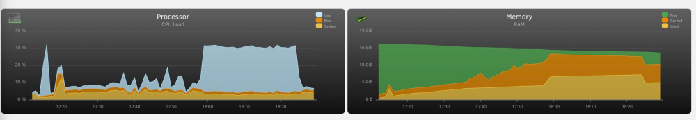

Check out the container logs to get updates, etc. I usually look at the graphs generated by the pool I'm mining to in order to monitor progress as they're way prettier and have come a long way, but you *can* view the docker logs over http / ssh, or access the API directly as @Koldo has provided steps for above.
While the binary is interactive in that you can watch the output and use keyboard commands to exert very basic control over it, as you found it's usually controlled by a config file. This container doesn't rely on that config file though, it uses variables which can be set in the edit container page. Your question was so long ago though that I'm assuming you worked it out shortly after posting.
It is possible and quite easy to get an interactive session from this container and have it running over SSH in terminal. I used it for testing while I was developing this, but it goes slightly against the way docker was integrated into Unraid so I designed the container to rely on the environment variables instead.

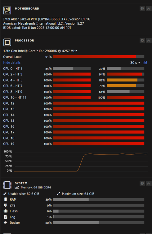

On 12/2/2023 at 3:53 PM, Ystebad said:
can this docker still be used in 2023
It's still contributing to my account, probably not optimized, but seems to work.
