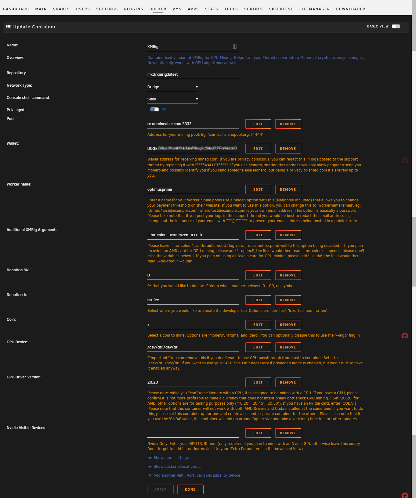

On 4/29/2021 at 4:38 PM, MorphiousGX said:
@miker905How did you get it to work? I pretty much did the same thing as you did, however I can see in the log things are running well, and I see my hash rates. But after 1 hour, still nothing showing up in my results page
Can you please share a screenshot of your config and also your logs, I'm happy to take a look too.
@lnxd Thank you for your help and this as well.
Here is my log for the last few minutes

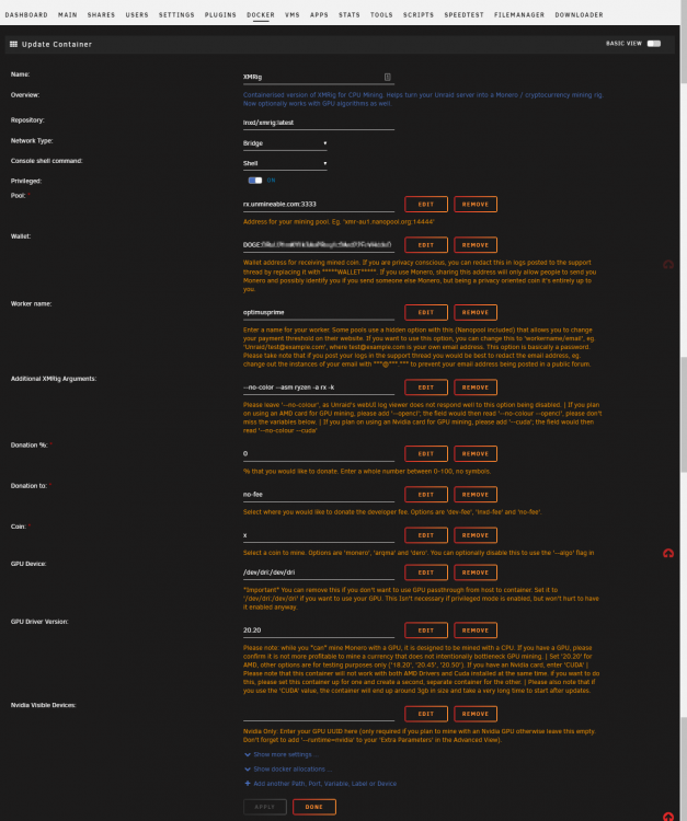

and here is my setup. This is the only way I can get it to work, since you configured the "user" field, I have to put DOGE in front of the Wallet. Unmineable uses the following syntax
xmrig.exe -o rx.unmineable.com:3333 -a rx -k -u DOGE:YourAddress.YourWorkerName
I would have put the -u DOGE:YourAddress.YourWorkerName in the additional arguments field, but I don't think that would work. Your thought and help would be appreciated

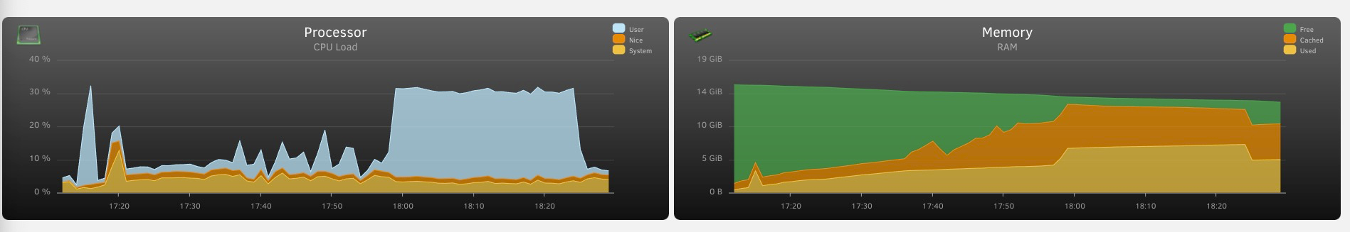

16 gig RAM XEON X3440 (4 cores, 8 HT)
Usually have plenty of CPU/RAM.
The big peak was the pinned XMR task...decided to use only one core/HT leaving other 3 of each free. (No, not CPU 0 :) )
Also, when I go to the Docker tab from the Stats tab...VERY slow to show Docker images. Like, MINUTES to even show the Unraid undulating 'wave'.

Overall it feels like it kinda works but appears to fully load down the machine, and when installs complete, it doesn't say so.
And it's a simple CPU mine, no GPU passthru.
Edited by RealActorRob
I'm thinking I need to allocate more resources to the Container....gotta research that.

Interested in how to optimize my AMD Opteron 8439 SE (x4 six core) system for mining. Only using 8/24 cores. Any thoughts?
LOG
Edited by FuSioN53
Great job on this Docker! Got it up and running easily and getting almost the same hash rate with 1gb pages as i was when mining on this machine with windows.

I just started testing this, i have a ryzen 3700X and i'm selecting 6 cores (12 threats) out of 8 cores, at first got 3.6 kH/s now i changed threats parameter with --threads=12 and got it increased to 5.5 kH/s.
So just posting as it may help someone to increase their hashrate...
