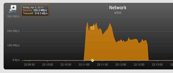

So the issue I am getting is when I copy, or move data around on the server all stars off good I get around 350MB/s write to the server and all looking great. Then about 10GB into the copy it drops off and goes down to around 60MB/s (screenshot below)

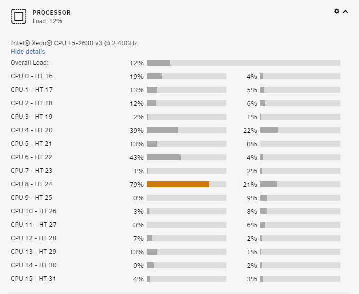

UNRAID shows the CPU usage and while the copy is been done the CPU's are showing around 12% so its not like they are been pinned image.png.9595795437e97bd995d2eb98a26f84f9.png

The CPU's in this server are 2 x Intel(R) Xeon(R) CPU E5-2630 v3 @ 2.40GHz and are both 8 core each - so in how may high end CPU's but more than enough to run what I am doing, and work 100% under a Windows OS and even running a number of VM's in Hyper V with huge data throughput.

With the proper set up you can achieve excellent transfer speeds with Unraid.
I have set up a cache pool using nvme disks and below is an example of a file transfer of 80 GB from my PC to the server over a 10G link.
Speed hovers around 640 MB/s (or 5.1 Gb/s).  Note: to complete the remaining 29.4 GB it needs 60 seconds.
