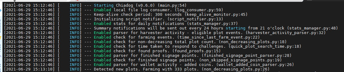

11 hours ago, Helmonder said:
Just saw below in the logs..
It says “added coins” but nothing visible in the dashboard..
The log text does not mean chia was won hopefully ? Cause if so something is wrong..
No, that log line is part of the Chiadog start-up process indicating the log monitor is activating its various checks, one of which is to watch for added coins.  As it occurs at the beginning of every Chiadog launch, this activation of the checking module does not indicate the check was actually triggered by a real event.  Sorry!

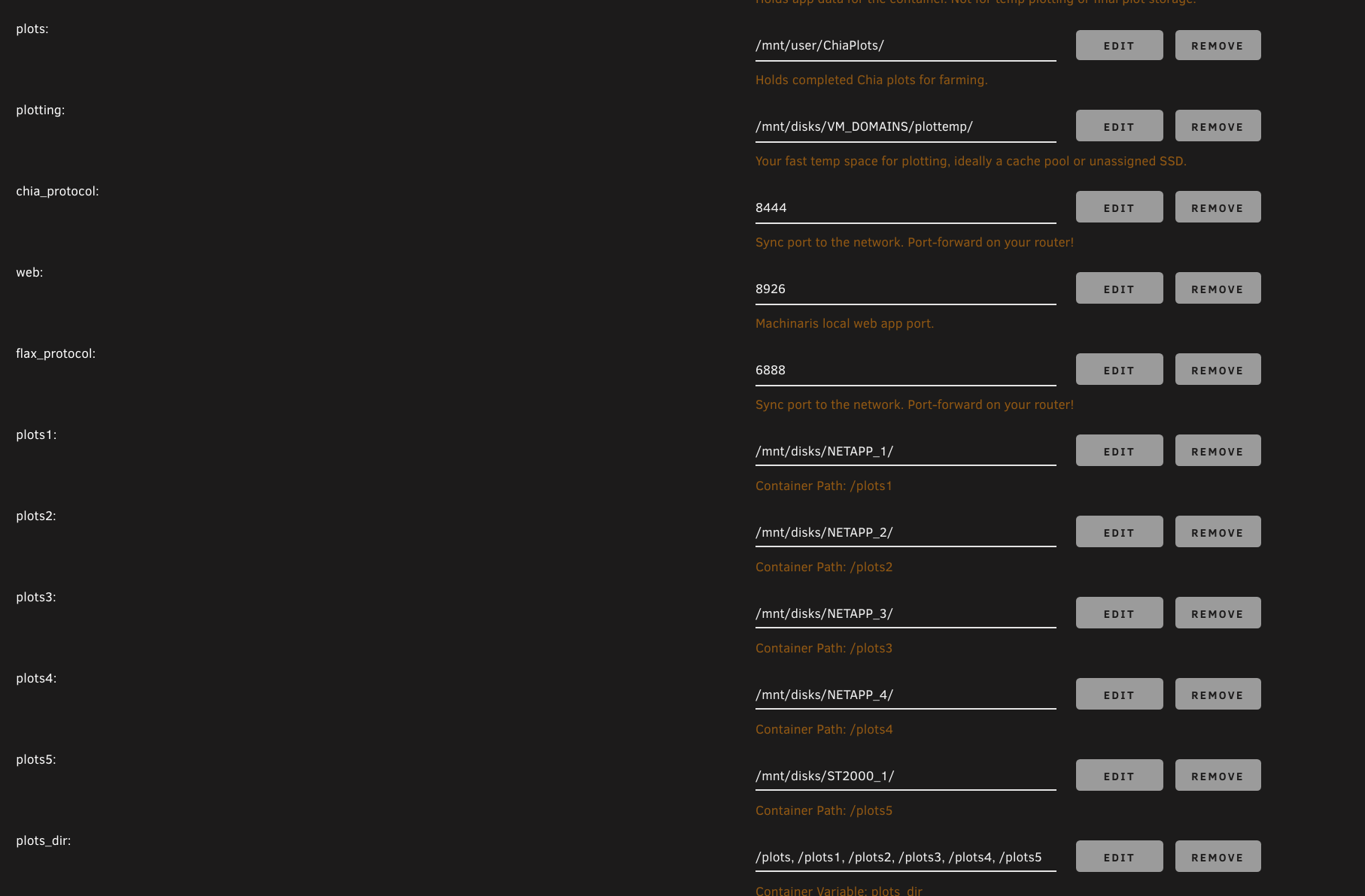

45 minutes ago, Spazhead said:
could someone post their unraid docker setting screen that has multiple plots_dir working.
It's driving me crazy that I can't get mine to work.
Thanks
There you go.

2 minutes ago, Struck said:
There you go.
This should not be nessesary, that is why it is a requirement to set these in the container information like above.
It should automatically get updated.
@SpazheadMaybe you can double check the information in here with your configuration

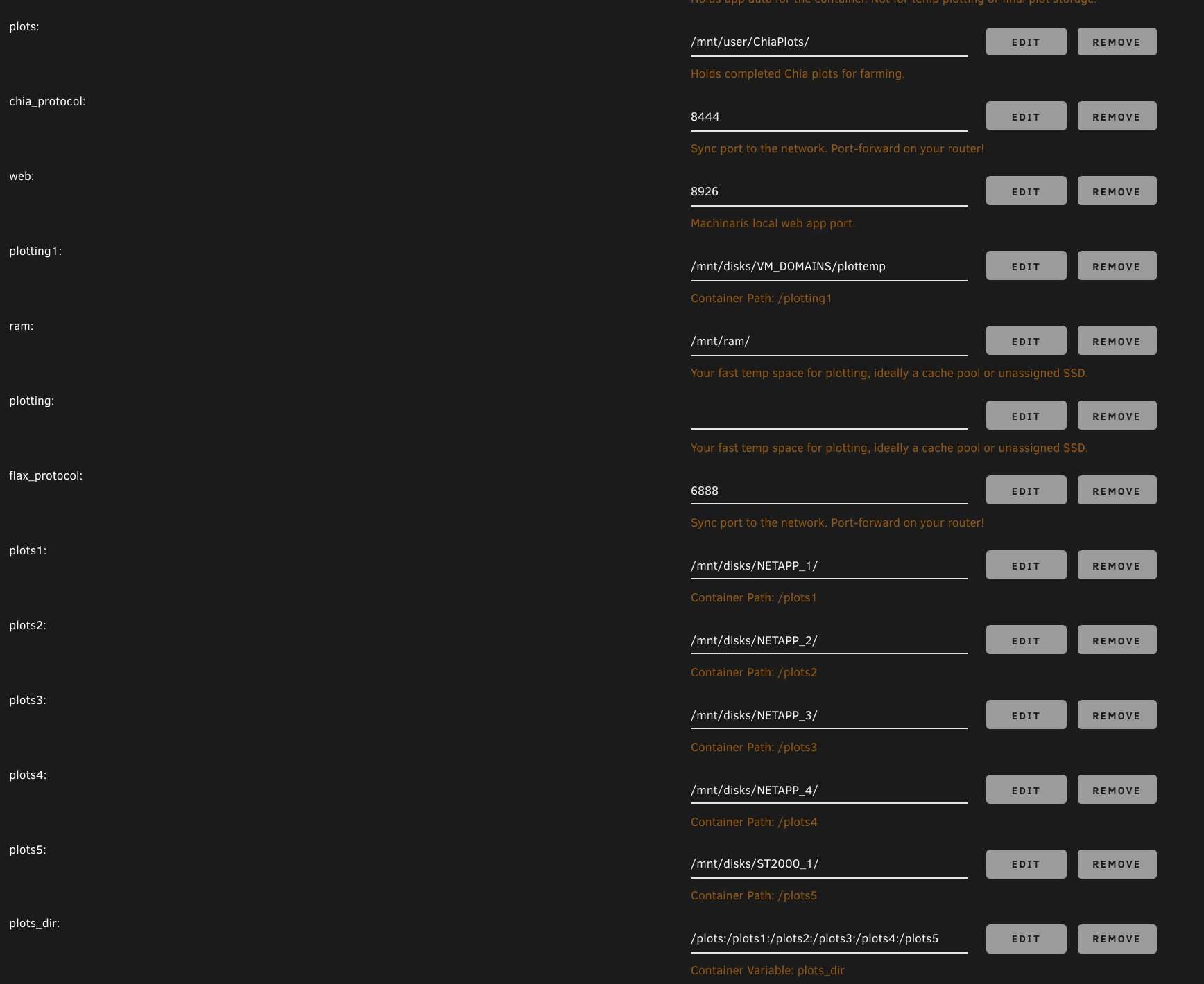

hey there thanks, could you please show me your complete settings, exactly as you have setup, please and thank you!
I have not yet updated to the newest test version. Don't know what changed there.
I am running the 4 days old test version.

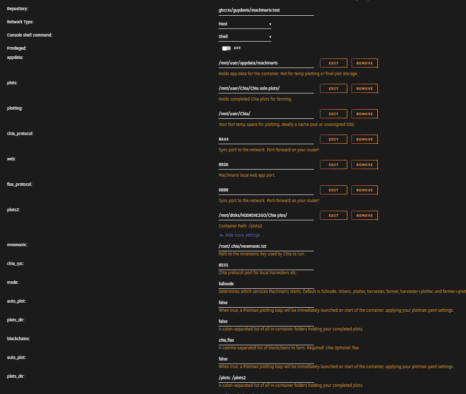

this is what i have, but plots_dir is not working for me
1585646344_ScreenShot2021-07-05at12_25_07PM.thumb.png.aefc1273fe63a2a2a8b139bc1c4cff1c.png
