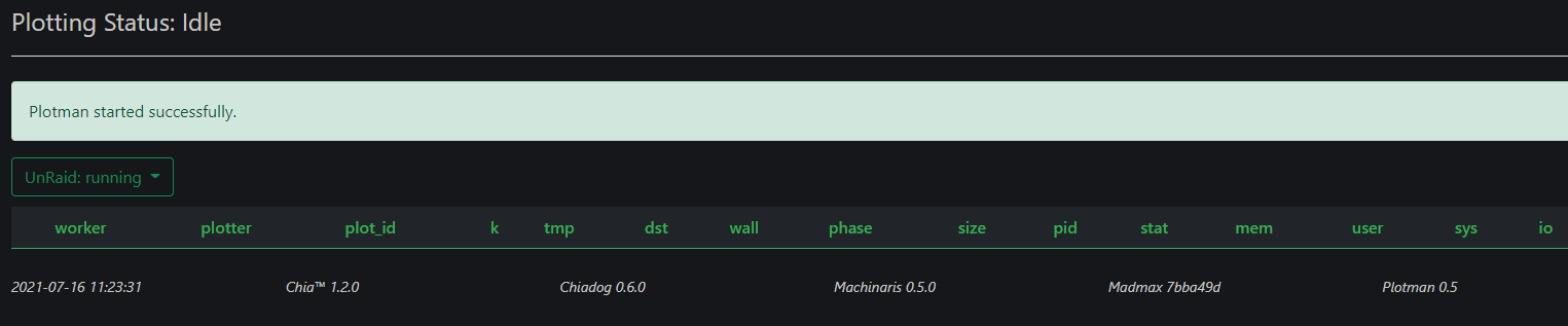

Hello, i have a problem with machinaris. I cant start plots. Other question, how can i start plotting.
Blockchain is synced an i have been connected to the pool.
What i have to change in the plotman.yaml that the plotting is working ?
Thanks
Edited by Phil85
Thanks
Sorry, I am working to improve the user feedback when a plotman.yaml with certain errors is saved. Should be improved in next release.
In the meantime, for case above, please open the Unraid Docker Console for Machinaris and type: plotman status  This command will output the formatting or config problem in the plotman.yaml.  Once the config issue is resolved, then you should be able to start plotting.
Examples to work from:  chia plotter and madmax plotter

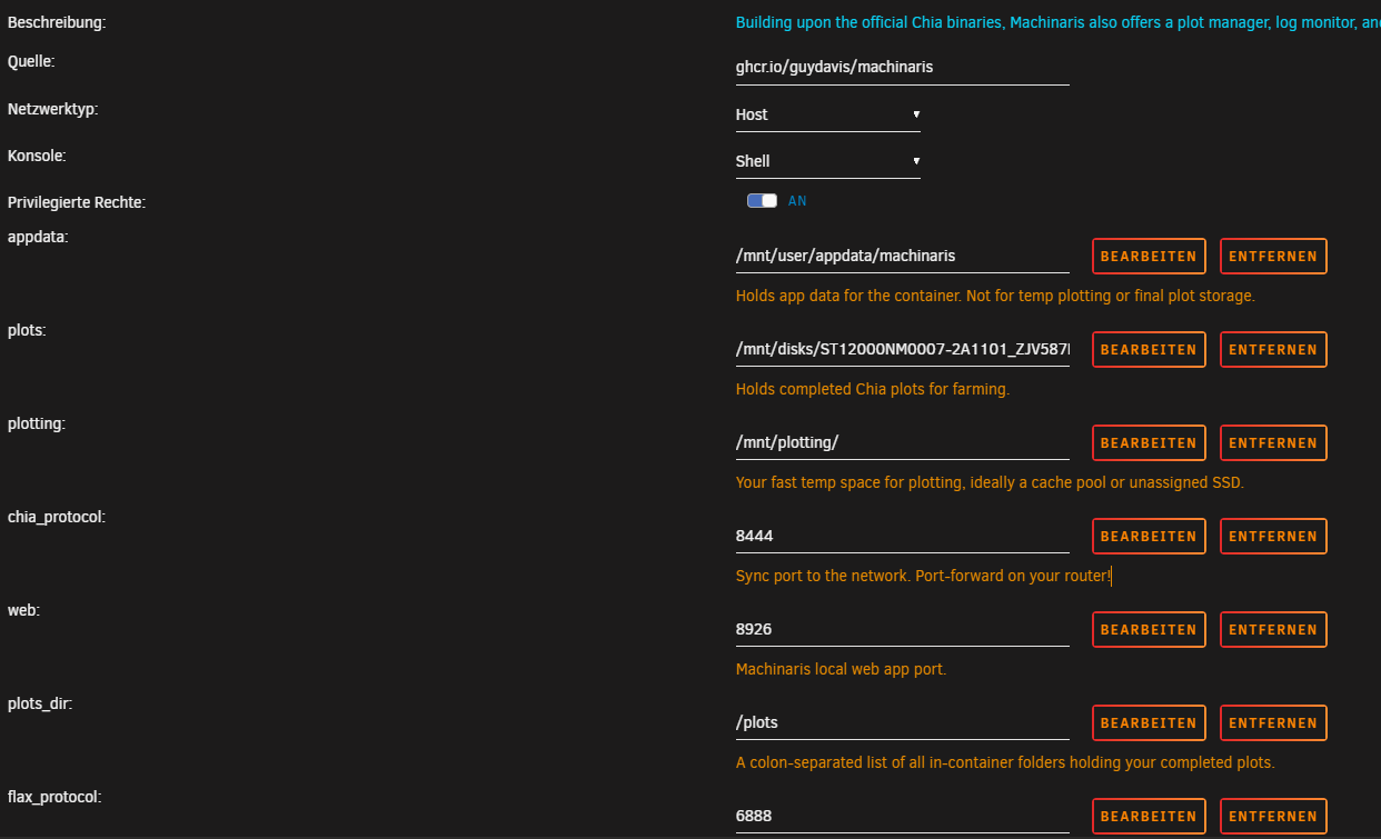

Thanks for your reply ;-)
But the plotman status is nearly blank
# plotman status
plot id   plotter   k   tmp   dst   wall   phase   tmp   pid   stat   mem   user   sys   io
Total jobs: 0
Updated at: Fri Jul 16 20:37:55 2021
The plotman.yaml is configured like the examples chia plotter
And this is the plotting log
...sleeping 20 s: (True, 'Starting plot job: chia plots create -k 32 -r 2 -u 128 -b 3389 -t /plotting -d /plots -f
And this the Unraid config
Edited by Phil85

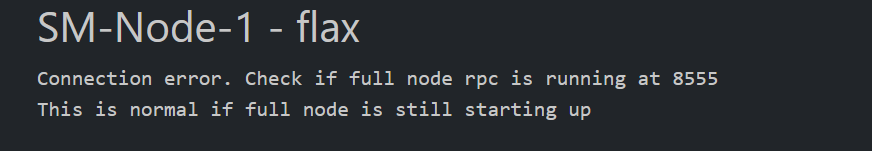

I have recently updated to the latest version and I can see it now includes the option to farm Flax.
However I get below error in the network tab:
I have restarted the container but this does not change anything.

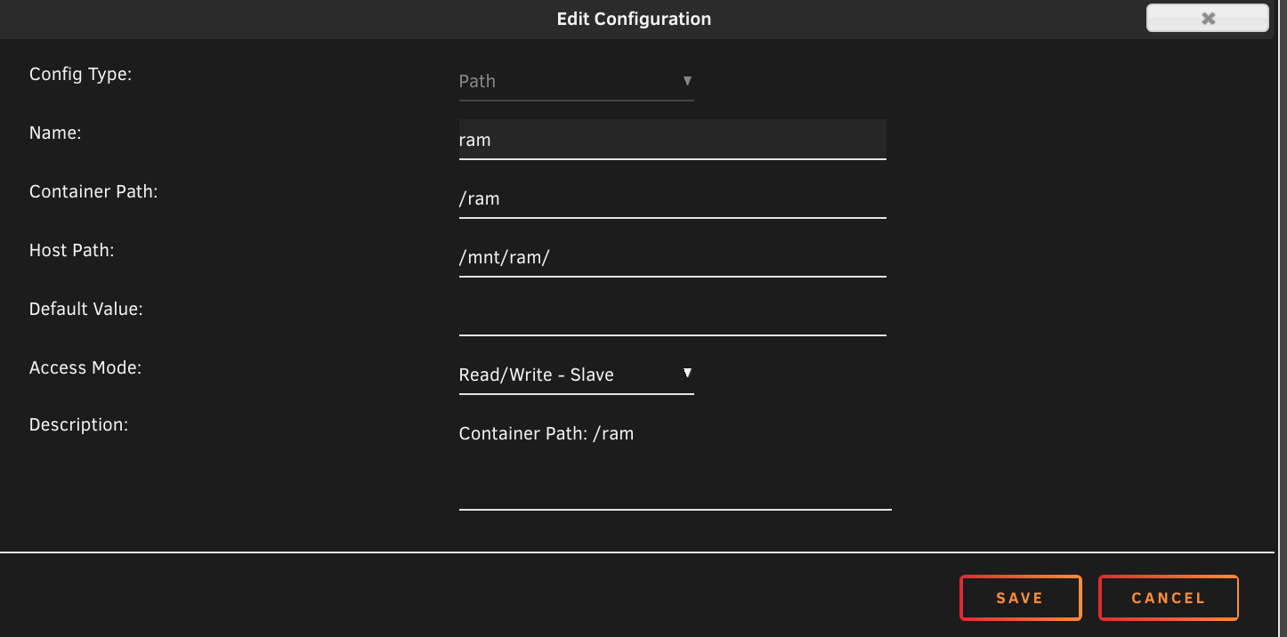

Could someone point me to a thread or guide on how to setup ram disk for this container?
open unriad terminal wondow, type the following
mkdir /mnt/ram
mount -t tmpfs -o size=115G tmpfs /mnt/ram/
add path into your machinaris setup
1695345998_ScreenShot2021-07-17at10_33_59AM.thumb.png.02946a05e0f4573ab4405a1c72ffe6f8.png
inside machinaris plotting config
