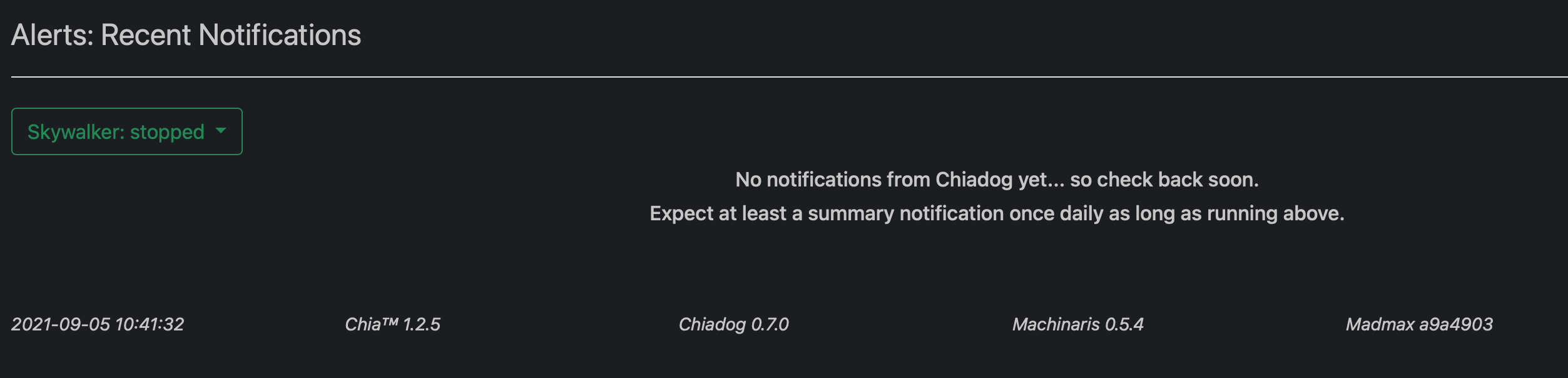

Hi all, just switched over from standard chia docker container so that I could get alerting.  I was wondering should the alerting be saying it is stopped?  It's been running for a few hours now - but just thought I'd check thanks.
1385895851_ScreenShot2021-09-05at10_41_49AM.thumb.png.228c6ed8242f2537097646f83e7976c8.png
Welcome! Thanks for sharing the screenshot.  I would recommend restarting the Machinaris container via the Unraid Docker tab.  This should restart all services, including Chiadog (and Flaxdog) that is shown as stopped.  Please let me know here (or on our Discord server) if that doesn't sort the problem.
Hi, yeah I did try that - and I just did it again for good measure with same result.  (BTW I've joined the Discord group also now thanks).
Anyway, I found the culprit - I had in my config like the below: note the first # which needed to be removed and now it starts.
Though I'm not convinced that's right yet - should there be something after keep_alive_monitor?  Like enabled or true?
Great, glad you got it sorted.  Welcome!

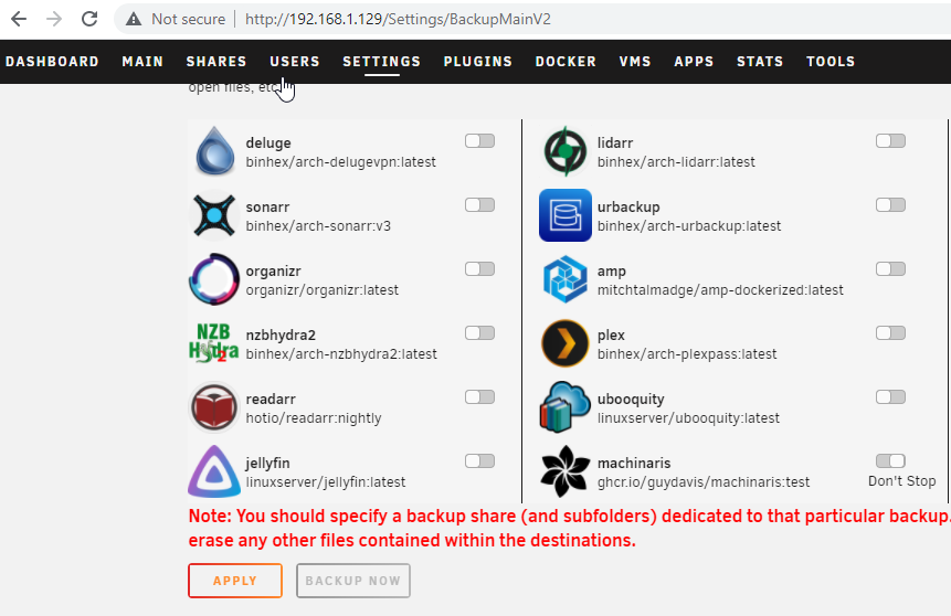

As of current version, if plotting is interrupted from a docker restart, are the in-progress plots able to be re-started or do they need to be deleted / lost?
I'm looking at automated app data backup and it says it will restart container after running - but I don't want to lose plots in progress.
Welcome back!   Good to hear from you again.  Don't hesitate to ask questions on the Discord server for a faster response than this list.
Unfortunately, a Docker container remains similar to a small VM in that when a container is restarted all processes inside (including plotting) are stopped.  At this point there is no way to resume a plot after a system restart for either the Chia or Madmax plotter.
So, if using "Backup/Restore Appdata" plugin, you can set Machinaris to 'Do Not Stop' under Advanced Settings as shown here.  There is some risk to getting a live snapshot, but you can always perform manual backups once in a while to minimize the risk.  Hope this helps!

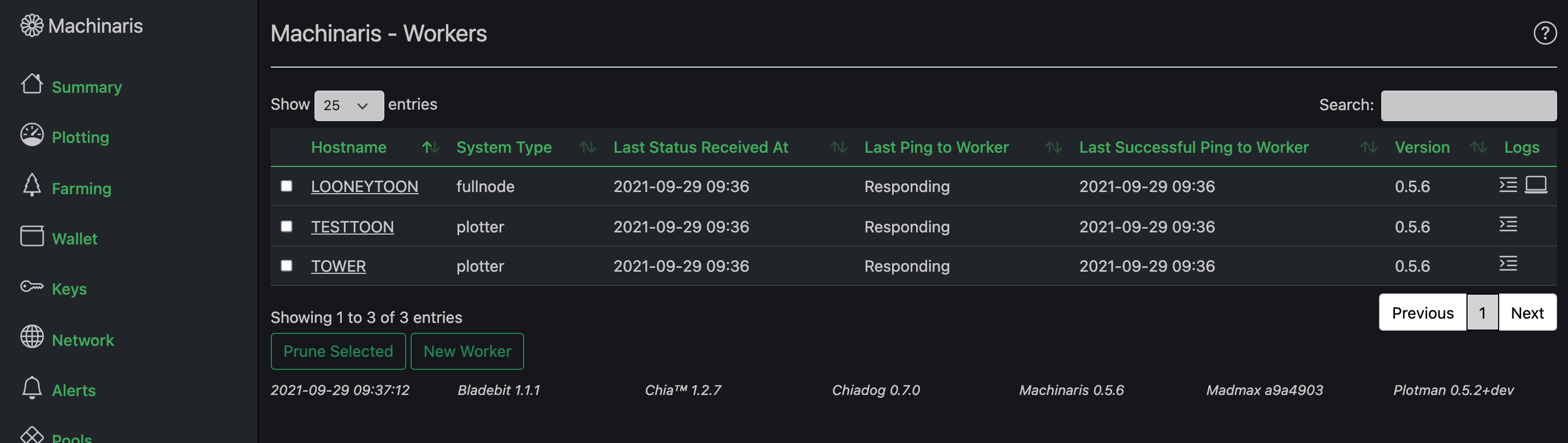

hi there, how can i fix this, hostname shows in Worker tab
558731269_ScreenShot2021-09-29at9_37_45AM.thumb.png.49c6e2a4e09919a93954e48b0f320d25.png

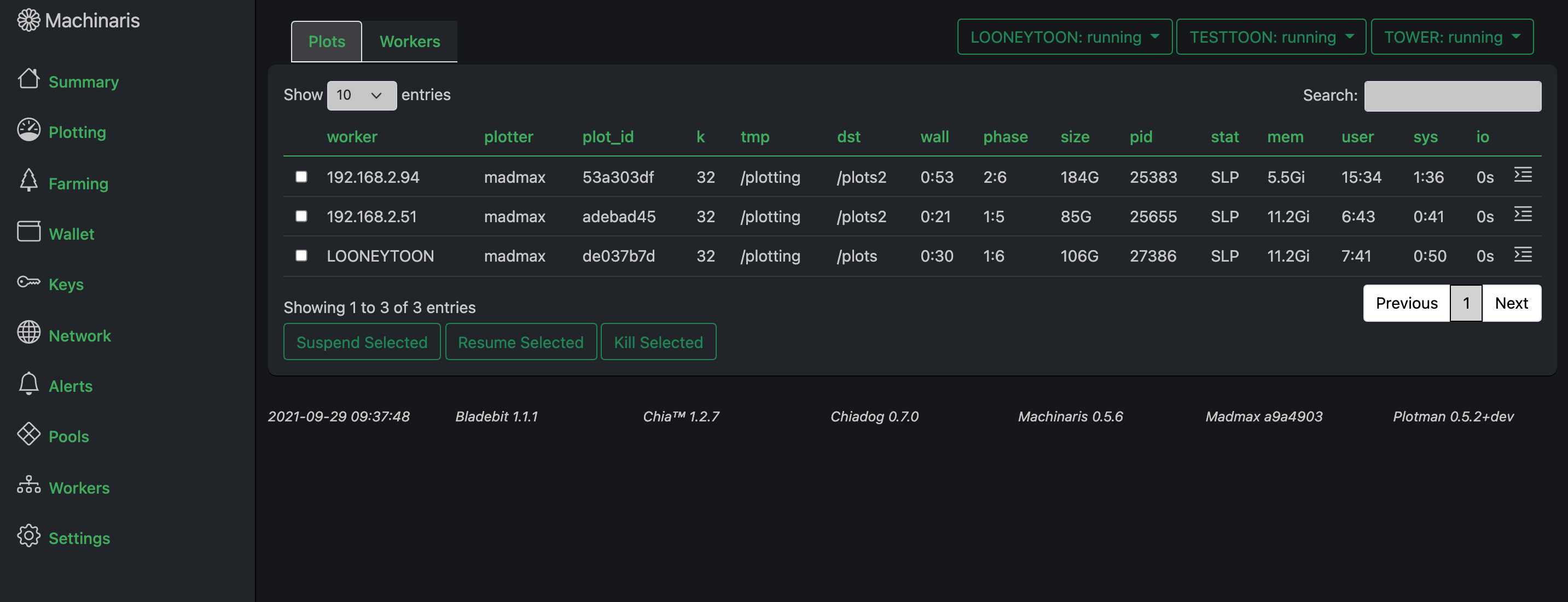

but IP shows in the Plotter tab
761452296_ScreenShot2021-09-29at9_37_55AM.thumb.png.5a0df1b9529fdefdf4341656da8acdb5.png
Good catch! This looks a defect on my end to not translate the IP address to display name on the Plotting page as I've done for other pages.  I'll take this on to fix in the next release.  Thanks again for the report.
