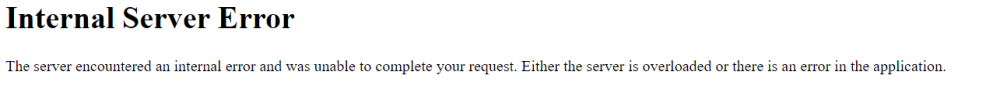

I'm getting this errror on my containers -
Internal Server Error
The server encountered an internal error and was unable to complete your request. Either the server is overloaded or there is an error in the application.
I followed the guide and reverified it a few times. how can i fix?
turns out i still had flax in there
solution was not to reply to the thread, but to re-read all posts fully and carefully.

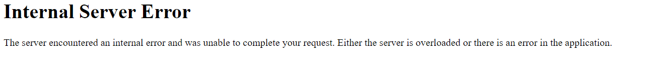

Followed the guide to update and removed all Flax port definitions but am still running into the internal server error.

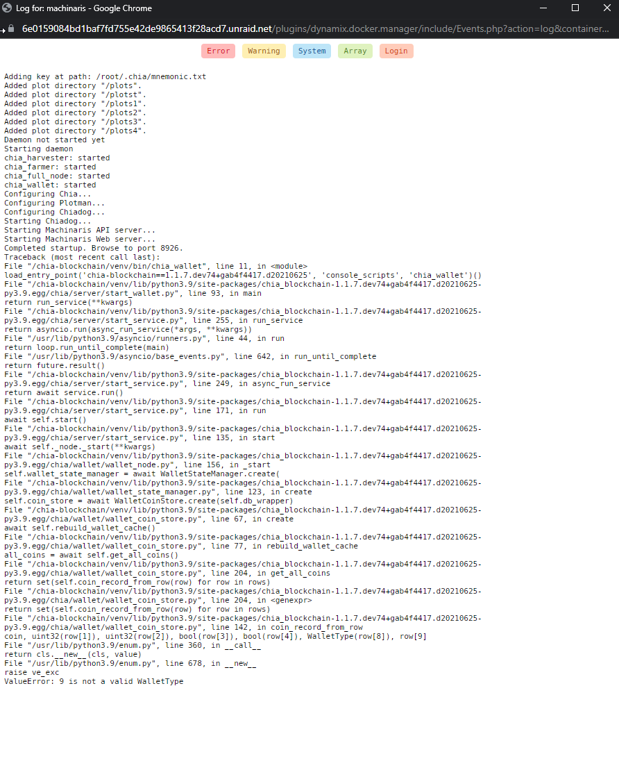

In the logs, I'm seeing the following error:
ValueError: 9 is not a valid WalletType
EDIT: For some reason it fixed itself overnight and starting at 12am it started farming again. WebUI is fine and just successfully installed all of your other forks.

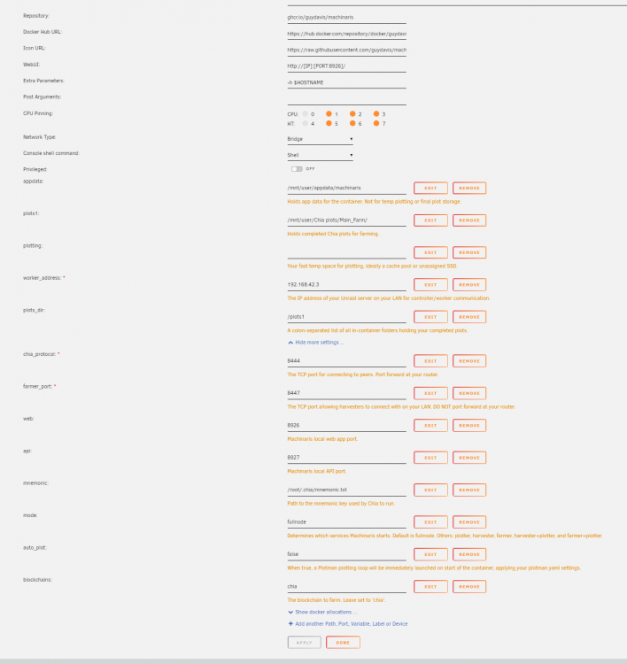

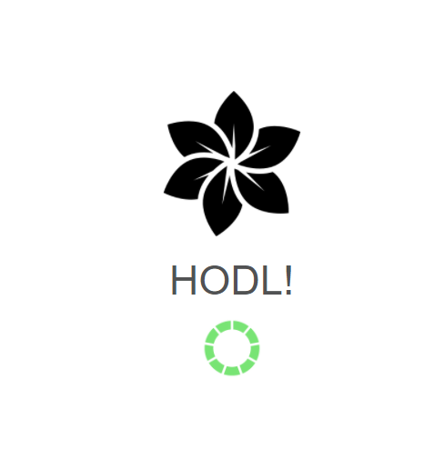

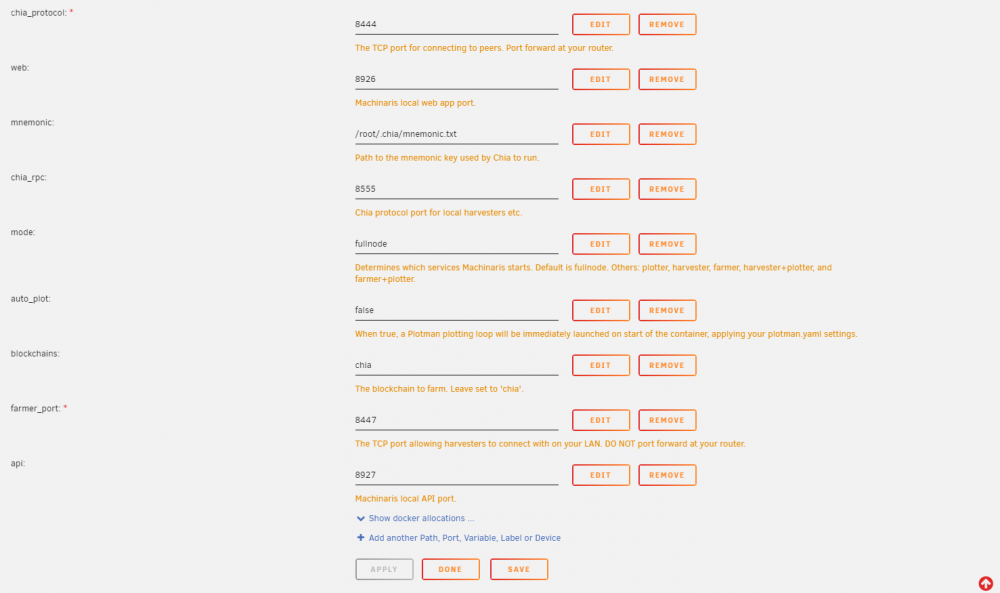

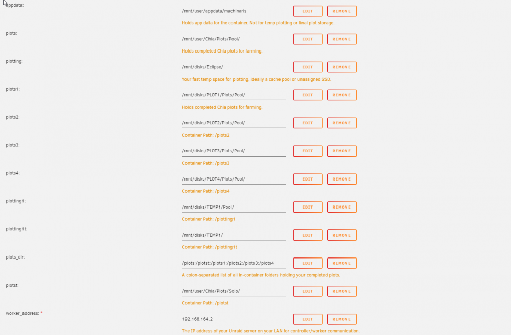

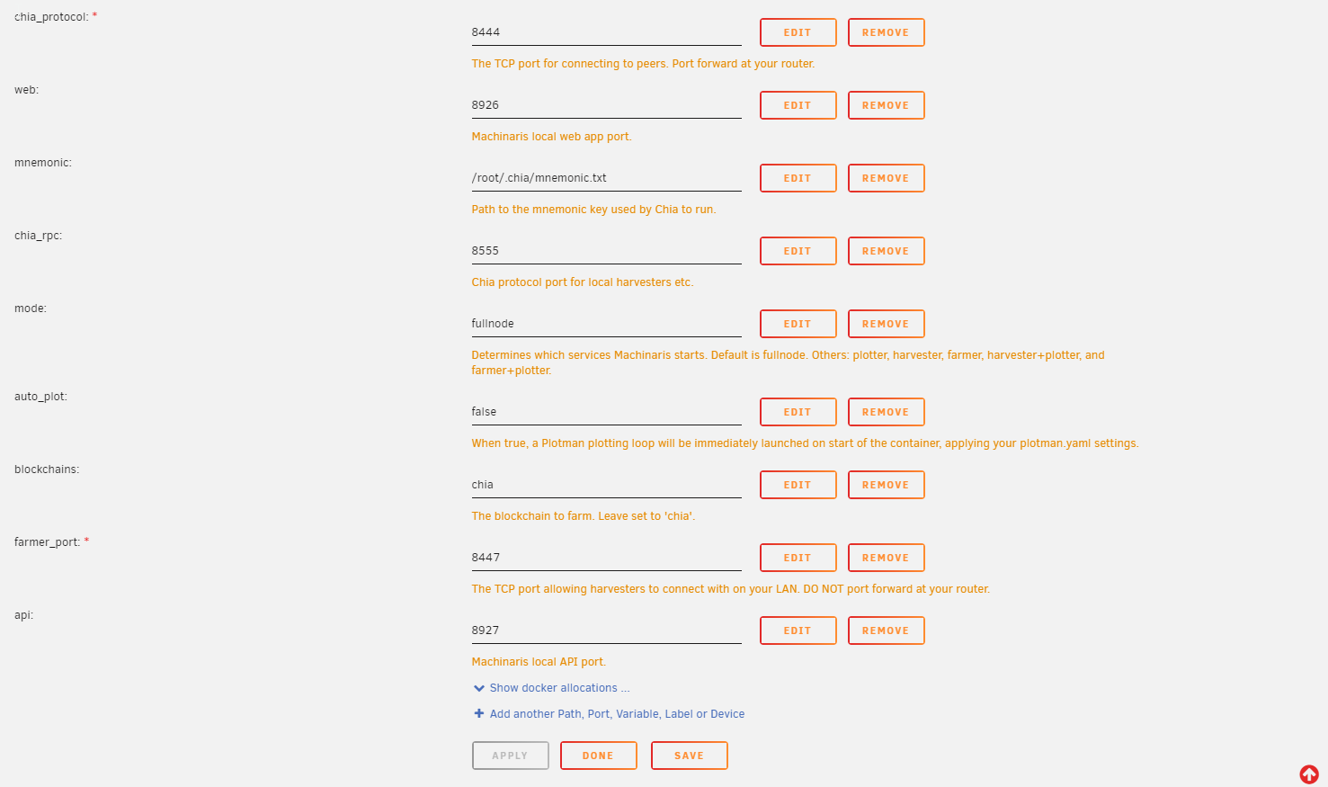

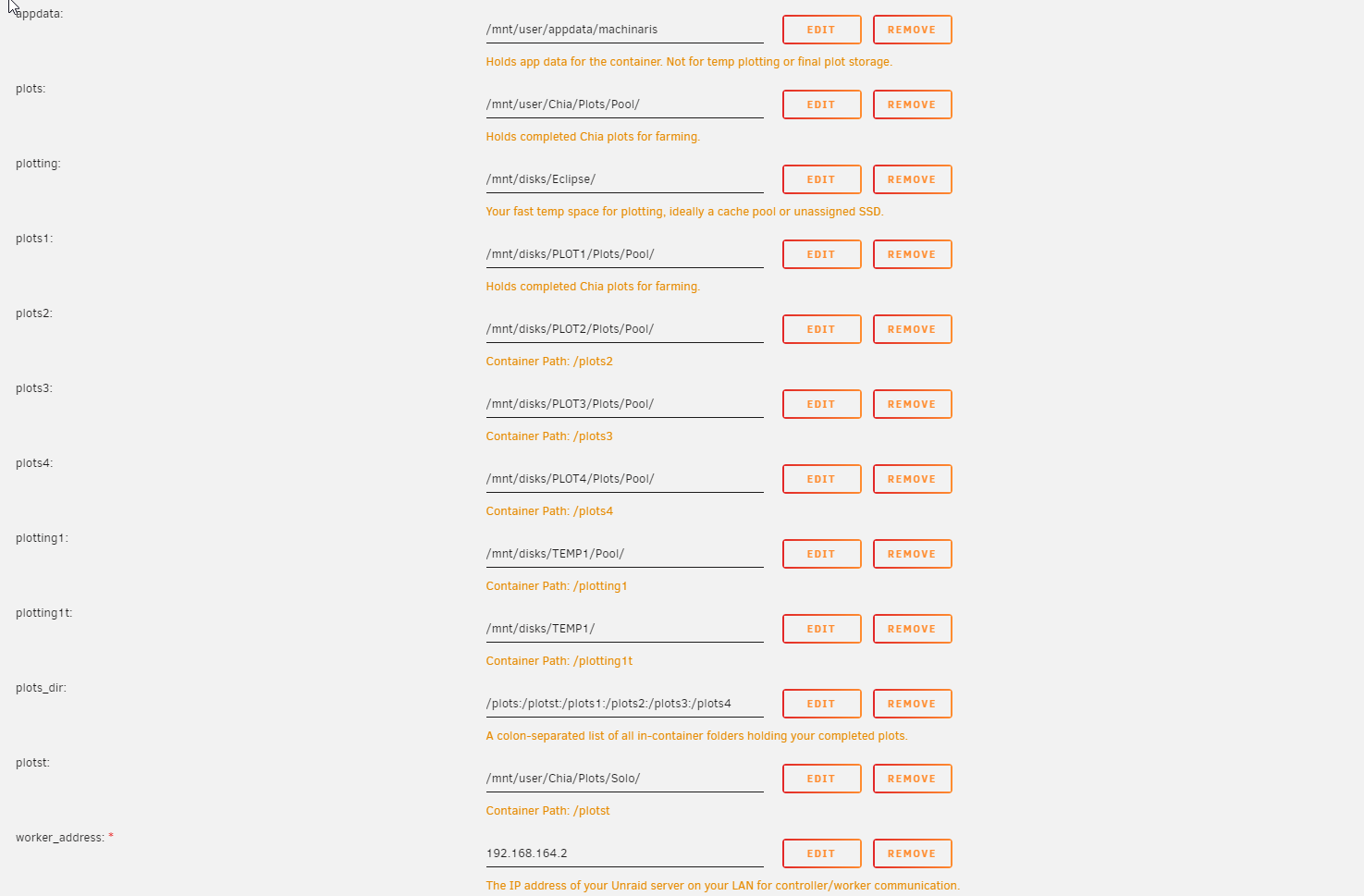

Ok what did i do wrong.
I have looked over this multiple times and i can not figure out what i did wrong.
When i try to go to the WebUI i get a loading screen (also noted its just the port in the address bar)
Then it redirects to /index and errors out
Config listed below

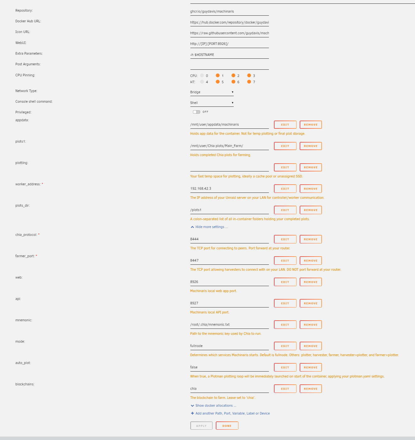

Config listed below
So i got this working by  removing  everything and completely rebiulding it.
Then it died again with the same error.
I suspect  Flora is what caused it  as it seemed to be working until i added flora to the mix.
Any ideas? Rebuild it  all again and skip flora for now?
iirc @guy.davis said on discord that flora isn't ready just yet, he's working on fixes on the :develop branch.
Ok, good to know.
Curious why the $%^#^ it would be posted to the apps if it breaks things. Whatever though.
Any idea how to fix it? Removing flora leaves  it broke. 😞
1 minute ago, _cr8tor_ said:
Ok, good to know.
nm, deleted appdata\machinaris\machinaris\dbs\machinaris.db again and it went back to working without flora.
