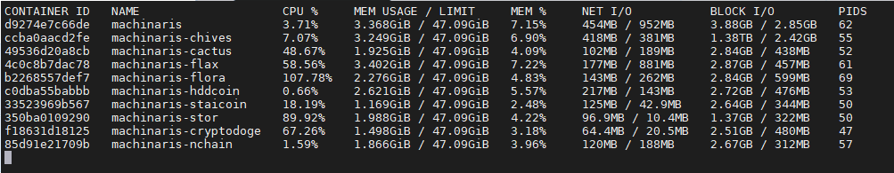

Fyi, I'm running ten blockchains on a single Unraid system with 48 GB total.  This Unraid system is doing a lot more than just Machinaris, including Plex etc.
Still have lots of headroom:
I only have 32GB installed currently.  I will need to get larger modules to increase.  I suppose there's a finite number of forks out there, but 2-3GB per fork adds up and this is my primary (and only) server.

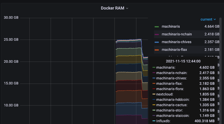

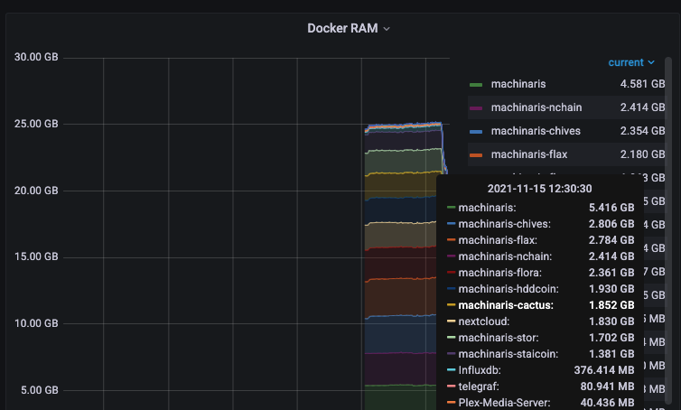

I have some nice telemetry in my server, so did some testing.
@guy.davis there is a good amount of saving if wallet is stopped. The saving is higher the older the blockchain, which kind of makes sense. Here are a few screenshots:
RAM without any tweaks:
RAM after the wallet was stopped for a few of the forks:
One way to solve for RAM could be to create SWAP. I also use my server to plot using ramdisk (ramfs). Since I only have 128GB RAM, and all these forks running, I use swap to ensure there is no OOM while I am plotting.
