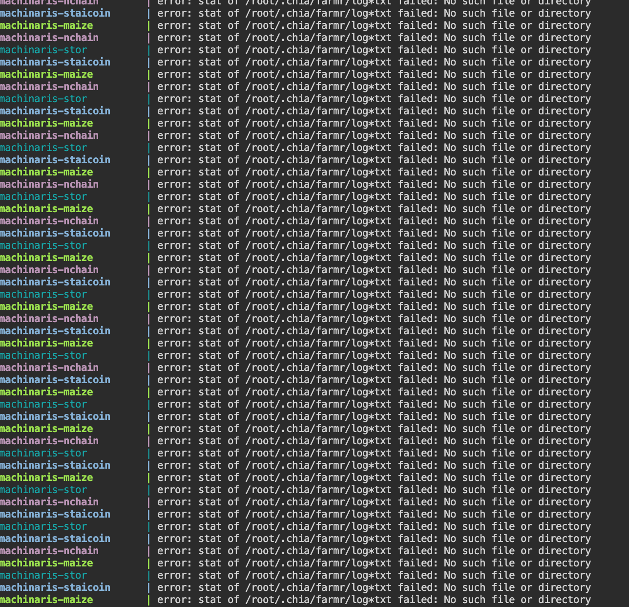

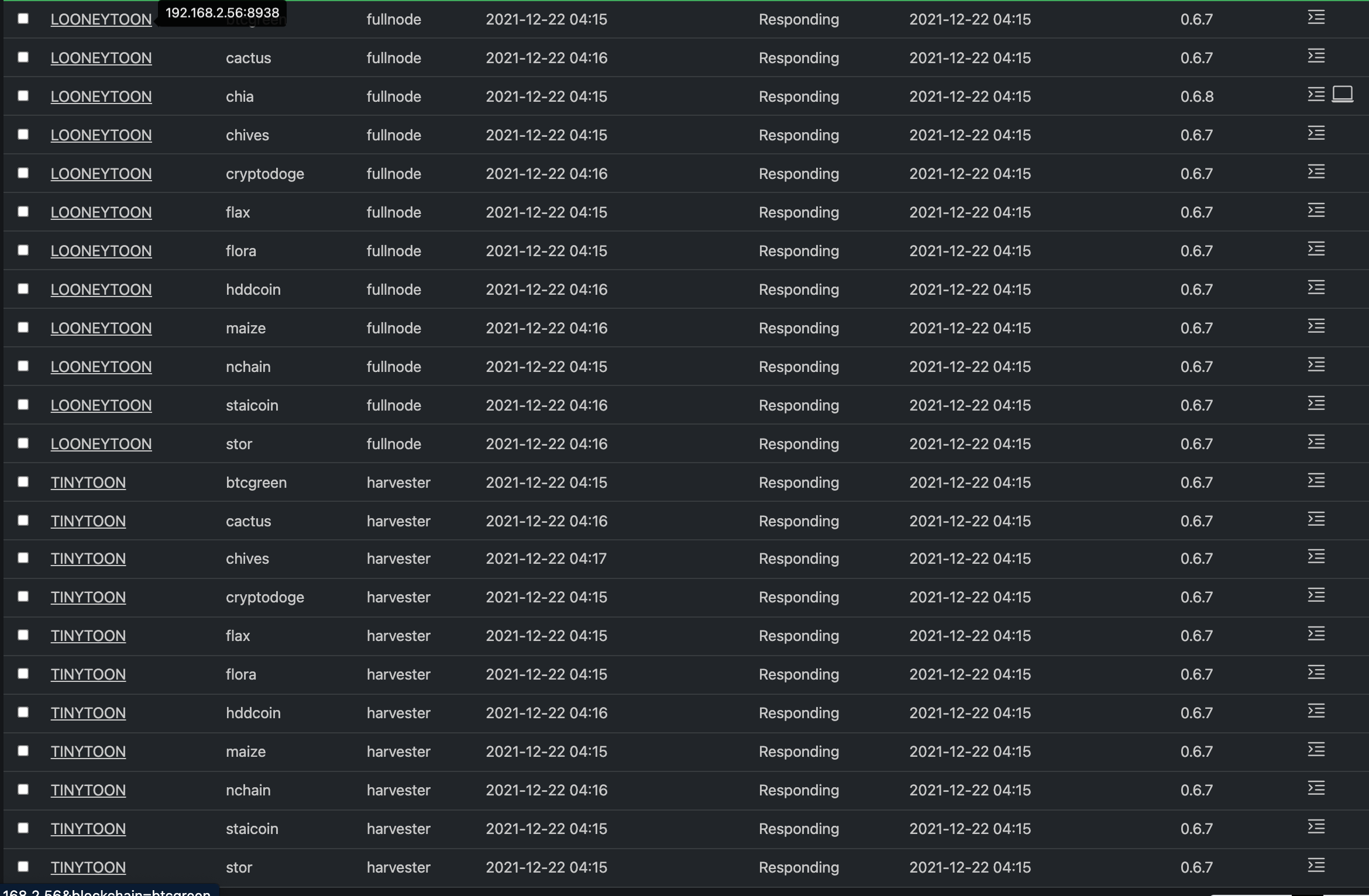

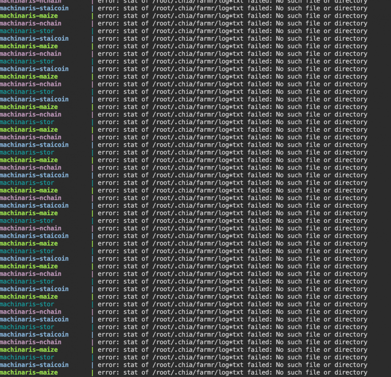

error: stat of /root/.chia/farmr/log*txt failed: No such file or directory
happening on all docker forks 0.6.7
doesn't seem to affect harvesting, i'm still winning on all forks daily
hopefully fix in next update

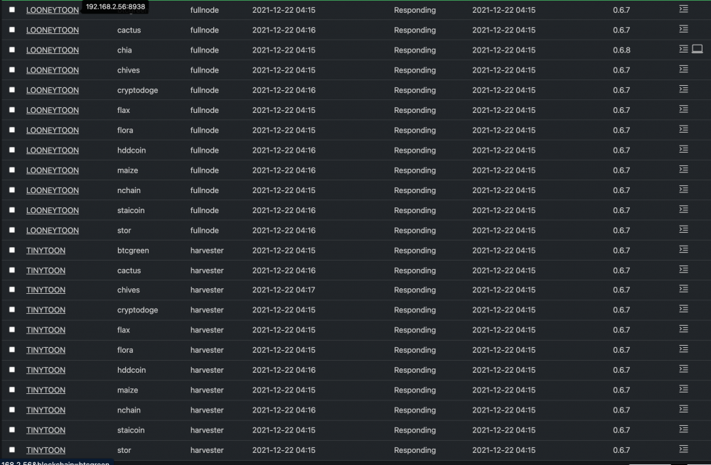

1796865496_ScreenShot2021-12-22at04_14_45.thumb.png.69131837741bd1fab896b8680bb32493.png
932828397_ScreenShot2021-12-22at04_17_56.thumb.png.46543dfaee180e2ed6bbfdc6b89015a9.png

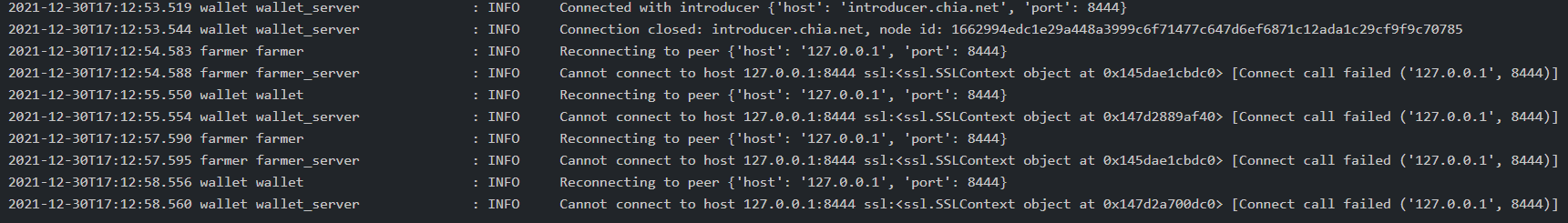

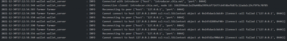

Since yesterday it appears I am no longer farming, looks like some kind of network issue ?
2021-12-23T12:44:19.481 full_node full_node_server : INFO Not accepting inbound connection: {'host': '115.218.128.199', 'port': 8444}.Inbound limit reached. 2021-12-23T12:44:20.913 full_node full_node_server : INFO Connection closed: 115.218.128.199, node id: ed8fddd8f8cd4533bab71c0fc4f20d2b049b75342cc0b822fef1cd13cd3ee627 2021-12-23T12:44:20.913 full_node chia.full_node.full_node: INFO peer disconnected {'host': '115.218.128.199', 'port': 8444}
The docker log says:
3 hours ago, Helmonder said:
The docker log says: Error: stat of /root/.chia/farmr/log*txt failed: No such file or directory
Hi! The log message is an unrelated message from a log rotation method in v0.6.7.  This log message has been corrected in the ":test" image for a couple of weeks.   I would recommend either updating to the test release, or restart the current version of the container.  Chia farming services can have issues which a restart often corrects.  Hope this helps.

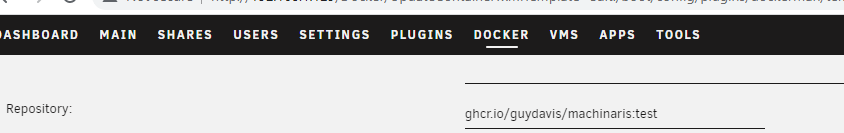

How do i update to the test release ?
Restarting did not help…
Verzonden vanaf mijn iPhone met Tapatalk
Hi, Unraid UI, Docker tab, edit the Machinaris container (Chia) configuration.  Change from :latest to :test for Repository line:
That did it ! Thanks !

I still cannot get my farming back up..
Any advice anyone ?
Any advice anyone ?
I tried all kinds of stuff I found left and right on the internet, but no effect... as far as I can see the wallet is not syncing...
Any advice anyone ?
Join the discord and get some proper advice from lot's of people including Guy himself. Normally there is someone there to help instantly.
Yesterday I deleted my complete blockchain db .. I see it is now connecting and rebuilding it.. Hoping some corruption there was the issue..
