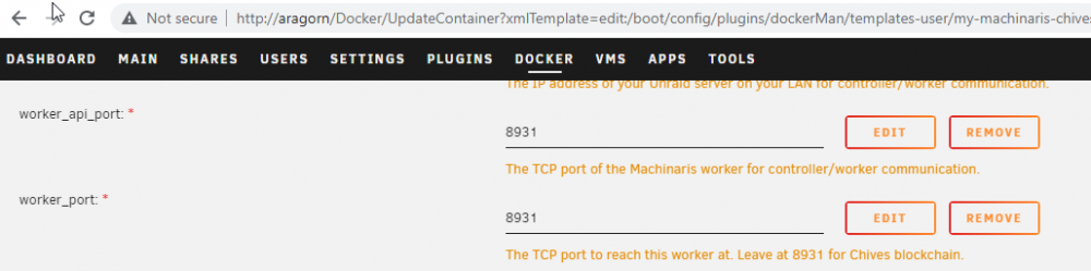

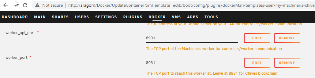

For this part -
PORT: worker_port: must the actual PORT ingress allowed so Unraid binds the worker_api_port for listening.
Can you clarify this? I'm going to setup my original full node as a harvester and standup a fullnode, albeit a smaller one, on my primary unraid server.
So when I have one full node and one harvester, all plots are built on the full node, correct?
18 hours ago, eagle470 said:
For this part -
Sure, Unraid has Ports and Variables.  'worker_port' is the actual Port binding.  'worker_api_port' is the Variable used inside the container.  Here's an example for Chives on 8931:

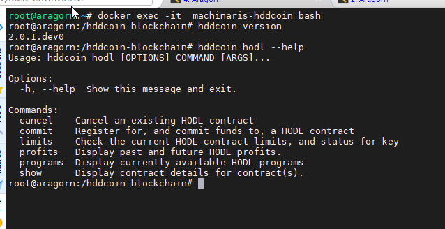

(I think??) I'm running the test stream (ghcr.io/guydavis/machinaris-hddcoin:test) and running "docker exec -it machinaris-hddcoin hddcoin version" returns "1.2.10.dev121".
What I did was simply add the :test to the repo in unraid "update Continer" dialog and hit apply, it looked to me like it pulled the new image and while I see you have more elaborate instructions in the wiki, please help me understand if and why all that is needed and whether running those commands will cause all of my running dockers to stop, wipe and re-pull? I've used docker commands a bit but never encountered the docker-compose command nor a need for it.
PS. Also. running "docker exec -it machinaris-hddcoin hodl -h" (or without the -h) returns:
OCI runtime exec failed: exec failed: container_linux.go:367: starting container process caused: exec: "hodl": executable file not found in $PATH: unknown
I do see your note in the changelog for :test stream about v6.9 updating to v1.2.11 but according to hddcoin github, v2.0 is needed for hodl.
Good catch.  Looks like they recently dropped another update.  This latest is now in Machinaris ":develop" today, and will be in ":test" in a couple more days.
Yes, all you need to do is change the suffix of the Repository line in Unraid Docker UI and click Save to switch between versions.  Check for Update helps too.
