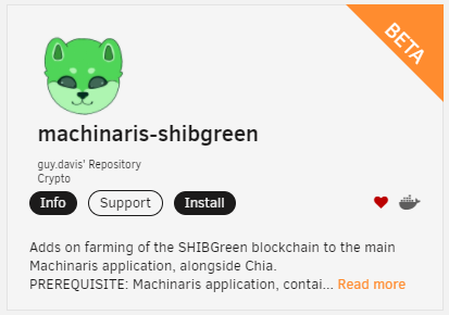

Anyone with ShibGreen port issues please check back soon an update has already been pushed (apparently)
Thanks Guy!
(or btcgreen port issues if you already have shibgreen)
You'll probably need to remove the Shibgreen template and reinstall (but the folder should be fine)
Edited by mdrodge
Thanks Guy!

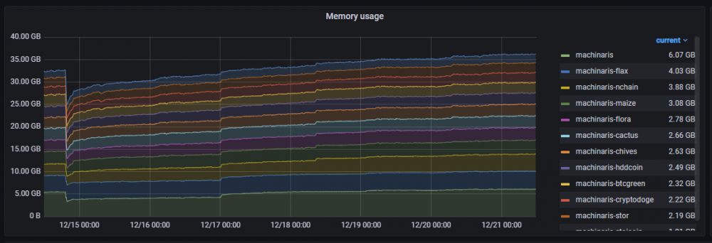

On 12/21/2021 at 11:43 AM, DoeBoye said:
There's an odd connection refused error for port 8926 (that appears in all my coin logs as well). Could that be causing issues? And what do I need to do to fix it?
Welcome to Machinaris v0.6.7!

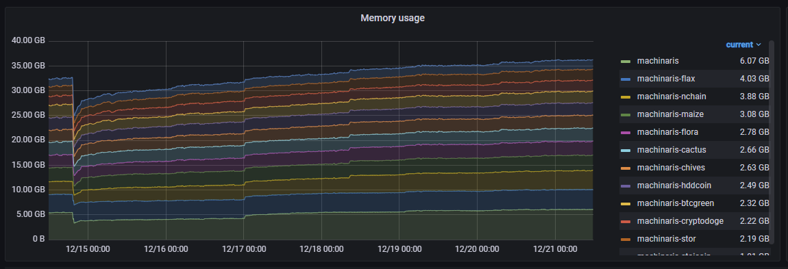

On 12/21/2021 at 12:53 PM, Einsteinjr said:
~1 week of running all of the containers available (when already synced).  It grows from ~25GB all the way to 36GB - and it is still growing.
Here is top of the OG machinaris container, using 6GB of memory.  I am only assigning 2 CPU cores so I wonder why there are 8 threads of chia_full_node running
