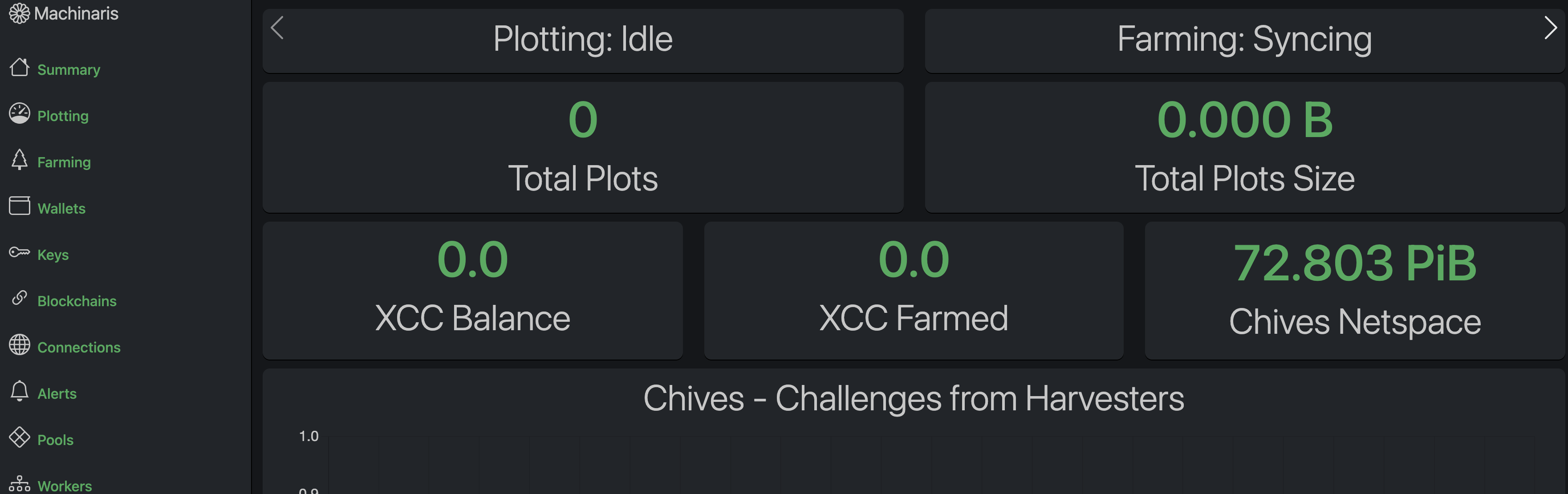

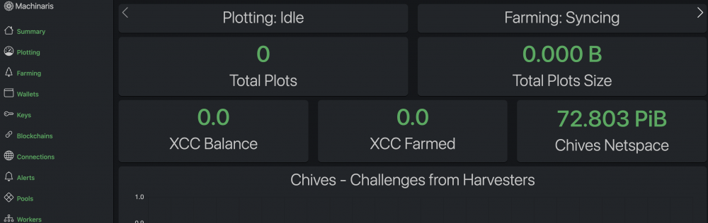

One more question non related to this topic:
Plots are not recognized for Chives coin farming (see screenshot)
Public key set looks kinda different from any other coins.
Could it be the reason? I did not make any changes other than adding my mnemonic keys as per your doc.
Thanks again

4 minutes ago, Andrew255 said:
Thank you so much for quick reply.
It worked like a charm.
Thanks again
For any other coins it shows 646 Plots
Not sure if this helps, but Chives cannot use the same plots as Chia and most other Chia forks, it only supports k29, k30 and k31. Chia and most forks by default use k32 or higher. Granted the plot sizes are smaller for Chives, but you would need to dedicate space just for making Chives plots that arent compatible with many other forks. For me anways, this makes Chives a no go, since I cant use what I already have.
Edited by cjizzle
added k29
Thanks for explanation, that make sense then
