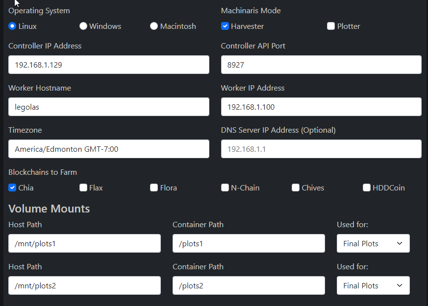

10 hours ago, DaPedda said:
Hi folks, I still have two problems:
1. I see my worker (harvester), but he doesn't give me any stats
2. Under "Connections" I cannot remove a host that is no longer reporting
My worker is on another unRaid server. I created the template via the full node and created it on the target server via docker-compose. I see him in the full node. Under Alerts it says: "Your harvester appears to be offline! No events for the past 81187 seconds." I think it's because of the port mappings. Before the update, the port mapping on the target server said e.g .: Network = default and mapping 8926: 8926
Today it says machinaris_default and mapping = 172.18.0.2:8926/TCP <> 192.168.158.103:8926
Same for the Port 8927.
At https://pool.space/ I see both harvesters, so the farming seems to be working for now.
Greetings, Peter

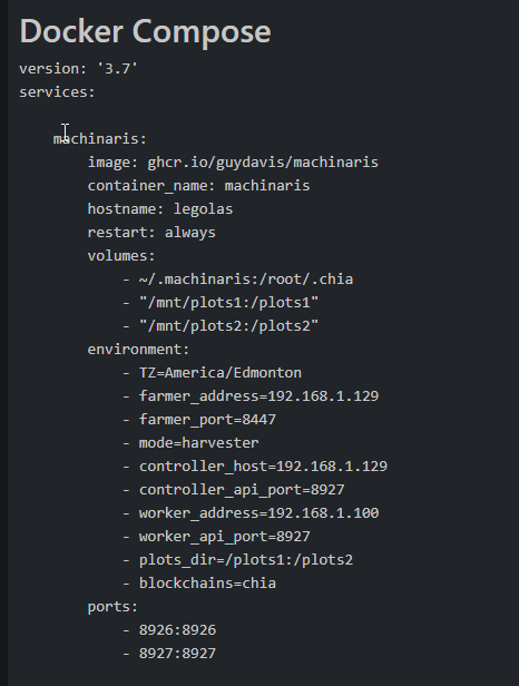

Yes, the Unraid Community App template for Machinaris provides a fullnode.  It is possible to re-purpose the settings in that template to run as Harvester, however it can be a bit tricky.  In particular you must enable "Advanced View" and 'Show more settings" in the Unraid UI | Docker tab | Machinaris "Edit" configuration.
Then for a Chia harvester:
Extra Parameters: -h $HOSTNAME
Networking: Bridge
Then, the easiest way to know exactly which Variables, Ports, and Volumes you need to configure in the Unraid UI on your Harvester is to visit the Machinaris WebUI on your controller and click New Worker.  Fill in the form, for example:
which gives as example this docker-compose.yml:
Each volume line becomes an Unraid Path, each environment line becomes an Unraid Variable, and each port line becomes an Unraid Port in the Machinaris config, Unraid UI | Docker tab.
Hope this helps.  We've walked a handful of Unraid users through setup for a harvester in the Machinaris discord, so don't hesitate to drop in.
EDIT: On re-read, it sounds like you might be running straight docker-compose on the harvester.  That can work too.
To trouble-shoot connectivity between harvester and fullnode, please paste a screenshot of your Workers page.  Then let's see the "docker logs machinaris" output of your harvester.  As well, please provide /mnt/user/appdata/machinaris/machinaris/logs/apisrv.log.  Thanks!
Edited by guy.davis

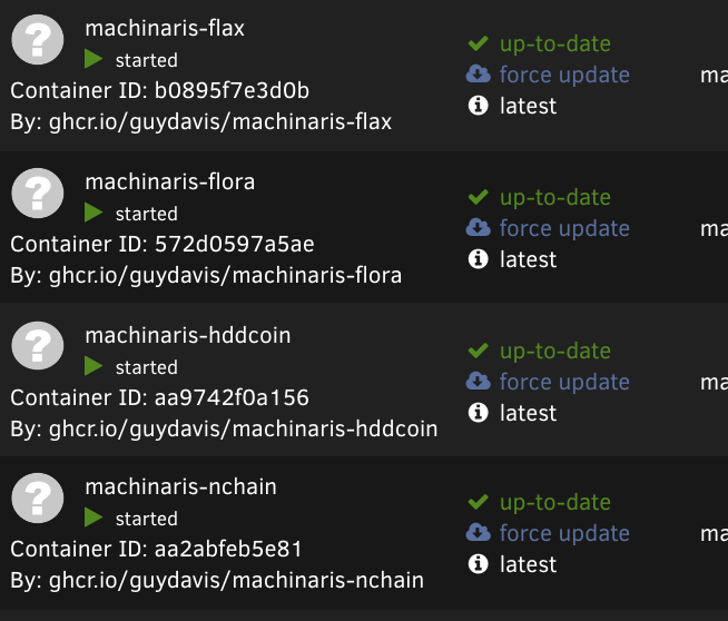

is it normal to have no Icons on the workers?
They have icons so, No..... I've seen this before so I'd call it normal but It's not good.
When ever I've had this was based around a traumatic event (last time I had a power loss for example)
I would normally replace the template.
(You won't lose the data)
My OCD kicks in when i see no Icons
Lol. Mine to. You might get away with a force update.

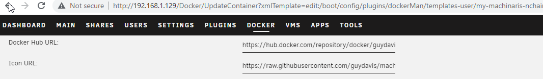

Yes, that's odd if you're using the Unraid Community Apps templates.   If you're using straight docker-compose instead then I would expect that however.
Since you're probably using the Unraid CA templates, try editing the Machinaris configs in Unraid UI | Docker tab.  Look for Icon Url and use the paste the icon names like:
https://raw.githubusercontent.com/guydavis/machinaris-unraid/master/logos/blockchain.png
Just replace 'blockchain' with 'chives', 'hddcoin', 'nchain', 'flax', 'flora', etc.
If they were already set like that and you still get a blank in Unraid UI, then I think you've discovered some strange Unraid UI bug.  Hope this helps!

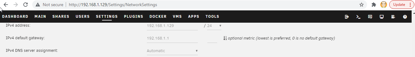

I have all my dockers running on custom bridge with dedicated IP.  I've tried adding the IP assigned to machinaris docker in the worker_address variable, but I still can't get machinaris running again.  I'm using a basic full node setup, chia only.
debug.log
webui.log
Anything I can do to get this running on a custom bridge network again?
@jortan I am this forum's most pathetic member. I've been trying to get chia and machinaris to work for over 5 months now without success.  Poor @guy.davis knows and dreads my name and I have a terminal case of sunk cost fallacy as I've got over 1300 plots and not one penny earned.
Anyway, all that to say that just today I found some references in my log which said " 2021-10-27T03:38:16.745 farmer chia.farmer.farmer         : ERROR    Exception in GET /farmer https://xch-us-east.flexpool.io, Cannot connect to host xch-us-east.flexpool.io:443 ssl:<ssl.SSLContext object at 0x14d25b789ec0> [Temporary failure in name resolution]"
So I'm thinking that maybe some of my problems may be related to networking or firewalling.  Accordingly I was hoping to take Machinaris off host network and assign to a custom IP so I can manage it separately in my firewall/router rather than being clumped in with my unraid box which runs through a VPN.
I selected "bridge" network option in edit but when it runs the docker I'm still seeing Machinaris connected at a port of my main server instead of a separate IP.  How are you doing this?
Hi Ystebad.  Not all!  Happy to help you out.  Sorry to hear you've experienced trouble so far.
As per the 0.6.0 upgrade guide, bridge network type is recommended.  Since the error above looks like DNS, I recommend checking the DNS value in Network Settings on Unraid UI | Settings tab.  For example, my DNS is my local router at 192.168.1.1
However, you could try a cloud DNS provided such as 1.1.1.1 or 8.8.8.8 instead to remove your LAN's router DNS from the equation.  Hope this helps!  Don't hesitate to ask further questions or join us in the Discord.
 My network settings in unraid are correct for my router (10.0.0.1) and my router WAN dns is set to cloud flare 1.1.1.1.  However since it seems to be having trouble resolving the pool connection, maybe this explains all the troubles I've had never being able to get connected to mine my pool plots.
I completely deleted machinaris and the data folder and reinstalled including entering my wallet phrase and redownloading the whole blockchain.  So I don't think the "upgrade" would apply.
However it says: Extra Parameters: -h $HOSTNAME and my extra parameters is blank.  This is stupid question: but what do I put for "HOSTNAME" ?
i'm using Docker-compose only.  hopefully we can add icons in the future.
Sorry, the icons shown on Unraid UI's Docker tab are only possible if you install each container individually from the Apps tab (aka Community Applications).  docker-compose does not support Icon display in Unraid.
