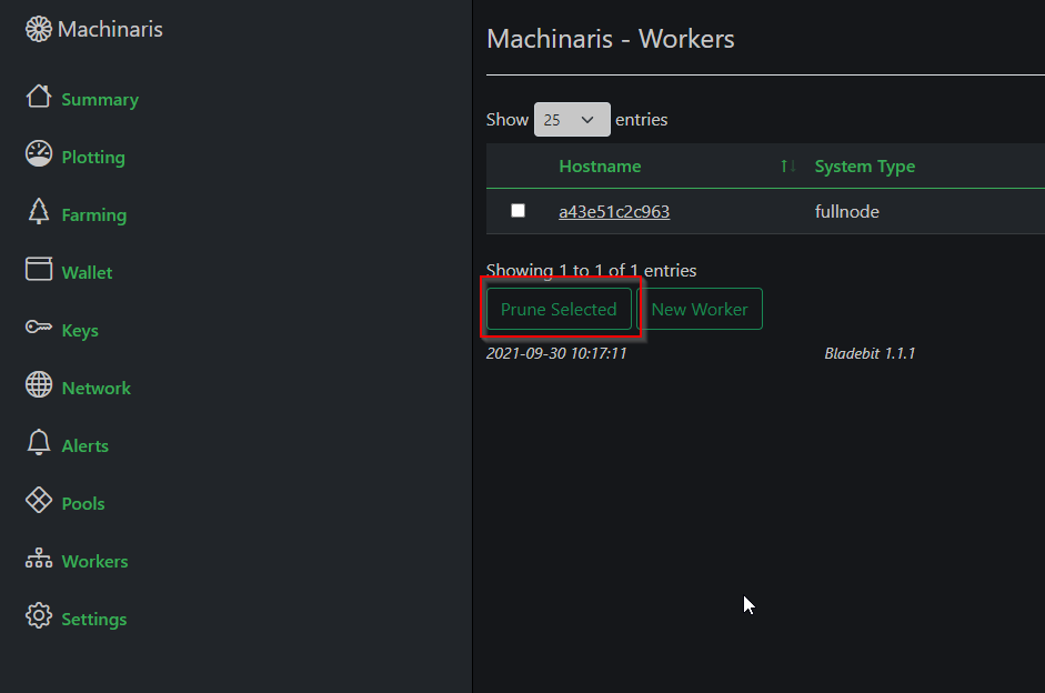

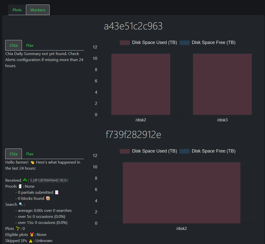

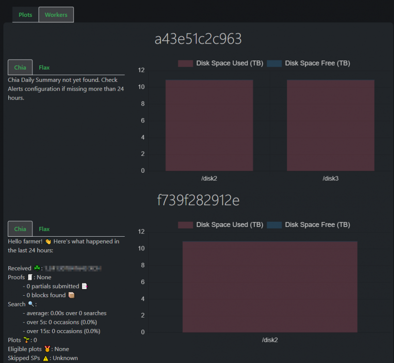

I'm trying to move my farmer from official client in a Linux VM to Machinaris on my NAS to make things nice and easy. But whenever I make any configuration change and restart Machinaris, it creates a new farmer ID as seen here. To be clear, I am not doing anything other than adding a new path to the config and restarting the container.
Have others observed the same behavior? I would like to only have 1 single ID since this is all on one machine and I like clean interfaces lol. Will the "older" ID disappear once the history goes back far enough? I want to avoid having 20 IDs eventually if I continue tweaking the container settings.
EDIT:
After a while, the old ID disappeared from the Summary plot, but it still exists in other locations, such as the Workers, Wallet, Keys etc views.
Edited by neodied
Added second half of post with update
Solving my own issue :)
I found the option under Workers to "Prune", which appears to be exactly what I needed. After using this on the previous ID, all the interfaces show only this remaining worker ID.

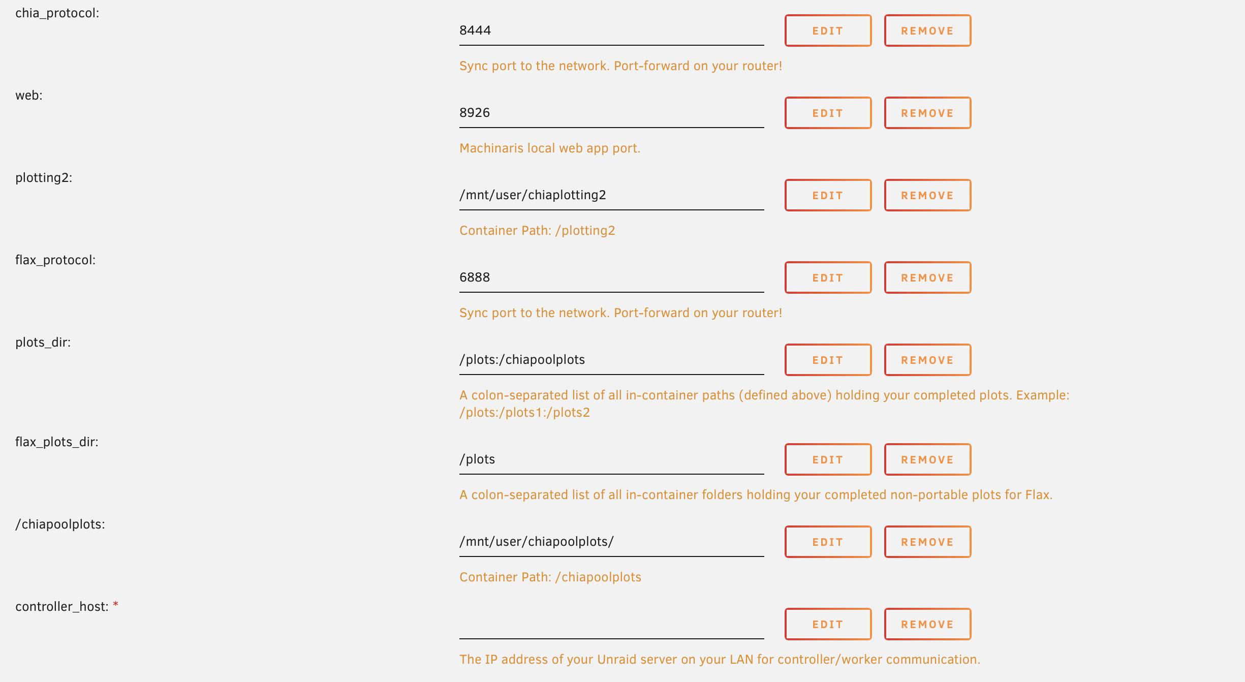

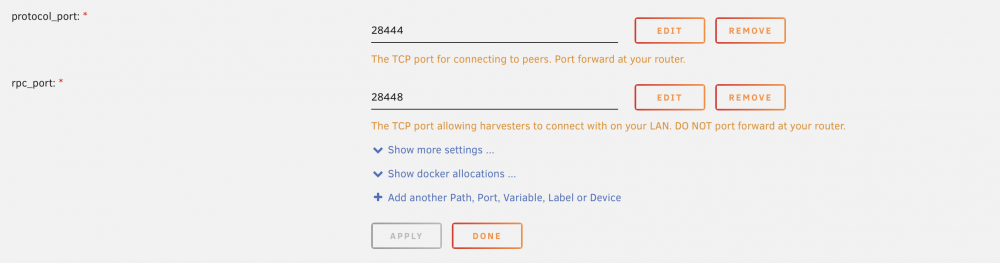

Can I harvest my existing plots with the new chives, hddcoin and nchain as well? With the new flax separate container does that mean flax will be removed from the original machinaris container? Because it looks like I can still harvest it from the main one.
I started experimenting with this last night. So far there is no way to interact with them.
To get them to sync and and report in, the following is required:
  1. Own IP. The default bridge mode will not work as the worker's name is linked to its IP address.
  2. Adding the following to extra parameters:
    1. -h "<dockername>" -e TZ=<local> -e worker_address=<Worker IP> -e controller_host=<Machinaris IP> -e controller_api_port=8927
      1. EX: -h "chives" -e TZ=America/Los_Angeles -e worker_address=192.168.1.24 -e controller_host=192.168.1.2 -e controller_api_port=8927
I also have not been able to figure out what the worker_api_port is for. None of them are being requested by docker, so the port isn't actually opened. when manually opening the by via -p 8931:8931 (for chives), nothing changes.
it appears the built in flax and the addon flax are different.
I was unable to find documentation any of this, so everything done was a guess.

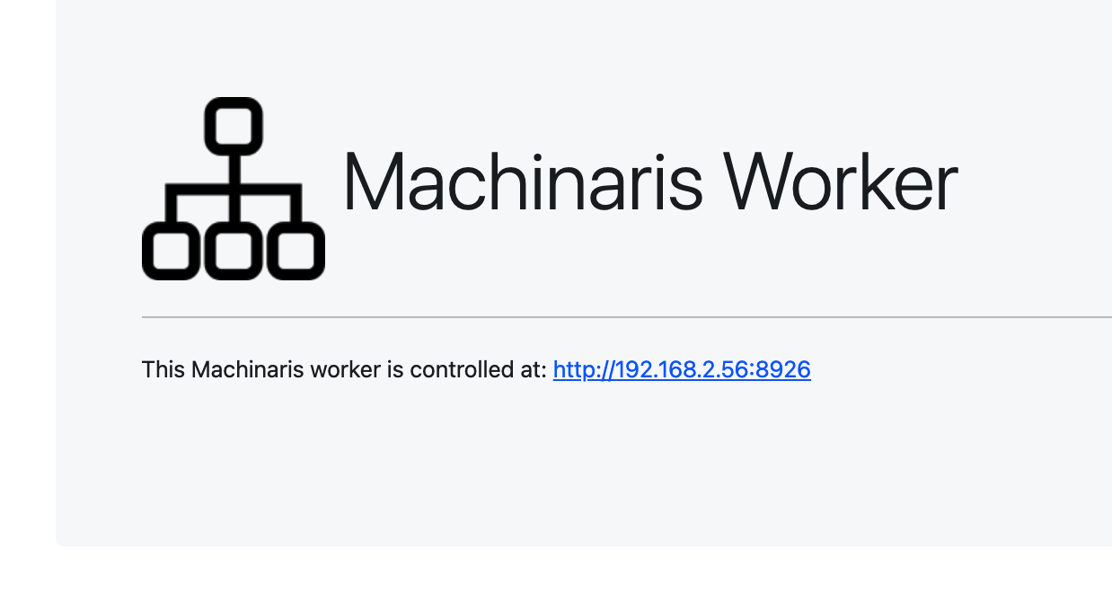

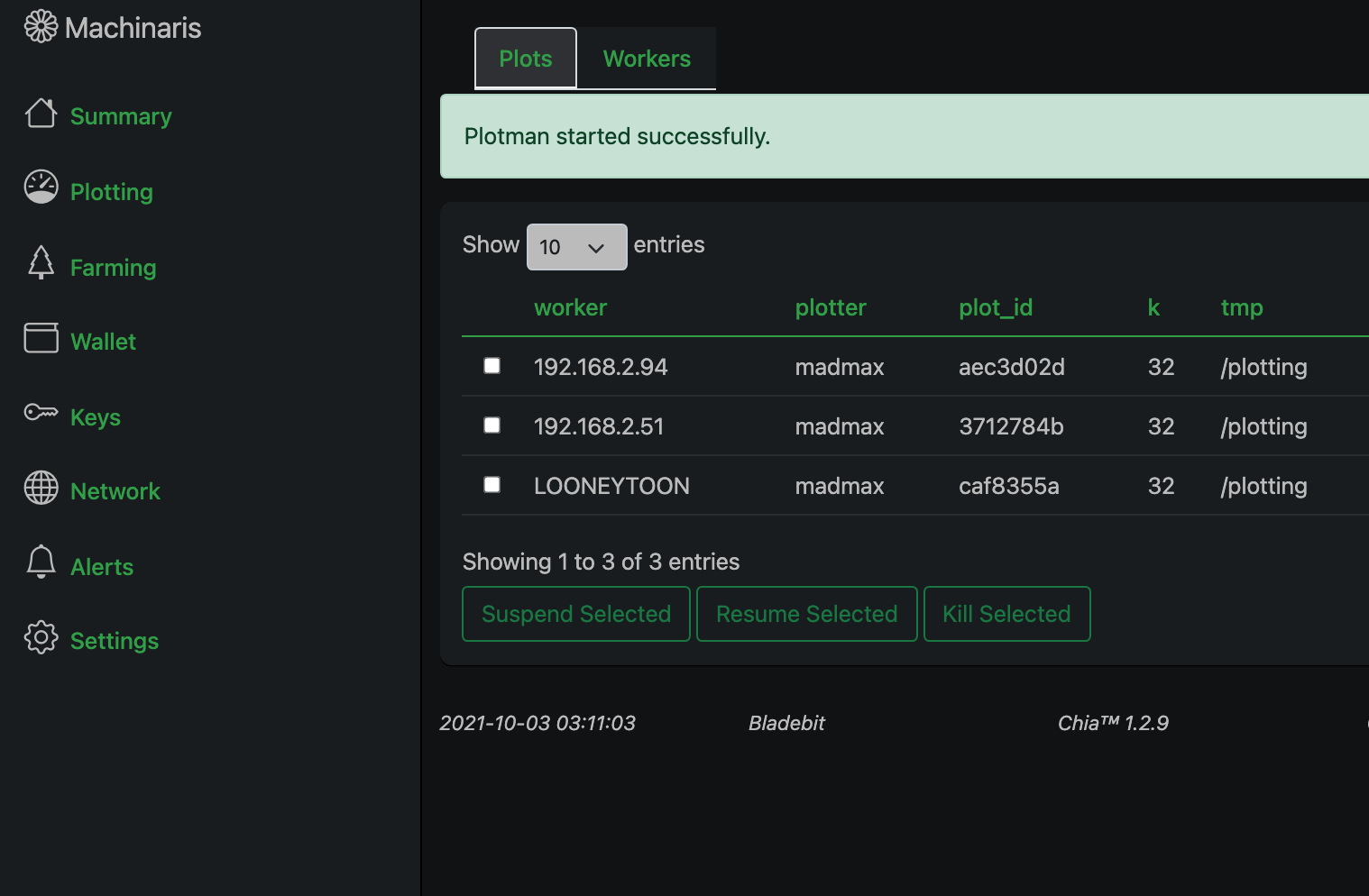

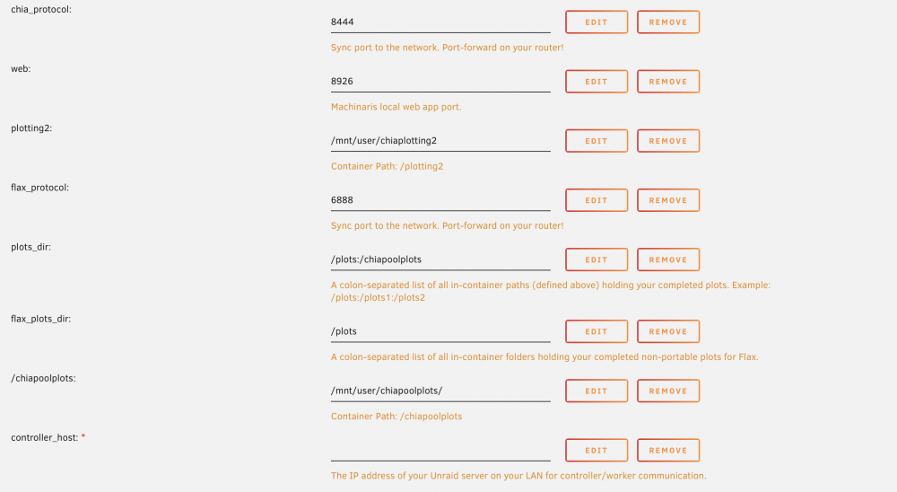

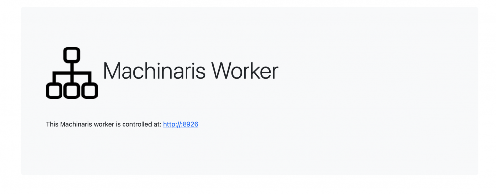

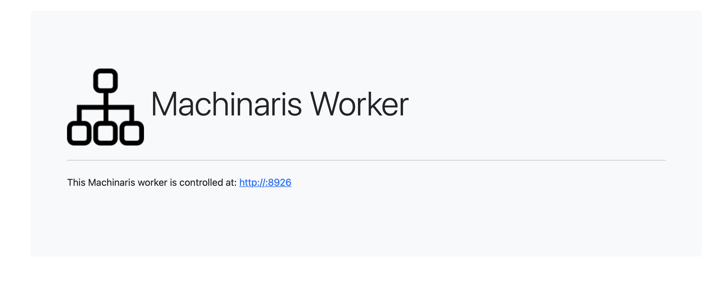

upadte, cannot access web gui, keeps saying its controlled by my IP address. I click on link , endless loop....
788398090_ScreenShot2021-10-03at3_09_01AM.thumb.png.69353c44da93c5a8c144337e32e83315.png
1165620151_ScreenShot2021-10-03at3_09_23AM.thumb.png.6b9d49ae7b07654cd3cf1dea2aa6511f.png
only way for me to get in was to add http://192.168.2.56:8926/plotting/jobs
plus still IP hostname not fixed yet.
2087825762_ScreenShot2021-10-03at3_11_27AM.thumb.png.7acf31d795ebccfdd8fb407ce984b659.png
Same problem here except the address slightly different. Cannot access

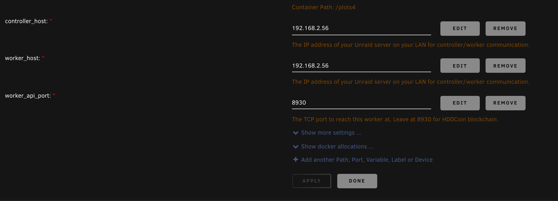

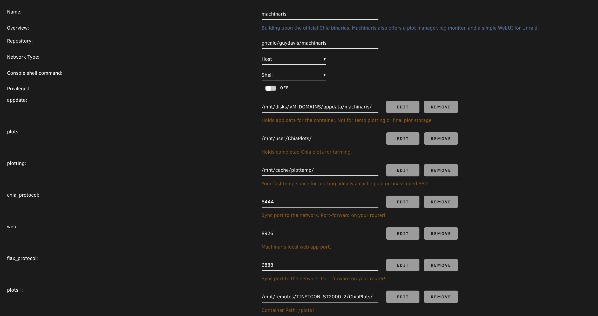

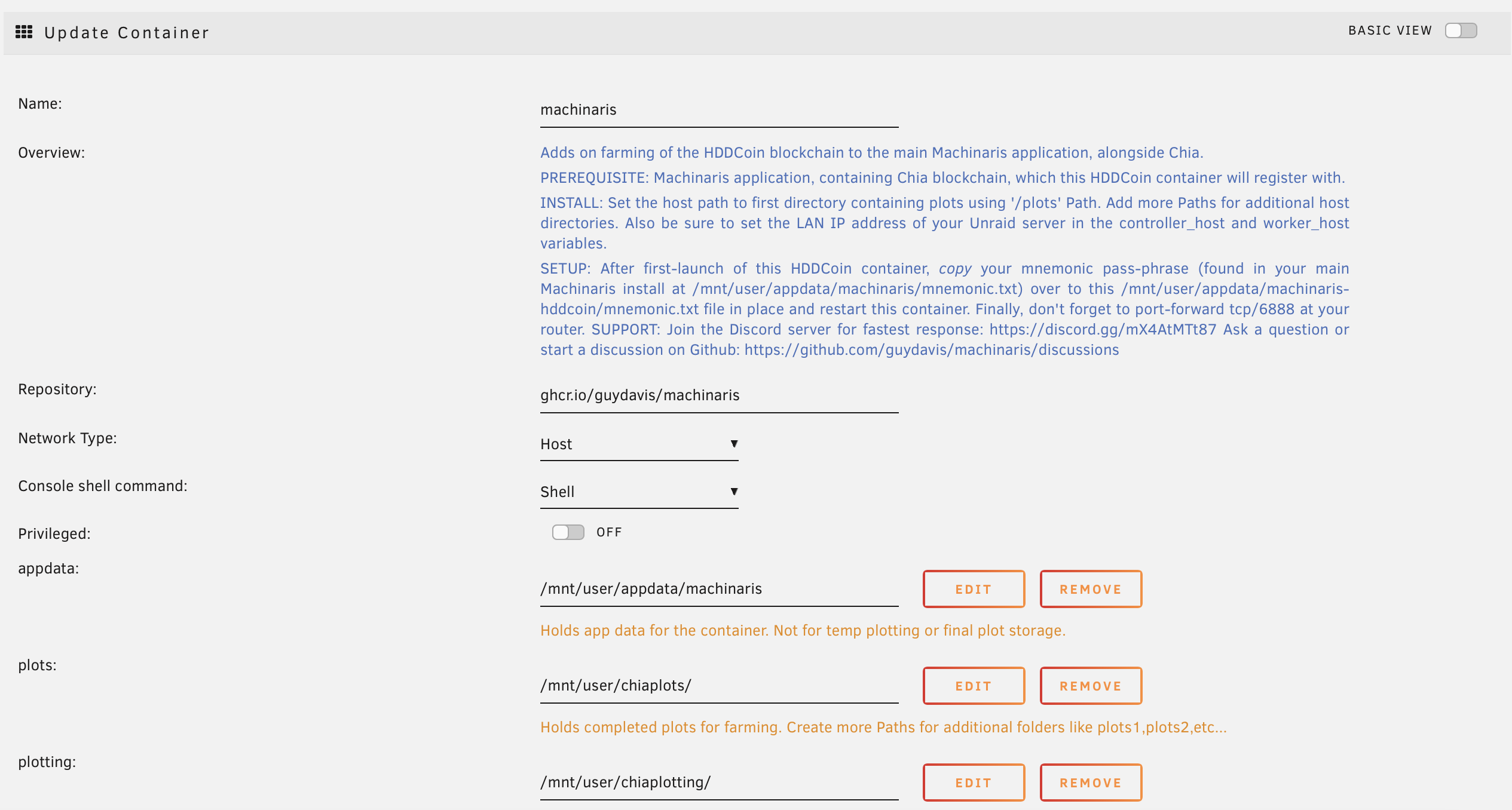

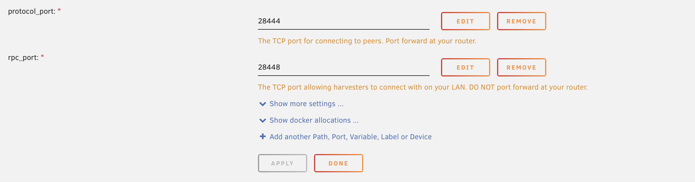

 Sorry, to hear that.  Please post a full-series of screenshots showing all settings for Machinaris under your Unraid Docker config, more than the snippets posted above.   They seem to show one of the new beta templates for Machinaris forks.

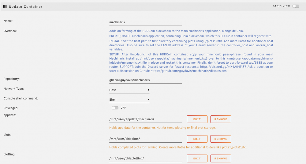

It seems like something is wrong with the Unraid Community Apps template for Machinaris which is unchanged for over 20 days now: https://github.com/guydavis/machinaris-unraid/blob/master/machinaris.xml
i temporary fixed my issue by deleting the 3 new lines, and restarting the docker..  hope it gets fixed soon..

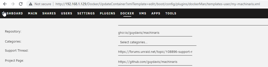

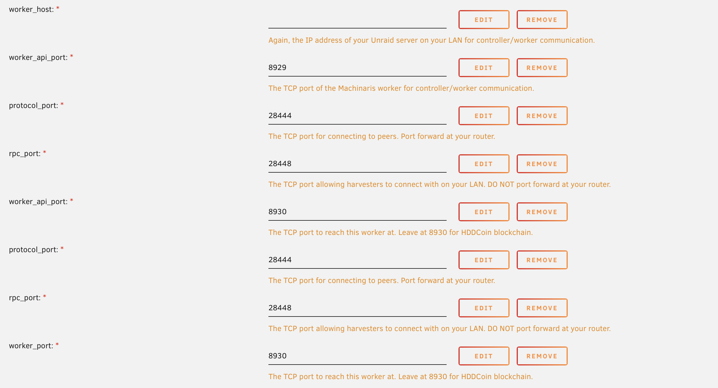

881125648_ScreenShot2021-10-03at11_48_37AM.thumb.png.dc616ec0e318d5e95fedb389984d6a9b.png
917734727_ScreenShot2021-10-03at11_48_52AM.thumb.png.1a5bf94c61442c878e1898c9cb335e04.png
This also shows up on my "fix Common problems":
Template URL for docker application machinaris is not the as what the template author specified.The template URL the author specified is https://raw.githubusercontent.com/guydavis/machinaris-unraid/master/machinaris-hddcoin.xml. The template can be updated automatically with the correct URL.
But running "apply fix" doesn't seem to do anything.
Trying to open the GUI gives me the same screen noted above but says:
This Machinaris worker is controlled at: http://:8926

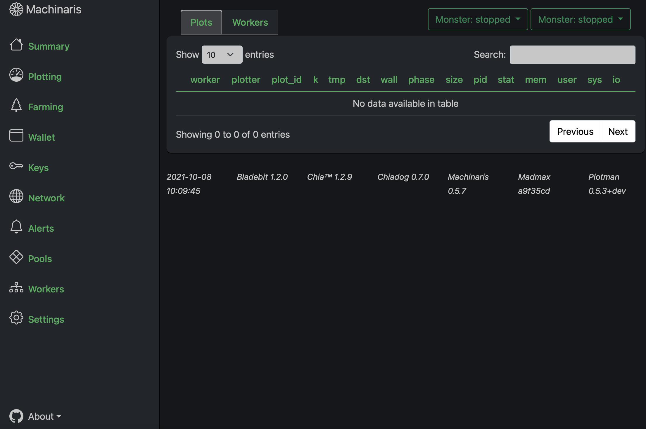

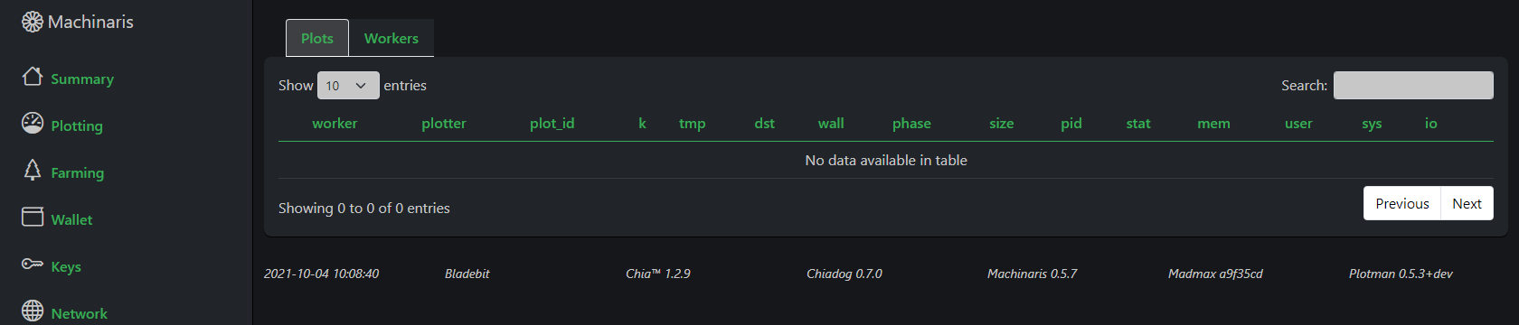

I'm having an issue where Machinaris on unraid loads, the farmer is running, but I am unable to change any of the settings (all blank) and I cannot start a plotter as the button is not there.
It is like something has been corrupted, but I want o have to avoid downloading the whole blockchain again with a clean install.
The same happens on test and main versions.
Help!
image.thumb.png.f0295115de48e8c2df2e3d68be744b3b.pngimage.thumb.png.94016aa40ebb00caa665d04dc874ffbe.png
Help!
Sorry to hear that.  Please share:
  1. A screenshot of your Workers page to indicate status of install(s).
  2. The end of your log files (apisrv.log and webui.log) in /mnt/user/appdata/machinaris/machinaris/logs).  Also available from right-hand side of your Workers page.

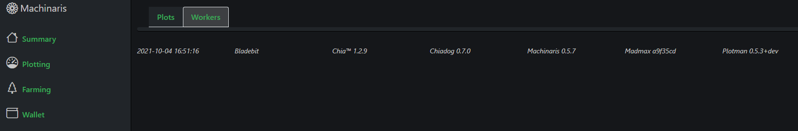

I think I may have to wipe and reinstall, lots of errors and issues in my install
Worker Page (none existent !)
Webui.log (some funny errors here)

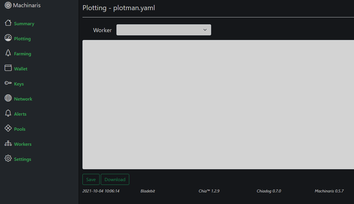

2021-10-04 16:52:56 [2306] [INFO] 192.168.1.9 - - [04/Oct/2021:16:52:56 +0100] "POST /workers/ HTTP/1.1" 500 46 "-" "python-requests/2.26.0"
2021-10-04 16:52:56 [2269] [INFO] Job "workers (trigger: interval[0:02:00], next run at: 2021-10-04 16:55:50 BST)" executed successfully
2021-10-04 16:53:12 [2269] [INFO] Running job "plottings (trigger: interval[0:02:00], next run at: 2021-10-04 16:55:42 BST)" (scheduled at 2021-10-04 16:53:12.467739+01:00)
2021-10-04 16:53:13 [2307] [INFO] 192.168.1.9 - - [04/Oct/2021:16:53:13 +0100] "DELETE /plottings/Tower HTTP/1.1" 204 0 "-" "python-requests/2.26.0"
2021-10-04 16:53:13 [2269] [INFO] Job "plottings (trigger: interval[0:02:00], next run at: 2021-10-04 16:55:42 BST)" executed successfully
2021-10-04 16:53:24 [2269] [INFO] Running job "alerts (trigger: interval[0:02:00], next run at: 2021-10-04 16:55:41 BST)" (scheduled at 2021-10-04 16:53:24.591082+01:00)
2021-10-04 16:53:24 [2269] [INFO] Job "alerts (trigger: interval[0:02:00], next run at: 2021-10-04 16:55:41 BST)" executed successfully
Hmm, let's see if we can get this sorted out.  Please ensure you are using a Repository setting of "ghcr.io/guydavis/machinaris" on the Docker settings for Machinaris:
Then:
1) Stop Machinaris container
2) Delete /mnt/user/appdata/machinaris/machinaris/dbs/machinaris.db (on the Unraid host filesystem)
3) Start Machinaris container
This should ensure you are using the latest release and create a fresh status database on launch.  Please let me know how it goes.

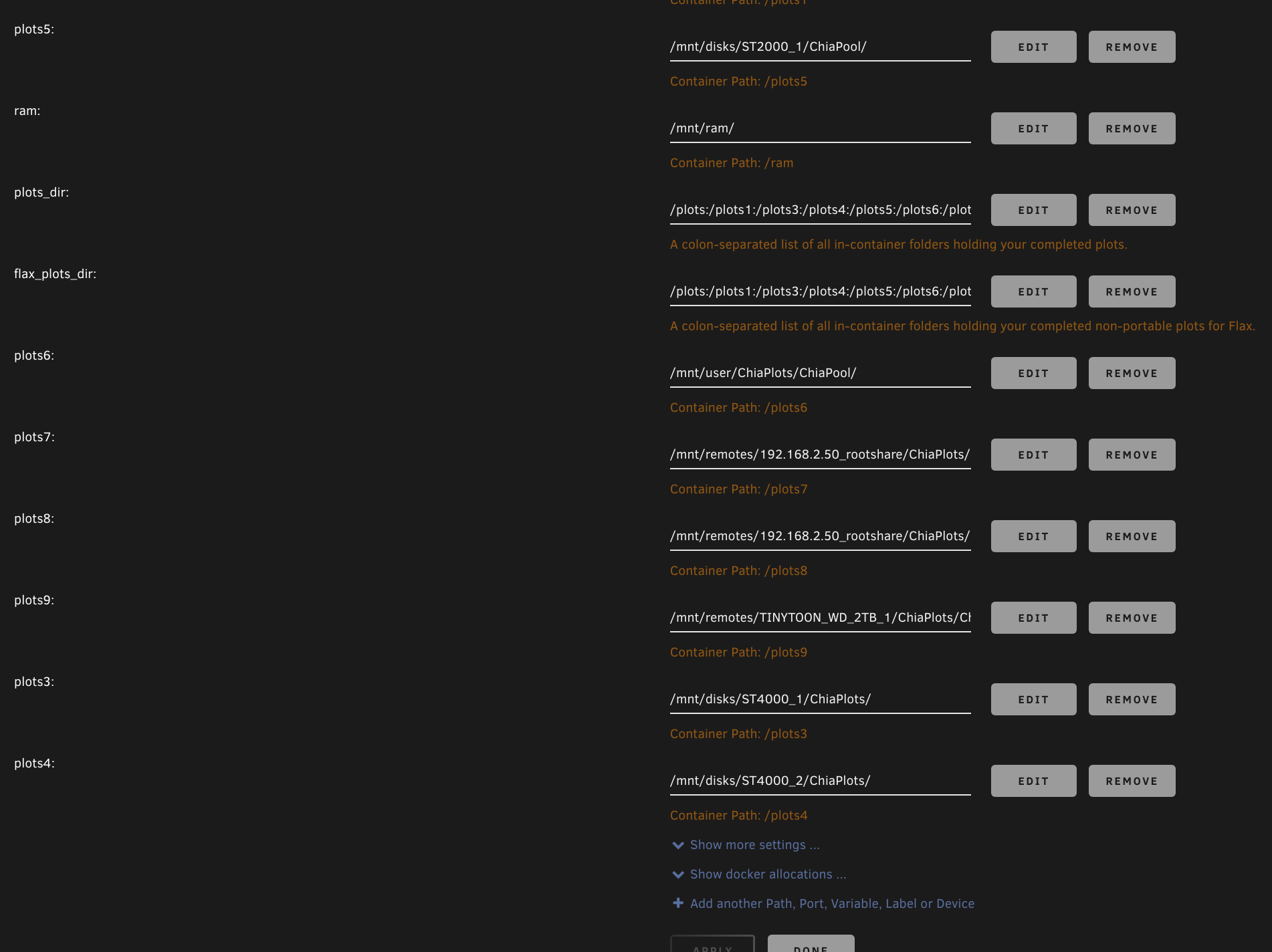

Sorry not sure exactly how to do that - tried to just select and copy but it didn't copy a lot of the fields.  Is there a way to export or do I just need to make screen grabs?
1108124752_ScreenShot2021-10-06at1_19_53PM.thumb.png.4202d535727c8980a4b4c87a5383f638.png1519326900_ScreenShot2021-10-06at1_20_10PM.thumb.png.d85165fc65d388e36b71ca092059441c.png1279942592_ScreenShot2021-10-06at1_20_26PM.thumb.png.7e7326b9db0cc33aab8cdbae113fe516.png1192608023_ScreenShot2021-10-06at1_20_35PM.thumb.png.382623c298a9d0e02c4f4f95711f05e2.png
Edited by Ystebad
Ok, yes the CA templates for your v0.5.7 Machinaris container are contaminated with settings from upcoming v0.6.0 Machinaris (currenly in development) with fork support.  To fix, simply Remove the following from your config shown:
* rpc_port
* protocol_port
* worker_api_port
* worker_host
* controller_host
Then click Apply and the Machinaris container should restart.
My apologies for the inconvenience.  I am still learning the ins and outs of Unraid application templating.
Yes that fixed it thank you!

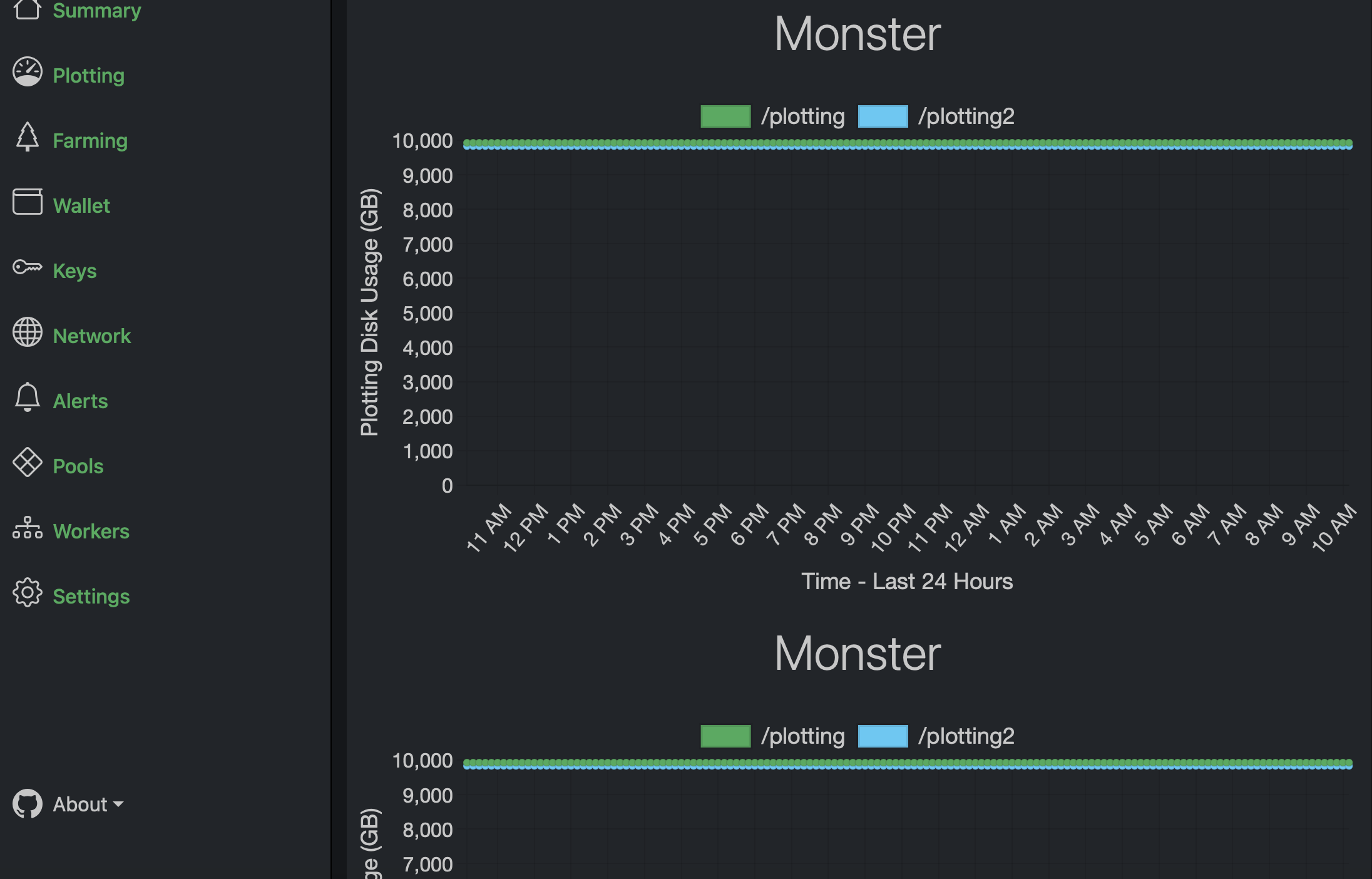

However under plotting and workers I now see two different choices with with same name.
Want to start plotting again, but unsure if I should or which one to select.
1596983399_ScreenShot2021-10-08at10_09_58AM.thumb.png.fdb9224f46b1c3ec62fb7f5d4a43c5cd.png1029361484_ScreenShot2021-10-08at10_10_16AM.thumb.png.4a1f0250f4c8dc708b2b1f6beba1bc68.png
Edited by Ystebad
Hi, there is likely a stale worker left on the Workers page.  Please visit the page and Prune both.  Don't worry if things vanish for 10 mins or so.  The "real" one will begin to re-populate status shortly leaving only one Worker behind.  Hope this helps!
