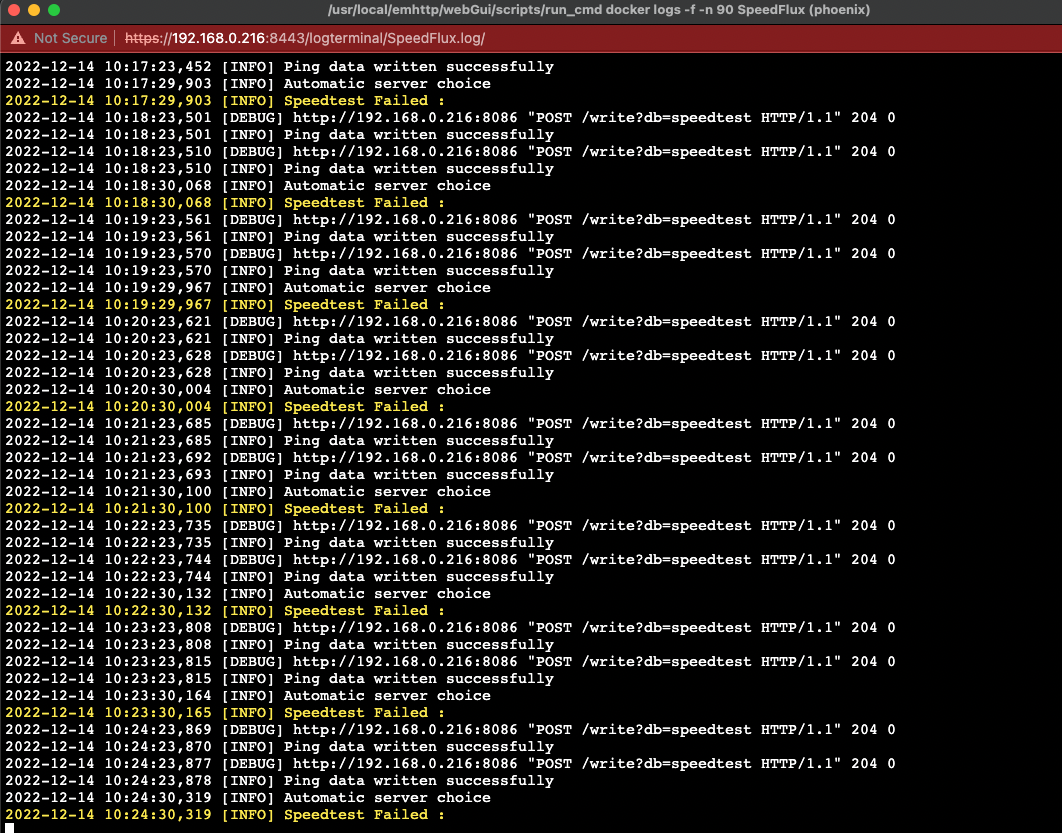

December 14, 20223 yr Anyone still have this docker working, I was using speedtest-tracker it started failing tests. Tried to set this one up and I continue to have "Speedtest Failed" messages in the logs. I have been able to console into the container and manually run a speed test though.
June 24, 20233 yr On 12/14/2022 at 7:25 AM, snowmirage said: Anyone still have this docker working, I was using speedtest-tracker it started failing tests. Tried to set this one up and I continue to have "Speedtest Failed" messages in the logs. I have been able to console into the container and manually run a speed test though. you figure out your issues? this has been working for like a charm for the past year + feeding data to my influxdb and all of a sudden i'm getting the speedtest fail log message edit i seem to be getting ssl errors - still digging edit sounds like this might be related to the underlying docker framework update in 6.12.1 ... based on some errors from another similar docker Edited June 24, 20233 yr by SeattleBandit
