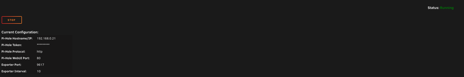

I am not running keepalived. They are individual instances of PiHole with both designated in my DHCP scope.
You can basically put the start command in the go file as long as the instance is already up when you start unRAID.
What you can also do is that you write a custom cron script or a script that runs on boot like this:
#!/bin/bash
echo "prometheus_pihole_exporter \
  -pihole_api_token YOURTOKEN \
  -pihole_hostname IPFROMTHEPIHOLEINSTANCE \
  -pihole_protocol http \
  -pihole_port WEBUIPORTFROMPIHOLEINSTANCE \
  -port PORTWHERETHEEXPORTERRUNSON \
  -interval 10s" | at now
YOURTOKEN= The token from the other PiHole instance
IPFROMTHEPIHOLEINSTANCE= The IP from the second PiHole instance
WEGUIPORTFROMPIHOLOEINSTANCE= The port for the WebGUI - usually 80
PORTWHERETHEEXPORTERRUNSON= Something like 9618 - important that it is a different port than the plugin runs on (9617) and you have to insert this as a new target to your prometheus.yml
Hope this makes sense, please keep in mind that I don't designed the plugin supports more than one instance at a time but with this in the go script or a cron job at start from unRAID this will totally work.
(You can also put 'sleep 30s' after the line '#!/bin/bash' so that the execution will 30 seconds delayed after the script is called)
I never tried this but it should work fine too. :)
Note: If you put this in the go file you don't need the line '#!/bin/bash'
