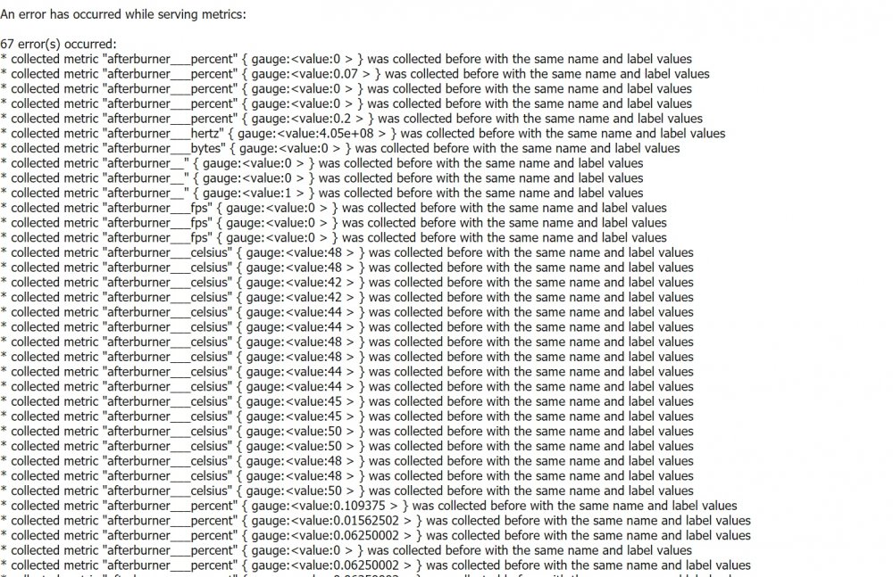

@ich777 Sorry again , i founded what was a problem in afterburner remote server .
updated to MSIAfterburner.NET.dll 1.1.1.0 from
(This library was updated to resolve an issue where a large number of monitors (40+) would result in an 'Access Denied' error.)
So now i can enter to server by http://192.168.0.101:82/mahm to see XML ... on my main comp and also tryed on firefox docker on unraid.  also by netstat i see :
 TCP    192.168.0.101:82       192.168.0.199:36044    ESTABLISHED     4

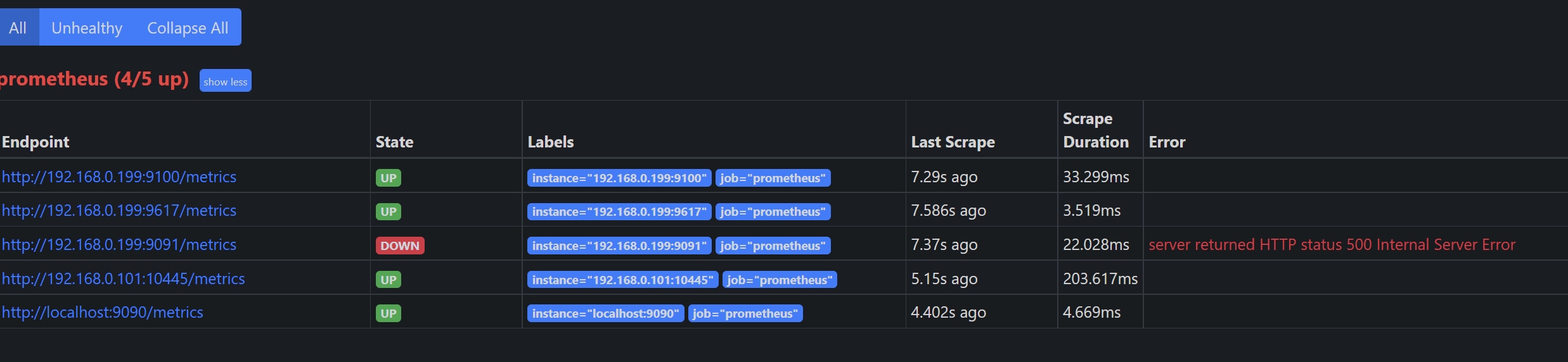

but prometheus http://192.168.0.199:9091/metrics is down

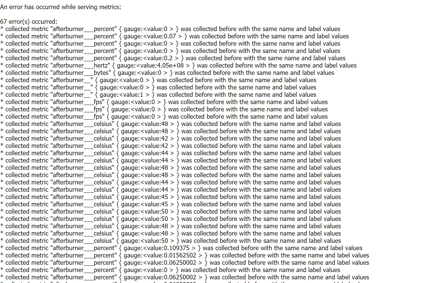

(server returned HTTP status 500 Internal Server Error)and give 67 errors like :
collected metric "afterburner___percent" { gauge:<value:0.02 > } was collected before with the same name and label values
Maybe you know somethink about it ?

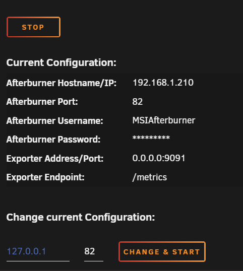

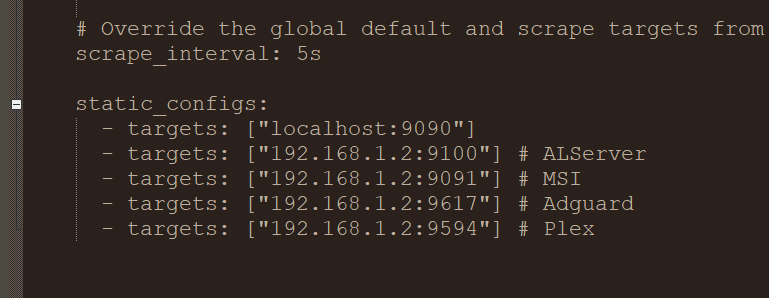

@Masterwishx where are you getting these errors now ?
plugin settings looks like ?
prometheus.yaml looks like ?
result in targets section in prometheus looks like ?

Like i sad :
( So now i can enter to server by http://192.168.0.101:82/mahm  to see XML data  on my main comp and also tryed on firefox docker on  unraid.  also by netstat i see :    TCP    192.168.0.101:82       192.168.0.199:36044    ESTABLISHED     4)
but no XML data on  http://192.168.0.101:82 ,but this setting i have in afterburner export plugin.
befor that was connection closed evey time and try again ,so it was problem of old MSIAfterburner.NET.dll 1.1.0.0.
and more that 40 monitor units.

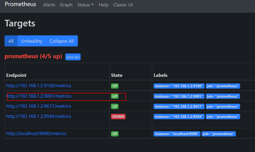

so now i have STATE is Down on  prometheus http://192.168.0.199:9091/metrics like in you last picture but is on.
and a lot of errors in /metric file ...
I think something is very wrong here, seems like the Prometheus Docker can't connect to the Afterburner exporter that runs on your Server.
From what I see in the screenshot you experience a http 500 error from the exporter itself, but I really can't tell why.
Really can't help here... I'm out of ideas...
