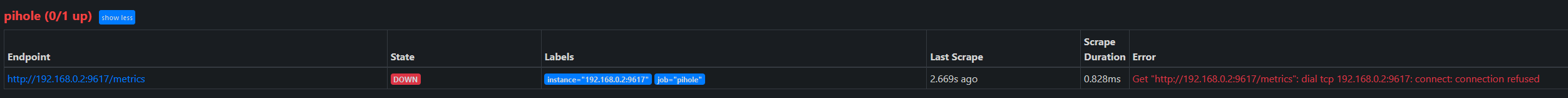

Just installed the plugin on the target Unraid system and pointed the YAML on the main system to the target. Fails with "context deadline exceeded". Every mention I've seen of this is that it's either a timeout problem (not in my case) or it's related to a docker change. Now, I'm running this as a plugin but does the plugin still use the docker bridge?
Any other ideas for fixing this? Direct access to the metrics page works fine.
About what Prometheus plugin are we talking about here? Do you have a screenshot about the error?

I'm an old crusty IT guy and it doesn't make any sense to me either. This is the error I get from the Docker on the primary Unraid:337772225_ScreenShot2022-02-28at6_06_05PM.thumb.png.f5bb45a7e87ef288bd05f3ed27041c01.png
If I telnet to the primary Unraid and "curl http://172.16.172.30:9100/metrics" it just hangs indefinitely. If I "curl http://172.16.172.30:9100" I get an immediate response of the top level page with a link to the metrics page in the middle.
If I go to http://172.16.172.30:9100/metrics from my Mac mini, which is on the same network as the primary Unraid, I can browse to that, I can curl it, everything works.
If I telnet to the target Unraid and "curl http://172.16.172.30:9100/metrics" I get an immediate response. Not going to localhost, but the NIC's IP from itself.
So, it's like something on the Primary Unraid, at the system level, is unhappy with the html response from the /metrics page on the target.

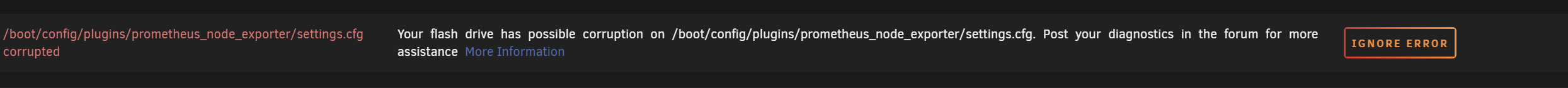

1. i have this error , after checked usb disk with windows check disk ,is it still here but no error on disk ,also posted message in fix common plugin page.
This is not really a error, have to tell @Squid about that.
Thanks, i wrote also to his plugin page and its fixed by update

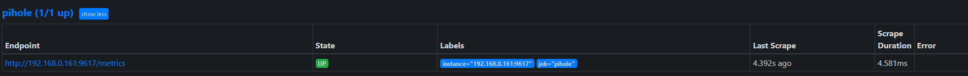

Hello @ich777,
i've set up pihole for unraid and it is running. I set the network type to "custom:br0" and gave pihole a fixed ip adress (192.168.0.2).
My unraids IP is 192.168.0.161
Now I installed your pihole exporter and enabled "Host access to custom networks" as mentioned by you. In the pihole exporter settings I set the configuration as below:
I added follwing lines to the prometheus.yaml:
- job_name: 'pihole'
    static_configs:
      - targets: ["192.168.0.161:9617"] # Pi-Hole
In Prometheus I can see that the pihole exporter is up and running:
But when I'm checking the metrics, there are no "pihole_*" metrics available. Instead there are the same metrics I get from the node exporter (i.e):
This is all that you've got from the exporter or is this just a part?
Have you waited a bit or is this right after you've connected to PiHole?
Are you sure that the API Key is right?
