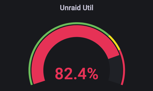

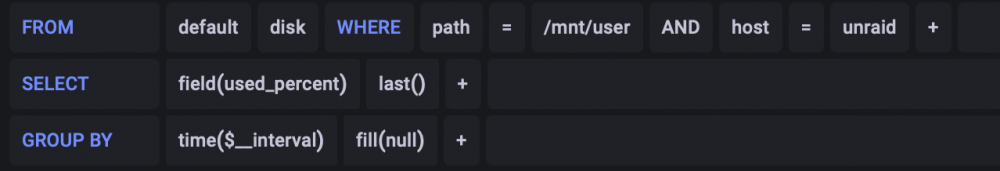

Is there an array space metric that I'm missing? I currently capture array used and total space through telegraph (I think) using "disk" and "/mnt/user" and pulling the space from there. Trying to move to Prometheus entirely.
I'm not entirely sure what you want to know here, you have to add all "diskX" to get the Array size.

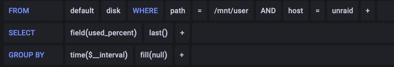

Currently have this in my dashboard: The query is pulling out of Influx.

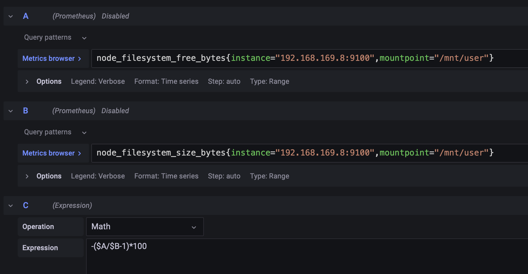

Not so concerned about Influx. I want to replicate this with the Prometheus plugin, if I can. I figured this out but it's only available bytes. I guess I can do a calculation with the total bytes.

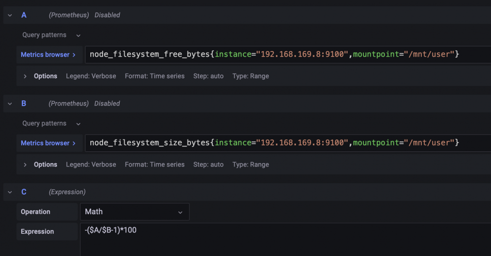

Took a little noodling but I got to where I wanted to be:
Wouldn't it be better to use /mnt/user0?
That should be actually the Array, or at least all disks without any cache drive.
You're probably right, but I'm going off of what I had before. I'll look at changing it.
