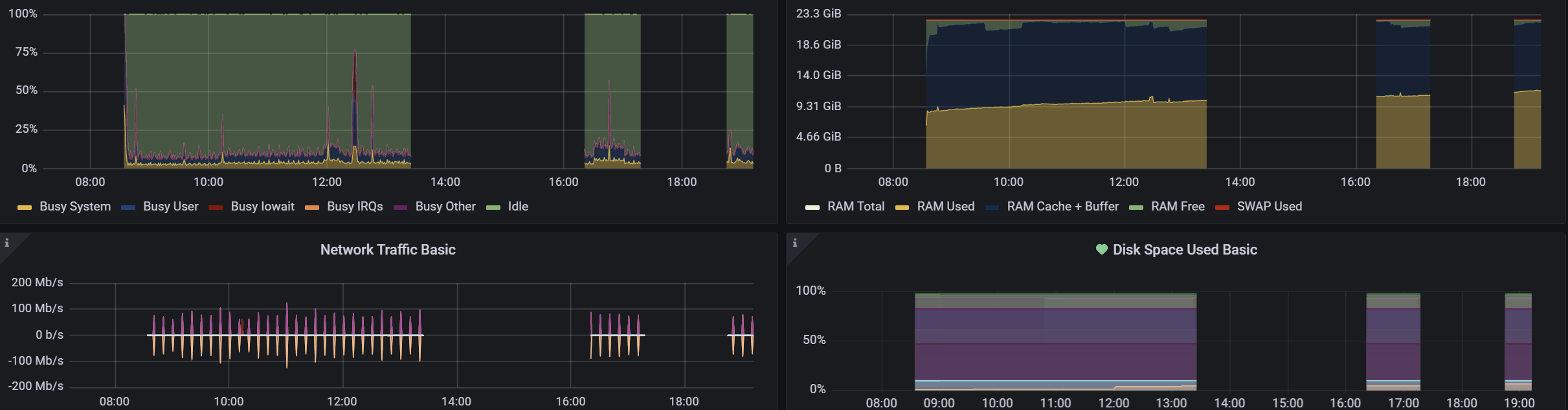

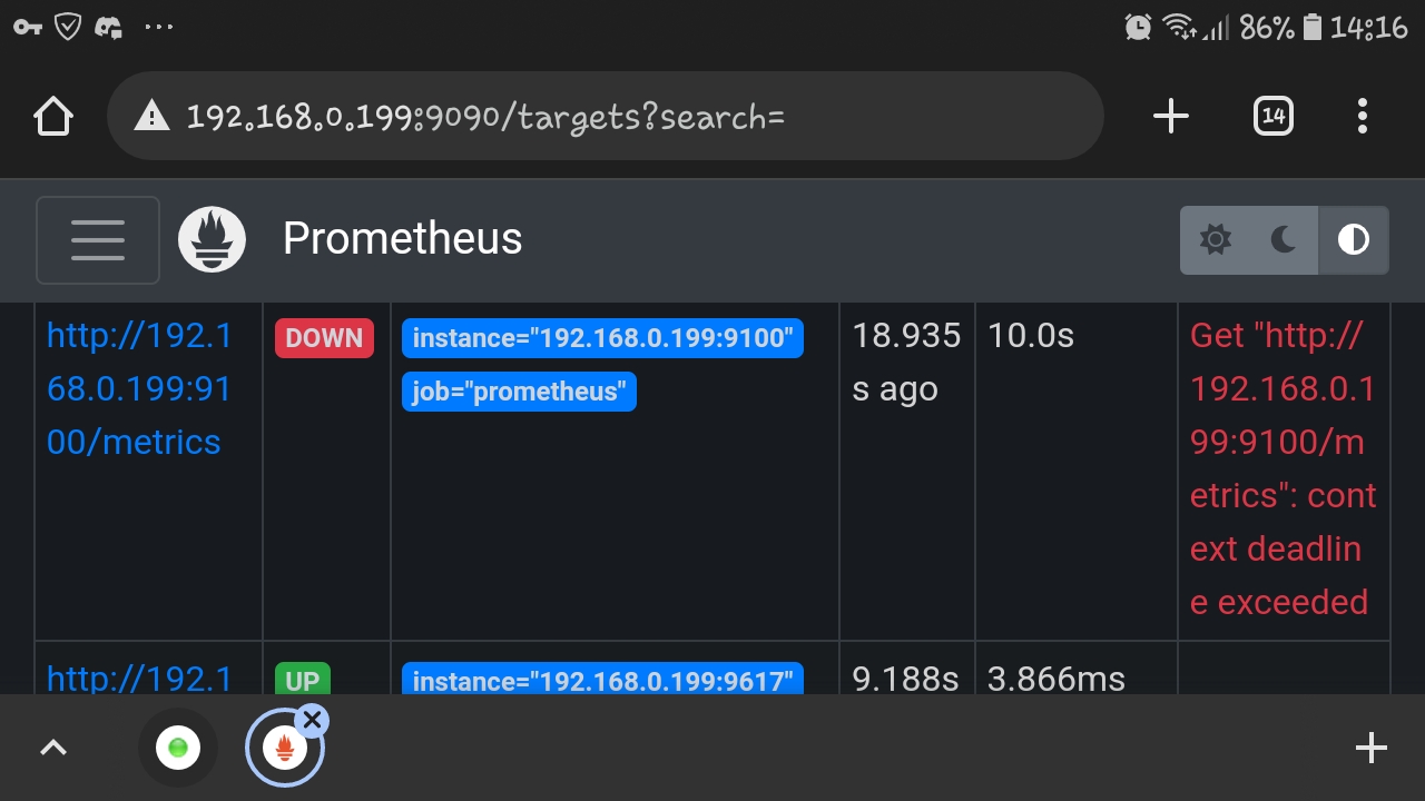

i have strang behavior of node exporter in grafana :
My server start in the morning in  8:30  then in 10:00 i power on my main comp and then from 13:30-16:30 and 17:15-18:45 it was switched of and this was afected somehow to node exporter ,there is no value in these times in grafana?!?
but im using http://192.168.0.199:9100/metrics on server for node exporter .
The only thing belong to my main comp that i have remote share on main comp that auto connected by script and not removed when main comp shut down so i have next line :
Is something on your PC running which maybe results in a IP conflict on your local network, that's my best guess...
Thanks for answer, do you mean server or main PC ?
Maybe the main PC does something that creates a IP address conflict... But that's only a guess...
i have adguard app on main comp but dont know how can affect when Main PC is off :(
also its not enabled for 192.168.0.199
aslo founded next when PC is OFF :
I really can't tell what's going on in your Network... This has to be some kind of network issue, otherwise it would work just fine.
Yes its worked fine befor ,  Thanks, i will try to find where the problem in network ...
Fixed by increasing to scrape_timeout: 15s from default but still need to find why scrape time up to 10s when main PC is offline ..

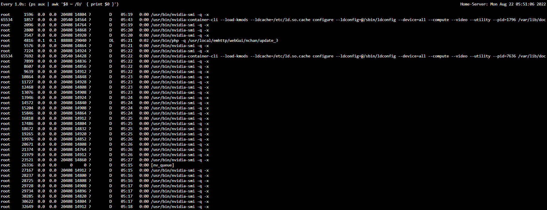

Has anyone had this problem?
I can tell if it's Nvidia Node exporter that's causing it, but I don't run anything else that runs that.
and I can't kill any of them without restarting the system because they're in uninterruptible sleep D state, it seems to massively slowdown my server.

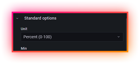

Just tried this out for pihole. Works great, but not with the original dashboard. Found this one on Grafana. https://grafana.com/grafana/dashboards/14283-pi-hole-exporter/ Works better, and has an option to select the datasource.
Edit: Had to change the % ads blocked from percentage 0.0 - 1.0 to 0 - 100

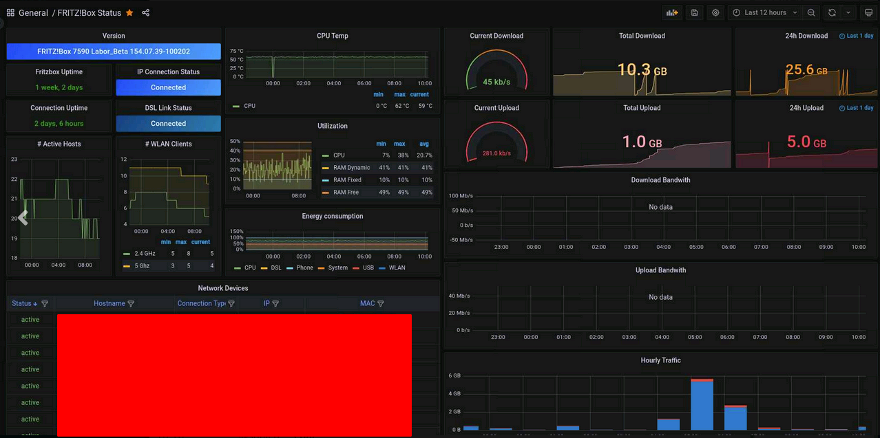

Hi, up until recent Fritzbox exporter plugin was working great. Now I am encountering issue. It shows no data on grafana. This is my metrics dump. Tried removing the plugin, reboot unraid and prometheus, even upgrading unraid, create new fritzbox user but the end result is the same.
# HELP fritzbox_exporter_collectErrors Number of collection errors. # TYPE fritzbox_exporter_collectErrors counter fritzbox_exporter_collectErrors 0 # HELP fritzbox_exporter_luaCollectErrors Number of lua collection errors. # TYPE fritzbox_exporter_luaCollectErrors counter fritzbox_exporter_luaCollectErrors 0 # HELP fritzbox_exporter_results_cached Number of results taken from cache. # TYPE fritzbox_exporter_results_cached counter fritzbox_exporter_results_cached{Cache="LUA"} 0 fritzbox_exporter_results_cached{Cache="UPNP"} 0 # HELP fritzbox_exporter_results_loaded Number of results loaded from fritzbox. # TYPE fritzbox_exporter_results_loaded counter fritzbox_exporter_results_loaded{Cache="LUA"} 0 fritzbox_exporter_results_loaded{Cache="UPNP"} 0 # HELP go_gc_duration_seconds A summary of the pause duration of garbage collection cycles. # TYPE go_gc_duration_seconds summary go_gc_duration_seconds{quantile="0"} 1.7308e-05 go_gc_duration_seconds{quantile="0.25"} 1.8979e-05 go_gc_duration_seconds{quantile="0.5"} 2.5063e-05 go_gc_duration_seconds{quantile="0.75"} 3.137e-05 go_gc_duration_seconds{quantile="1"} 8.1214e-05 go_gc_duration_seconds_sum 0.000982348 go_gc_duration_seconds_count 31 # HELP go_goroutines Number of goroutines that currently exist. # TYPE go_goroutines gauge go_goroutines 12 # HELP go_info Information about the Go environment. # TYPE go_info gauge go_info{version="go1.16.3"} 1 # HELP go_memstats_alloc_bytes Number of bytes allocated and still in use. # TYPE go_memstats_alloc_bytes gauge go_memstats_alloc_bytes 6.08772e+06 # HELP go_memstats_alloc_bytes_total Total number of bytes allocated, even if freed. # TYPE go_memstats_alloc_bytes_total counter go_memstats_alloc_bytes_total 8.441024e+07 # HELP go_memstats_buck_hash_sys_bytes Number of bytes used by the profiling bucket hash table. # TYPE go_memstats_buck_hash_sys_bytes gauge go_memstats_buck_hash_sys_bytes 1.454808e+06 # HELP go_memstats_frees_total Total number of frees. # TYPE go_memstats_frees_total counter go_memstats_frees_total 184622 # HELP go_memstats_gc_cpu_fraction The fraction of this program's available CPU time used by the GC since the program started. # TYPE go_memstats_gc_cpu_fraction gauge go_memstats_gc_cpu_fraction 1.1457694356162242e-06 # HELP go_memstats_gc_sys_bytes Number of bytes used for garbage collection system metadata. # TYPE go_memstats_gc_sys_bytes gauge go_memstats_gc_sys_bytes 4.931848e+06 # HELP go_memstats_heap_alloc_bytes Number of heap bytes allocated and still in use. # TYPE go_memstats_heap_alloc_bytes gauge go_memstats_heap_alloc_bytes 6.08772e+06 # HELP go_memstats_heap_idle_bytes Number of heap bytes waiting to be used. # TYPE go_memstats_heap_idle_bytes gauge go_memstats_heap_idle_bytes 5.9392e+07 # HELP go_memstats_heap_inuse_bytes Number of heap bytes that are in use. # TYPE go_memstats_heap_inuse_bytes gauge go_memstats_heap_inuse_bytes 6.9632e+06 # HELP go_memstats_heap_objects Number of allocated objects. # TYPE go_memstats_heap_objects gauge go_memstats_heap_objects 10750 # HELP go_memstats_heap_released_bytes Number of heap bytes released to OS. # TYPE go_memstats_heap_released_bytes gauge go_memstats_heap_released_bytes 5.9056128e+07 # HELP go_memstats_heap_sys_bytes Number of heap bytes obtained from system. # TYPE go_memstats_heap_sys_bytes gauge go_memstats_heap_sys_bytes 6.63552e+07 # HELP go_memstats_last_gc_time_seconds Number of seconds since 1970 of last garbage collection. # TYPE go_memstats_last_gc_time_seconds gauge go_memstats_last_gc_time_seconds 1.6655119393072672e+09 # HELP go_memstats_lookups_total Total number of pointer lookups. # TYPE go_memstats_lookups_total counter go_memstats_lookups_total 0 # HELP go_memstats_mallocs_total Total number of mallocs. # TYPE go_memstats_mallocs_total counter go_memstats_mallocs_total 195372 # HELP go_memstats_mcache_inuse_bytes Number of bytes in use by mcache structures. # TYPE go_memstats_mcache_inuse_bytes gauge go_memstats_mcache_inuse_bytes 9600 # HELP go_memstats_mcache_sys_bytes Number of bytes used for mcache structures obtained from system. # TYPE go_memstats_mcache_sys_bytes gauge go_memstats_mcache_sys_bytes 16384 # HELP go_memstats_mspan_inuse_bytes Number of bytes in use by mspan structures. # TYPE go_memstats_mspan_inuse_bytes gauge go_memstats_mspan_inuse_bytes 133960 # HELP go_memstats_mspan_sys_bytes Number of bytes used for mspan structures obtained from system. # TYPE go_memstats_mspan_sys_bytes gauge go_memstats_mspan_sys_bytes 147456 # HELP go_memstats_next_gc_bytes Number of heap bytes when next garbage collection will take place. # TYPE go_memstats_next_gc_bytes gauge go_memstats_next_gc_bytes 7.834448e+06 # HELP go_memstats_other_sys_bytes Number of bytes used for other system allocations. # TYPE go_memstats_other_sys_bytes gauge go_memstats_other_sys_bytes 1.65892e+06 # HELP go_memstats_stack_inuse_bytes Number of bytes in use by the stack allocator. # TYPE go_memstats_stack_inuse_bytes gauge go_memstats_stack_inuse_bytes 753664 # HELP go_memstats_stack_sys_bytes Number of bytes obtained from system for stack allocator. # TYPE go_memstats_stack_sys_bytes gauge go_memstats_stack_sys_bytes 753664 # HELP go_memstats_sys_bytes Number of bytes obtained from system. # TYPE go_memstats_sys_bytes gauge go_memstats_sys_bytes 7.531828e+07 # HELP go_threads Number of OS threads created. # TYPE go_threads gauge go_threads 13 # HELP process_cpu_seconds_total Total user and system CPU time spent in seconds. # TYPE process_cpu_seconds_total counter process_cpu_seconds_total 0.36 # HELP process_max_fds Maximum number of open file descriptors. # TYPE process_max_fds gauge process_max_fds 40960 # HELP process_open_fds Number of open file descriptors. # TYPE process_open_fds gauge process_open_fds 11 # HELP process_resident_memory_bytes Resident memory size in bytes. # TYPE process_resident_memory_bytes gauge process_resident_memory_bytes 1.9427328e+07 # HELP process_start_time_seconds Start time of the process since unix epoch in seconds. # TYPE process_start_time_seconds gauge process_start_time_seconds 1.66550893858e+09 # HELP process_virtual_memory_bytes Virtual memory size in bytes. # TYPE process_virtual_memory_bytes gauge process_virtual_memory_bytes 1.495437312e+09 # HELP process_virtual_memory_max_bytes Maximum amount of virtual memory available in bytes. # TYPE process_virtual_memory_max_bytes gauge process_virtual_memory_max_bytes 1.8446744073709552e+19 # HELP promhttp_metric_handler_requests_in_flight Current number of scrapes being served. # TYPE promhttp_metric_handler_requests_in_flight gauge promhttp_metric_handler_requests_in_flight 1 # HELP promhttp_metric_handler_requests_total Total number of scrapes by HTTP status code. # TYPE promhttp_metric_handler_requests_total counter promhttp_metric_handler_requests_total{code="200"} 218 promhttp_metric_handler_requests_total{code="500"} 0 promhttp_metric_handler_requests_total{code="503"} 0
Did you change something?
I got another report from a user which is on Unraid 6.11.1 and uses the latest version from the exporter that it works just fine:
I have managed to solve it. It was DNS issue. I didn't have fritzbox as my DNS server in unraid.
