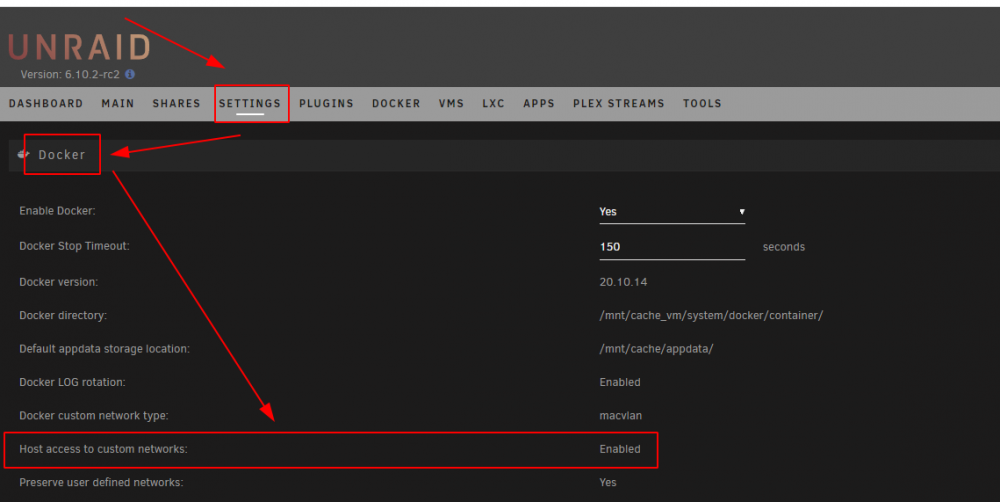

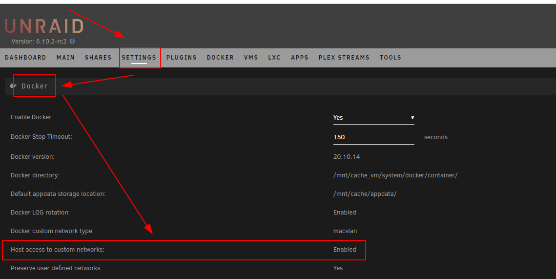

yes , and Host access to custom networks is enabled in Settings/docker

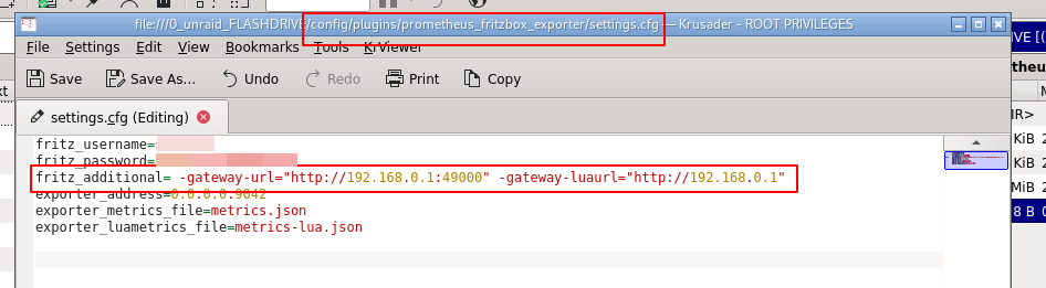

Open up the file /boot/config/plugins/prometheus_firtzbox_exporter/settings.cfg and edit the line where it says "fritz_additional=" so that it looks like:
fritz_additional=-gateway-url http://YOURIP:49000 -gateway-luaurl http://YOURIP
Of course insert the IP of your Fritzbox where it says YOURIP and stop the exporter first before doing this.

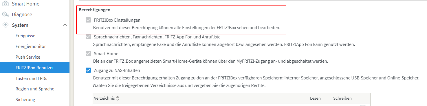

unfortunately it does not work for me. I followed your instructions for setting up the fritz box with a new user. is there a log I can check? when I start the plug in the status stays 'stopped'. thanks for your help [emoji120]
Gesendet von meinem SM-N986B mit Tapatalk

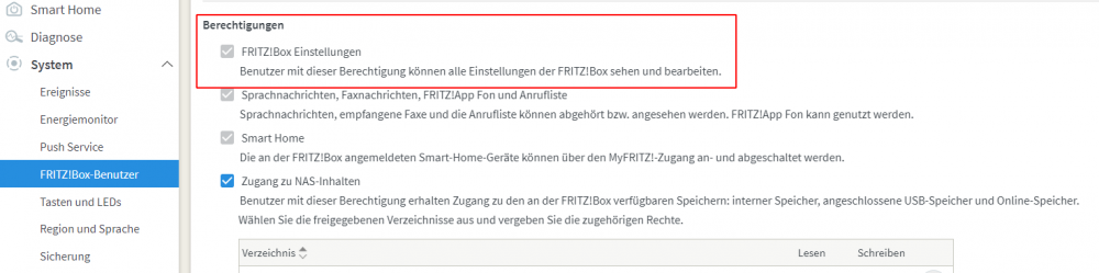

19 hours ago, shiz said:
unfortunately it does not work for me. I followed your instructions for setting up the fritz box with a new user. is there a log I can check? when I start the plug in the status stays 'stopped'. thanks for your help emoji120.png
You can try this:
and doublecheck username/password and user permissions:
even that upnp is activated

Hi, I can’t find the checkbox for enable host access.
Where do I find it?
At the moment I can’t access Pi-hole via the exporter.
Best regards,
Florian
Where do I find it?
3 hours ago, sonic6 said:
Found it, needed to activate advanced view. Thank you.

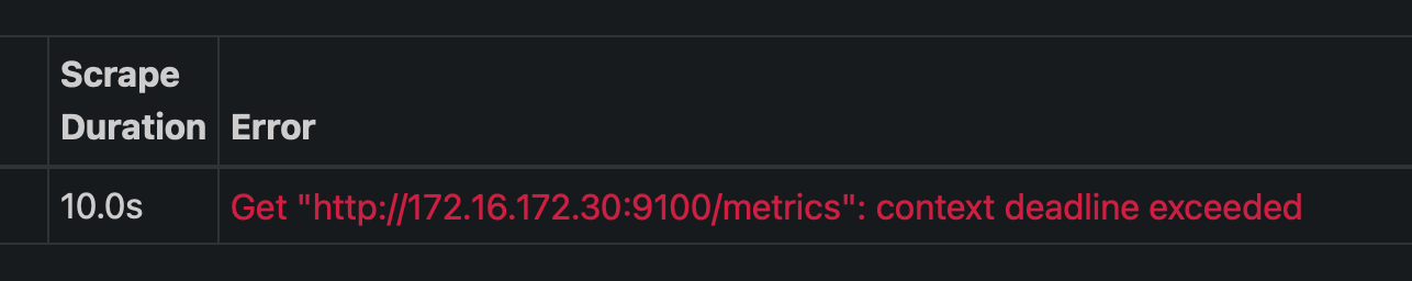

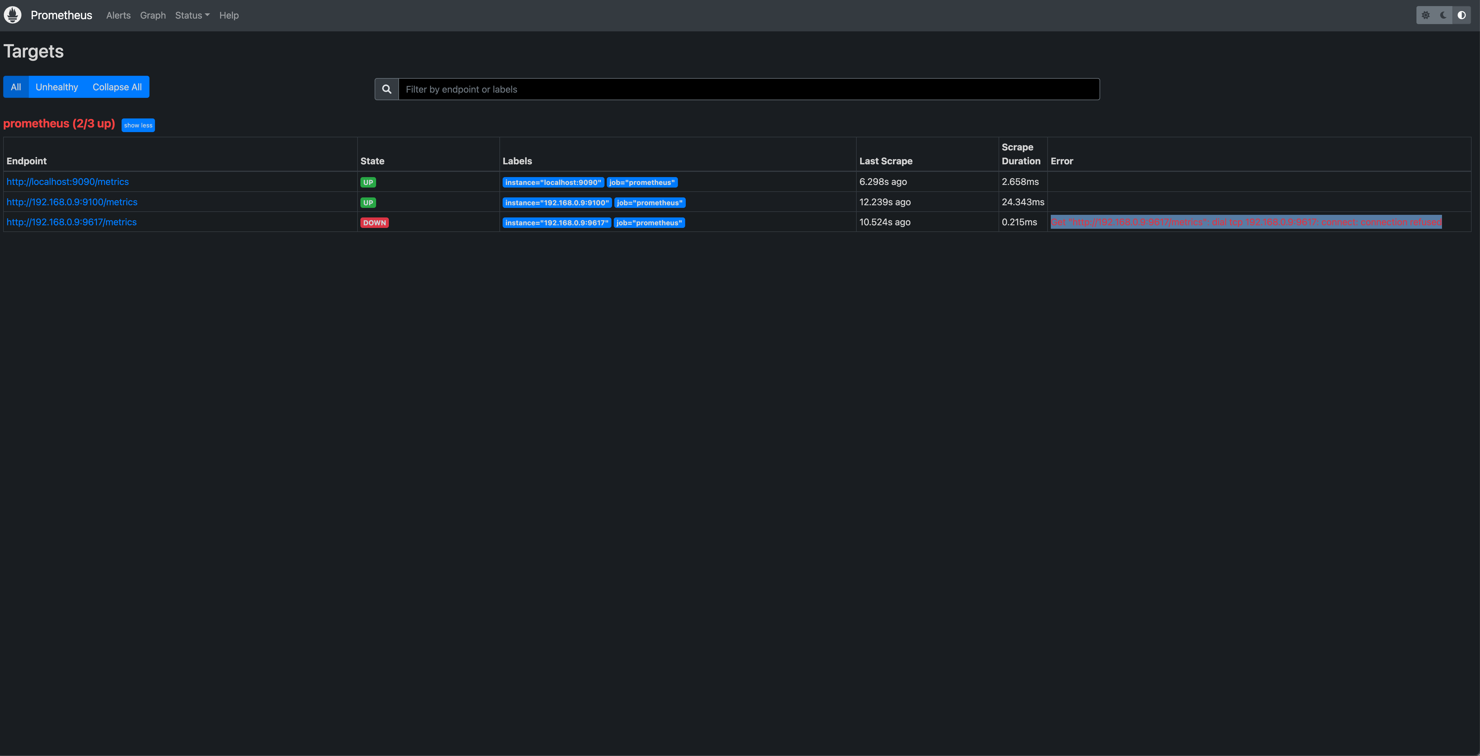

On 2/28/2022 at 6:41 PM, Bitbass said:
I'm an old crusty IT guy and it doesn't make any sense to me either. This is the error I get from the Docker on the primary Unraid:337772225_ScreenShot2022-02-28at6_06_05PM.thumb.png.f5bb45a7e87ef288bd05f3ed27041c01.png
If I telnet to the primary Unraid and "curl http://172.16.172.30:9100/metrics" it just hangs indefinitely. If I "curl http://172.16.172.30:9100" I get an immediate response of the top level page with a link to the metrics page in the middle.
If I go to http://172.16.172.30:9100/metrics from my Mac mini, which is on the same network as the primary Unraid, I can browse to that, I can curl it, everything works.
If I telnet to the target Unraid and "curl http://172.16.172.30:9100/metrics" I get an immediate response. Not going to localhost, but the NIC's IP from itself.
So, it's like something on the Primary Unraid, at the system level, is unhappy with the html response from the /metrics page on the target.
Upgraded to 6.10.3 on both systems and still having the problem. The primary is on a different subnet from the target, but the firewall that's in the middle isn't causing a problem for anything else. I can access the target metrics page from other systems next to the primary, and the primary can access an Ubuntu target at 172.16.172.31, right next to the Unraid target. When I curl from the primary Unraid cli to the target Unraid metrics page it just hangs indefinitely.
Is it possible something related to DNS is getting stuck? I have different "names" on each Unraid system, but the primary is simply called "unraid". I can't really change that. Is it possible the target is somehow responding with "unraid" to the query and the primary is getting confused and looking at itself? Maybe the target is trying to resolve "unraid" and getting confused. Could that be happening with the exporter plugin?
Not sure that's what's going on. Here's the output from the curl:
root@unraid:~# curl -v http://172.16.172.30:9100/metrics
*   Trying 172.16.172.30:9100...
* Connected to 172.16.172.30 (172.16.172.30) port 9100 (#0)
> GET /metrics HTTP/1.1
> Host: 172.16.172.30:9100
> User-Agent: curl/7.83.1
> Accept: */*
************hangs at this point and I quit out of it
^C
root@unraid:~# curl -v http://172.16.172.31:9100/metrics
*   Trying 172.16.172.31:9100...
* Connected to 172.16.172.31 (172.16.172.31) port 9100 (#0)
> Host: 172.16.172.31:9100
> Accept: */*
* Mark bundle as not supporting multiuse
< HTTP/1.1 200 OK
< Content-Type: text/plain; version=0.0.4; charset=utf-8
< Date: Mon, 20 Jun 2022 16:38:29 GMT
< Transfer-Encoding: chunked
*********** full normal scrape after this. I've truncated it.
Edited by Bitbass
From the target, pinging "unraid" does not resolve. Unless there's something hard coded into the node exporter plugin related to "unraid", I'm at a loss.
Try to restart the Docker service once or do a server reboot and see if it fixes the issue.
I've rebooted as part of the 6.10.3 upgrades on both sides, but I just restarted the Prometheus container on the primary and same result.
