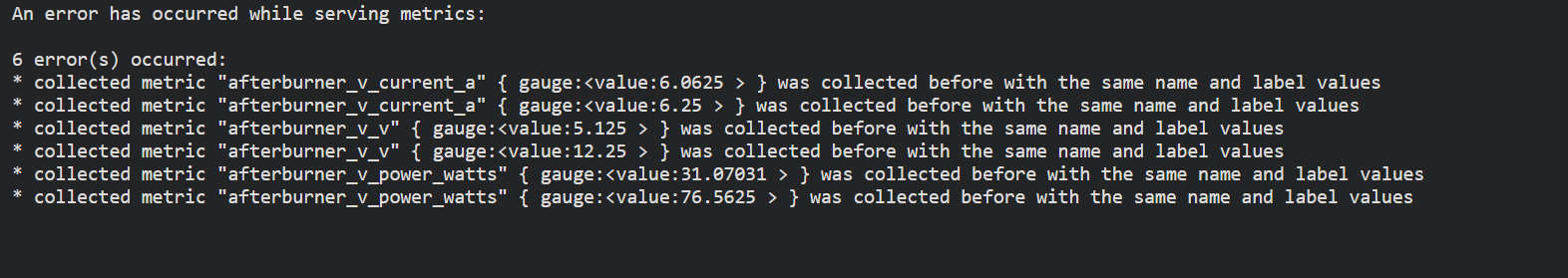

@ich777 i added some values (fans RPM,some Temperatures, etc) from HWinfo to Afterburner and they exported OK.
but the problem with Watts,Voltage,Current from PSU :
we have 3.3V - 5V - 12V and same for current and watts, but exporter export all tree units for same name afterburner_v_v
so we can choose only one of 3 units...
can it be fixed somehow maybe in afterburner setting? or its exporter problem ?
expoter dont take the name from afterburner ?
other staff added like temperatures and fans working well .
Seems like an issue with the exporter.
I would recommend that you‘ve report that over on the exporter GitHub Issue tracker over here.
i opened issue in github but its 2years old and mantainer not visible about half year.
but i fixed it by changing the name from +5v to five v (int to string) and its working ...

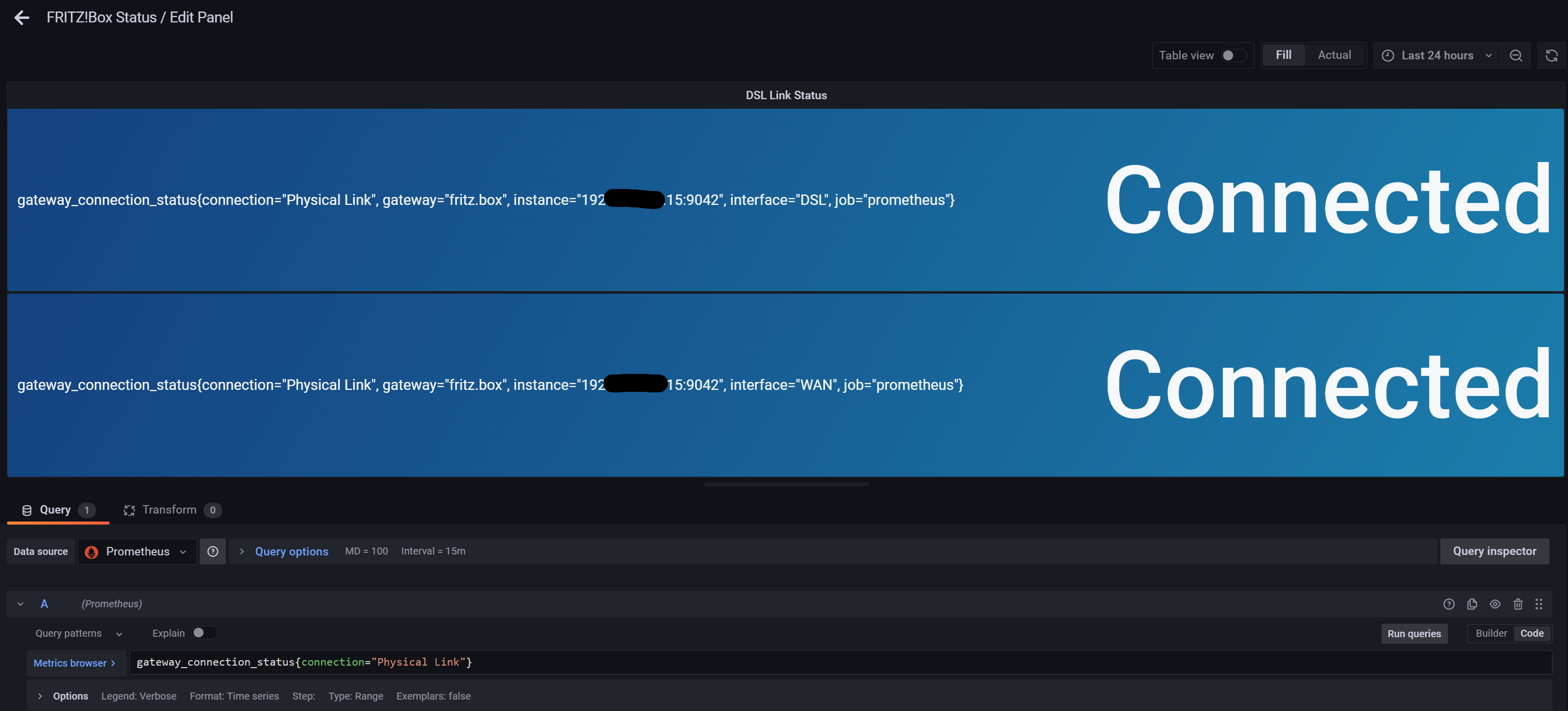

Hi there,
i was able to successfully install:
- nvidia-smi Exporter
- PiHole Exporter
- Fritzbox Exporter
Only Fritzbox Exporter (for my 7590) gives me a strange output regarding the DSL Link Status:
Any idea how to fix that? Thank you!
Edited by Civic1201

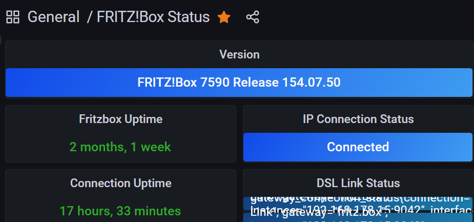

I don't have a Fritzbox but maybe @sonic6 or @alturismo know what to do?
i had to manuelly change something in grafana source for this tile when i used it, you know i switched to my HA Dash with my personal scripts ;)
@Civic1201
This is my source for DSL Link Status:
gateway_connection_status{connection="Physical Link"}
@sonic6
Here is a screenshot from the source:

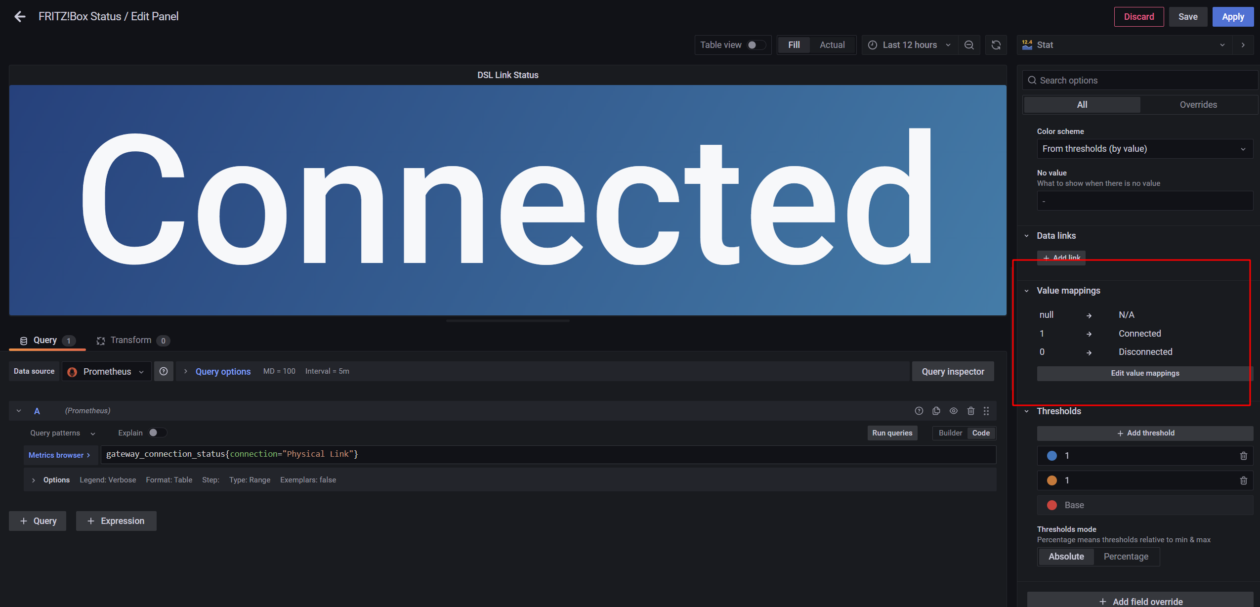

49 minutes ago, Civic1201 said:
@sonic6
What is shown here?
I have the same values like you:
I am running an Pi3+ as PiHole + entry in Fritzbox settings (if it´s important).
