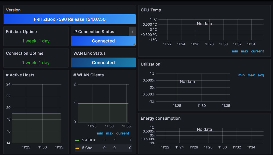

I got everything working except the Cpu, util. and energy metrics. Any idea why they dont show up? Fritzbox 7590 7.50
metrics.txt
