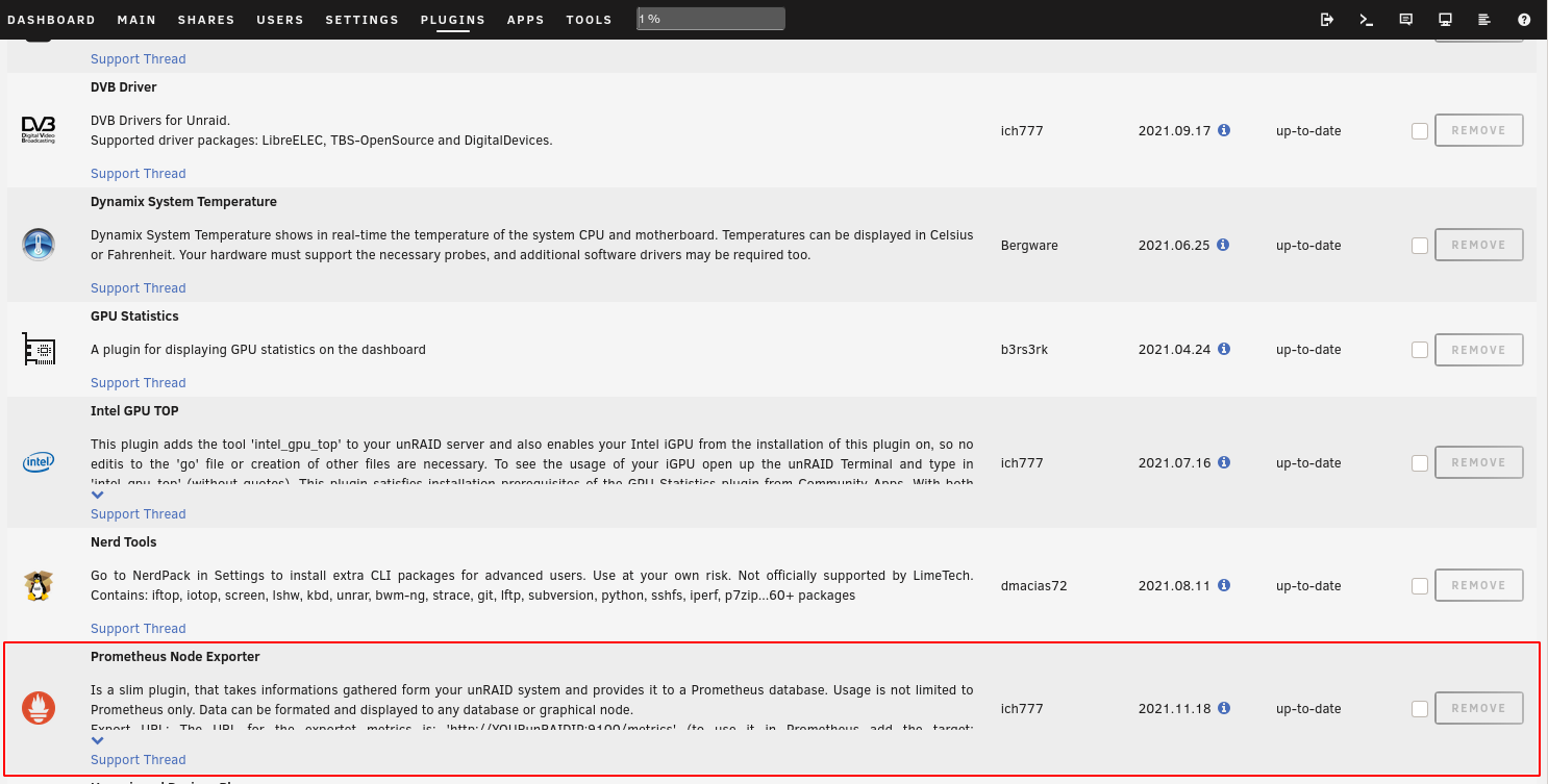

I've now tested it and it works as expected:
As you can see from the screenshot I have Docker also disabled and have the Prometheus Node Exporter running, here is also a screenshot from the output from the exporter:
I have also rebooted the machine to check if it is working as it should and it rebooted without an issue (test was done on 6.9.2 but I can also test it on another version from unRAID but this will make no difference).

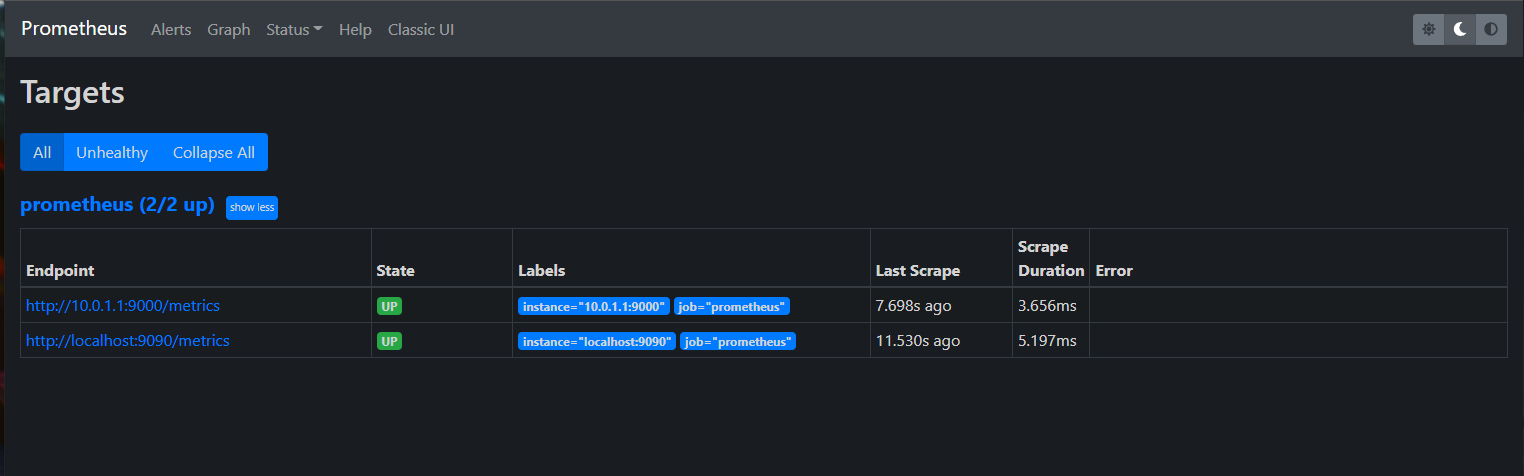

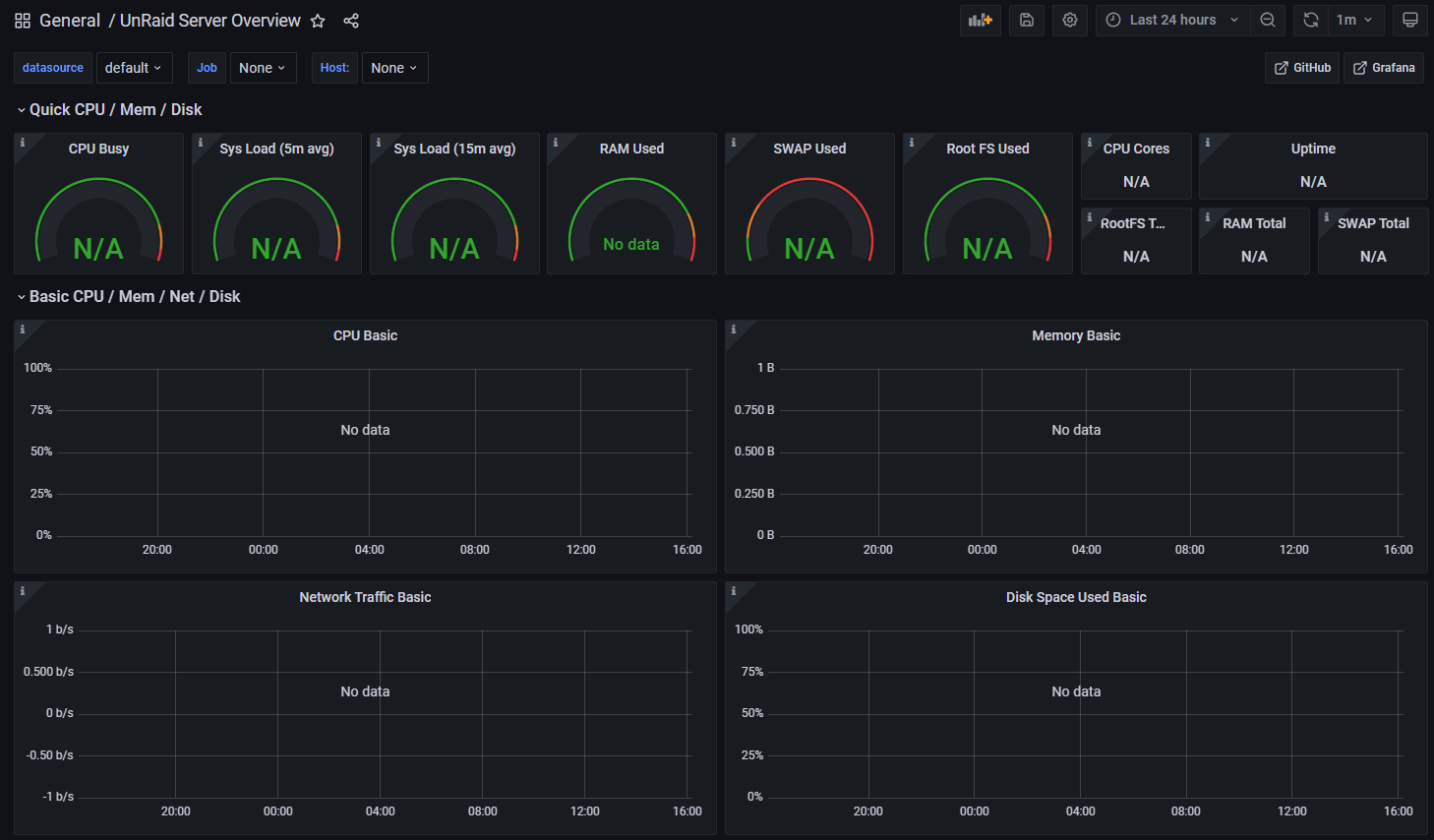

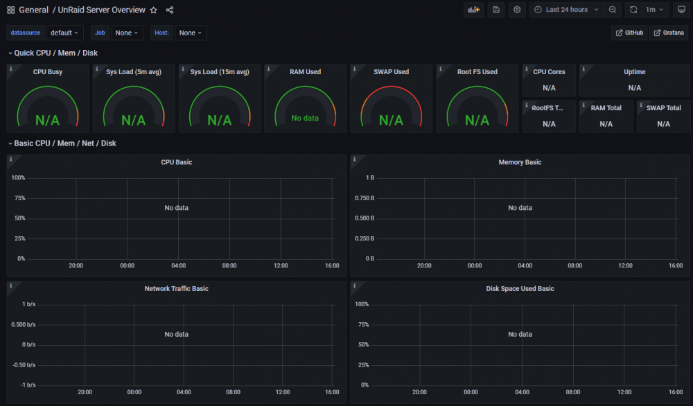

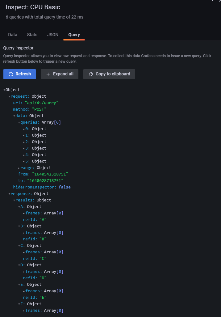

Hello ich777 et al,
I am having a little difficulty with generating the dashboard following the guide on the unraid blog.
I've followed the instructions on the blog but my Grafana dashboard doesn't display any stats:
The Prometheus target appears to be up and functioning according the target stats page and I am receiving an output from the /metrics endpoint:
I've restarted my server and let waited for Grafana to pick up the output from Prometheus for over an hour, any thoughts on what might be wrong with my setup?
Thanks in advance!
Edited by deadsix
Are you sure that you've picked the right data source? Have you also other sources in Grafana?

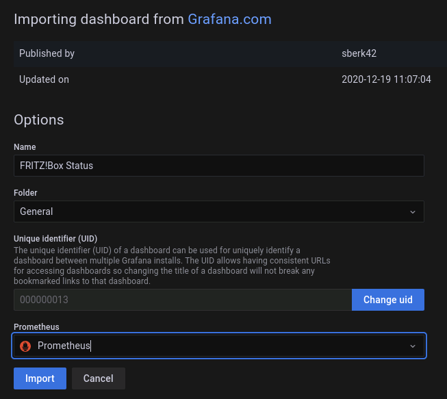

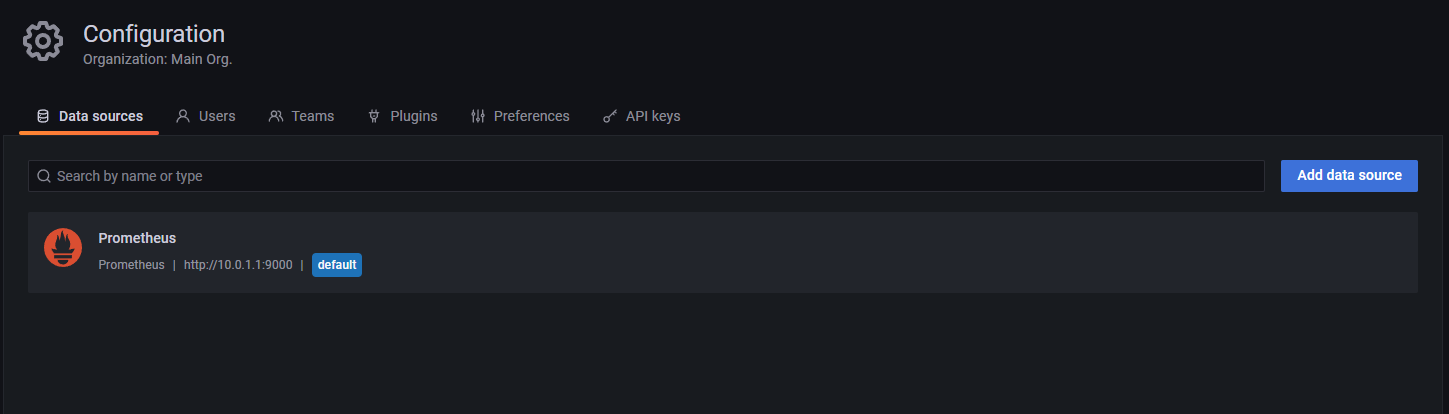

I believe so I've included screenshots of my configuration below.
I have no other sources and I received a 'Data source is working' response when I added the Prometheus data source seen below:

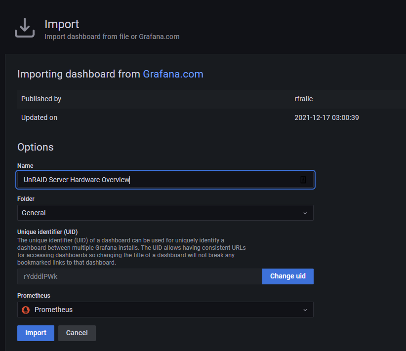

I am importing the dashboard to my local Grafana with the following options:
I think that's an issue with the Dashboard itself, can you go into a graph itself and manually changing the data source to Prometheus, I think a few pages back a user experienced a similar issue with another Dasboard who has had also another Data Source in Grafana.
I went into the dashboard and manually changed the data source to Prometheus, but the dashboard still isn't displaying any data. While I was poking around I did notice that the query inspector is stating that the response is empty:
Edit: I figured it out, it was a simple misconfiguration issue Prometheus didn't have the right target port in the YAML file. For others who may encounter issues the Prometheus Node Exporter is only on port 9100. Thanks ich777 for your help and great plugin!
Edited by deadsix

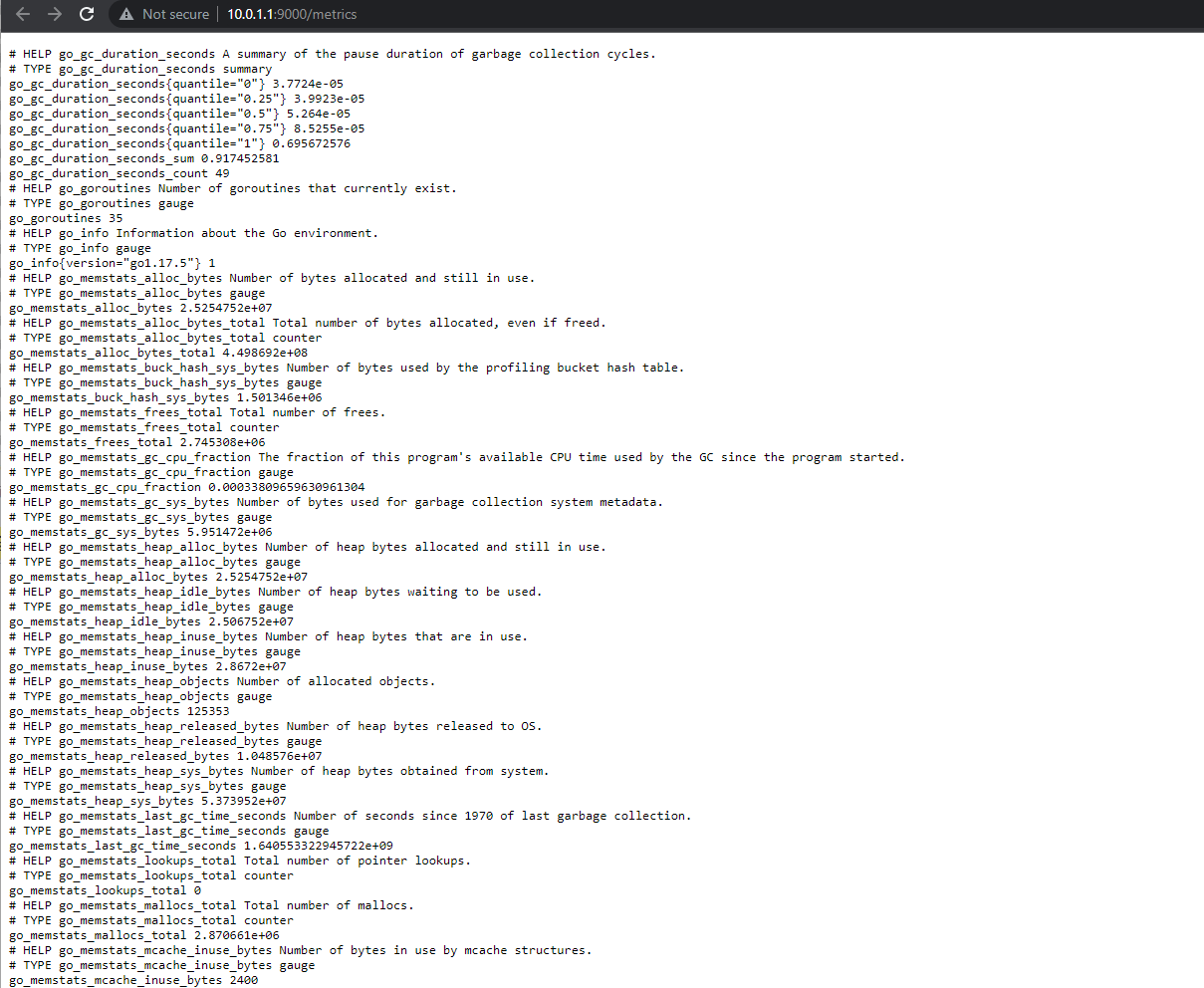

When I start the exporter and before it stops - I open the http://192.168.0.11:9617/metrics and it shows that data is feeding - if I refresh the page several times - lets say after 10-20 sec. it shows site as unreachable, at that time i check the exporter and it shows as stopped.
When the exporter is running, at the link there is data visible, but Grafana does load any data - maybe the time the exporter is running is not enough for the data to be collected and shown in Grafana, but as said when the exporter is running the link shows the data, before the exporter stops.
This may take a while to load the data in Grafana itself.

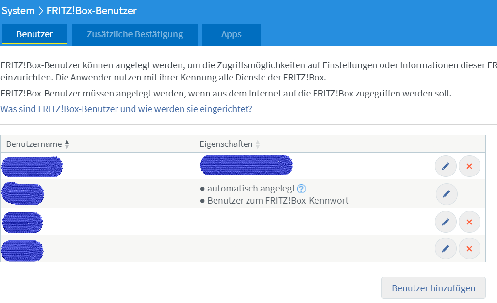

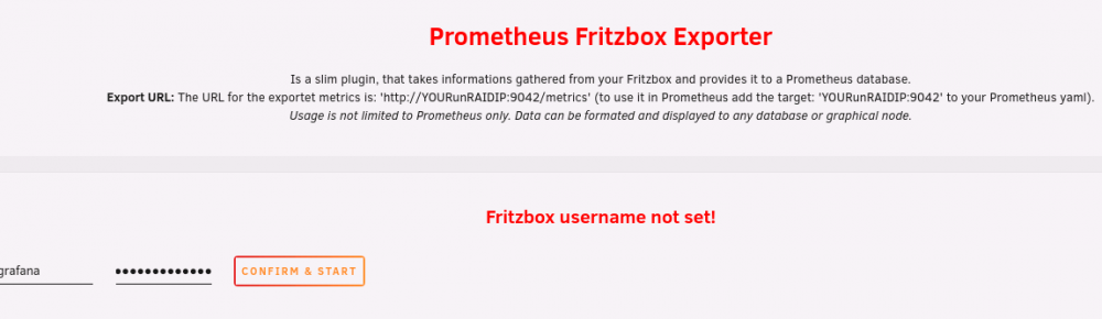

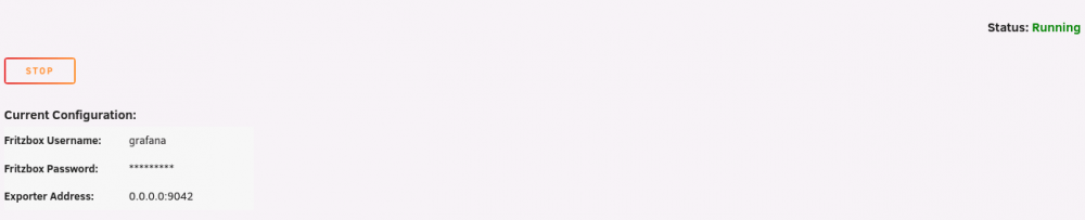

On 9/23/2021 at 11:03 AM, ich777 said:

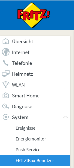

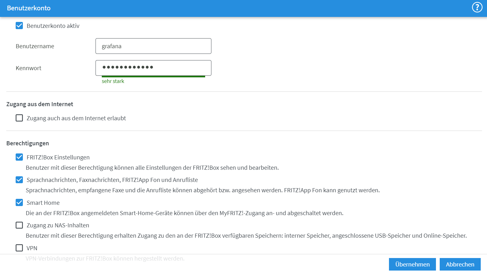

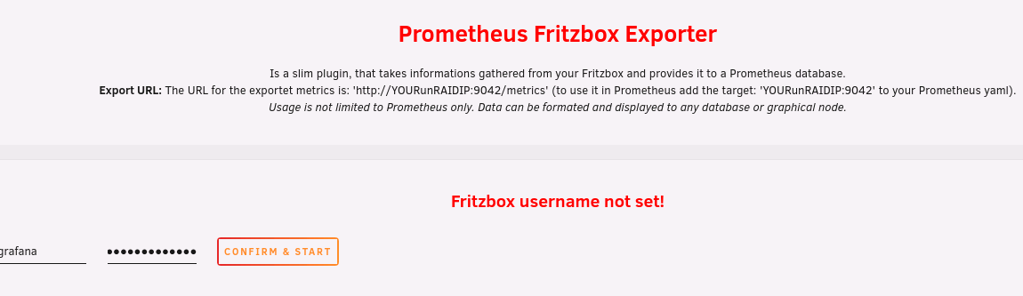

Prometheus Fritzbox Exporter
  1. Download and install the Prometheus Fritzbox Exporter plugin from the CA App:
  2. Log in to your Fritzbox and go to "System -> FRITZ!Box-Benutzer":
  3. Click on "Benutzer hinzufügen":
  4. Create a new user with a password for the exporter (in this example "grafana") and tick the following check boxes ("FRITZ!Box Einstellungen", "Sprachnachrichten, Faxnachrichten, FRITZ!App Fon und Anrufliste" & "Smart Home"):

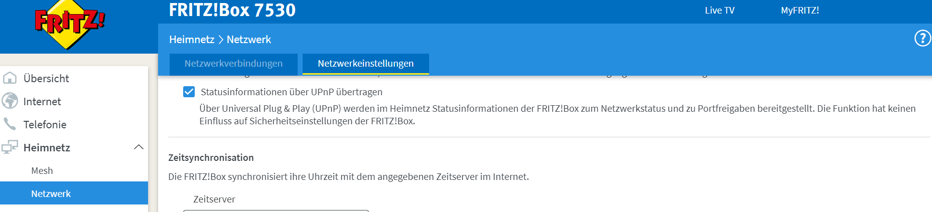

  5. Go to "Heimnetz -> Netzwerk -> Netzwerkeinstellungen" and select "Statusinformationen über UPnP übertragen":
  6. Go to the plugin settings by clicking on "Settings -> Fritzbox Exporter" (at the bottom of the Settings page) :
  7. Enter the username and password that you've created in Step 3 for the exporter in your Fritzbox and click on "Confirm & Start":
  8. After that you should see in the right top corner that the Exporter is running and details about it:
  9. Open up the prometheus.yml (Step 4 + 5 from the first post), add a line with '- targets: ["YOURSERVERIP:9042"]' (please change "YOURSERVERIP" to your Server IP), save and close the file:
  10. Go to the Docker page and restart Prometheus:

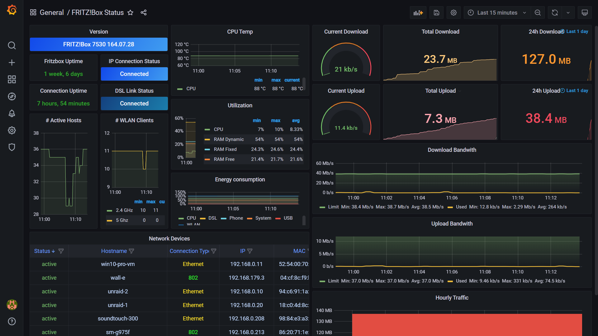

  12. Open up the Grafana WebUI:
  13. In Grafana click on "+ -> Import":
  14. Now we are going to import a preconfigured Dashboard for the Fritzbox Exporter from Grafana.com (Source), to do this simply enter the ID (12579) from the Dasboard and click "Load":
  15. In the next screen rename the Dashboard to your liking, select "Prometheus" as datasource and click on "Import":

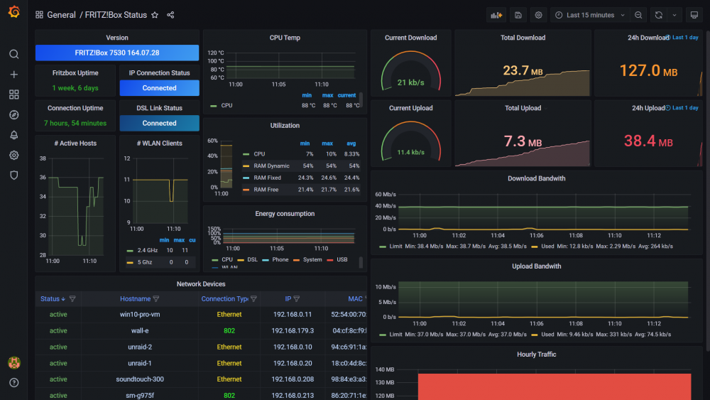

  16. Now you should be greeted with something like this (please keep in mind that the Dashboard can display N/A at some values, especially at the gauges, since there is not enough data available, wait a few minutes and you will see that the values are filled in):
This seems to be a nice plugin. But anyway I cant get it to work. Sadly. But anyway thank you for this!
