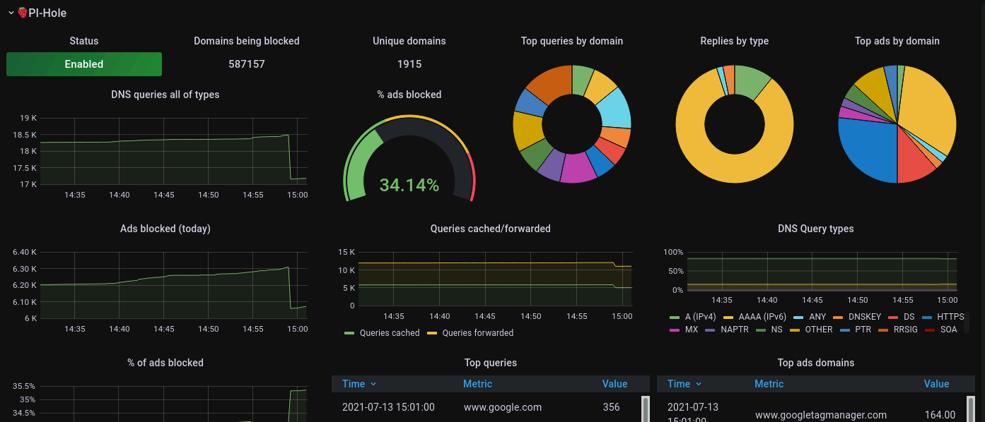

Just checked mine and it works fine:

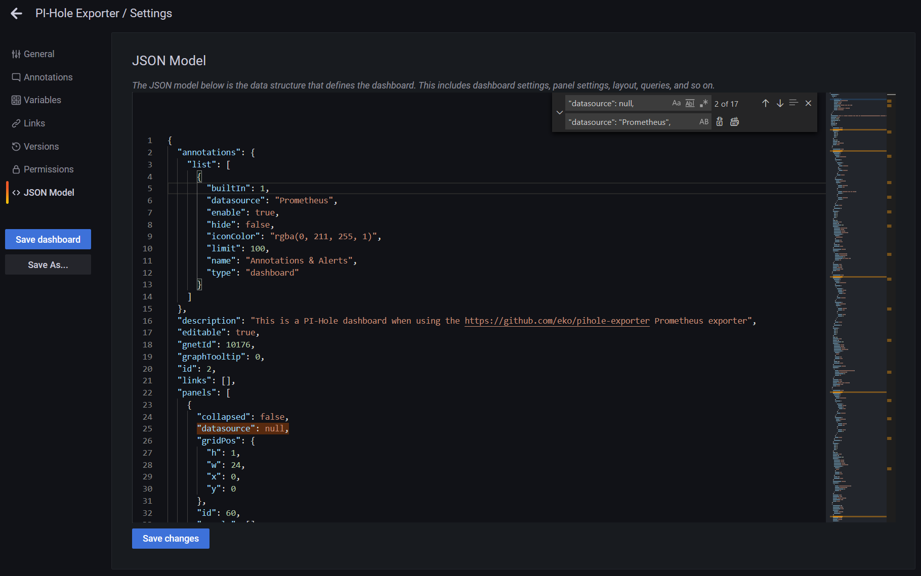

So I think I found the issue. After following your directions the Query inspector gives me the following: image.png.9267fae5c7ee06065999dc5c81a2e55e.png
But then I noticed that it is trying to pull from Telegraf:
I can change that to Prometheus and nothing happens still. I have deleted the dashboard a few times and dont see a place to enter what data source to pull from globally for the dashboard.
Any idea why it is selecting Telegraf instead of Prometheus for all of these?
Thanks again. You have been a big help

I think the main issue is that in the template is no Datasource defined and it takes always the first one that's available.
To fix this, at least I think, click on the Gear icon on the PiHole Dashboard, then click on JSON Model, press CTRL +F and click on the little down arrow and enter at the top:
"datasource": null,
and on the bottom:
"datasource": "Prometheus",
and then click on the second symbol in the second row to replace all occurrences and after that make sure that you click on Save changes and then also on the left side Save dashboard:
Please report back if it works.

Perfect! All is working now! image.thumb.png.7b10247c402fb4c7838086cfcc7c2f2b.png
