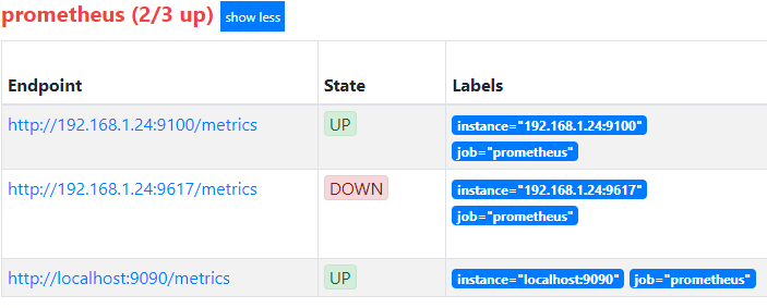

10 minutes ago, ich777 said:
Where did you see this message is the exporter not working?
here in the Prometheus targets:
The old GT 710 doesn't export a lot of metrics, but I've had other "good" cards that don't export 100% of metrics and return N/As, so I thought it was worth raising... but otherwise feel free to ignore :)

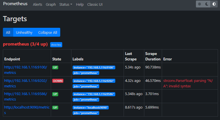

Will look into this...
I think my card also doesn't show everything, give me a few days please.

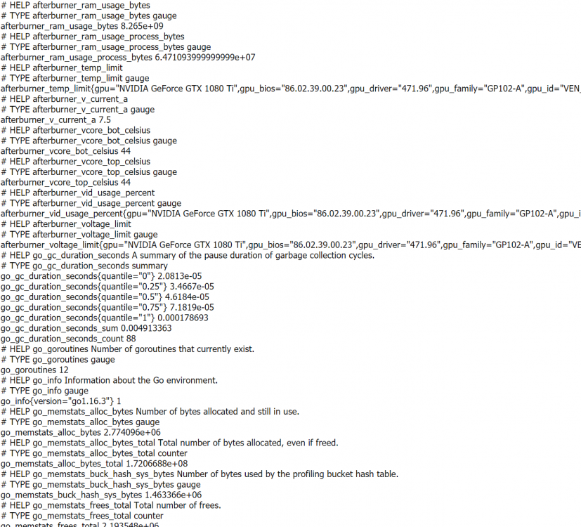

On 7/28/2021 at 5:36 PM, ich777 said:
I think something is very wrong here, seems like the Prometheus Docker can't connect to the Afterburner exporter that runs on your Server.
From what I see in the screenshot you experience a http 500 error from the exporter itself, but I really can't tell why.
Really can't help here... I'm out of ideas...
 Finally founded what the problem was in msi afterburner : the langue is russian    when changed to english was no error in prometheus ,but im getting next go staff...,    any ideas maybe ? prometheus is not supporting multilangues?
@ich777
after restarting MSI Afterburner in English i having some value of Afterburner and some of go...
how to fix it, any ideas maybe ? Sorry again for asking...
No problem, overlooked your post... sorry...
This looks fine to me and should not cause any issues.
What is the exact problem you have?
Is it possible for you to let the exporter run in English and edit the values or at least the Dashboard in Grafana to fit your needs?
i just checked again in graphana,  it was no data at all tables becose most of data was in deutch ,
so i changed to english metrics and all seems to be Fine .
i was worried that not values of msi afterburner was exported ,was in go format...
( # HELP go_memstats_next_gc_bytes Number of heap bytes when next garbage collection will take place. # TYPE go_memstats_next_gc_bytes gauge go_memstats_next_gc_bytes 6.080416e+06  )
but anyway all important metric is OK i think , i will stay in english MSI Afterburner for now .
Thank you for all your help again.
Can you update the Prometheus Nvidia Exporter plugin or install it again and see if it is working now?
The issue with N/A should now be solved.

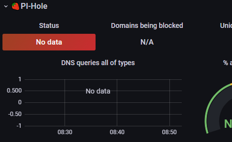

hi there,
I'm trying to set up the Pihole monitoring but am running into two issues:
the Pihole target goes down/stopped every 10 minutes or so:
and even while is up, I still get No Data in the Pihole Explorer even after updating the JSON model with the Prometheus source.
Where would I start looking for the cause?
thanks!
What does the Exporter plugin page tell you is it "Running" or "Starting"?
Do you restart PiHole, if so, keep in mind that if you restart PiHole the Exporter won't also stop and there is nothing I can do about this.
You've posted a screenshot where it shows that the Exporter is DOWN, have you seen it yet do display UP?
Are you running PiHole on unRAID?
thanks for y our reply.
yes, when I start the Explorer plugin it starts, runs for about 10 minutes and then it stops.
Pihole runs on Unraid.
Even with the services running, I dont get any data from the Pihole in Grafana:
