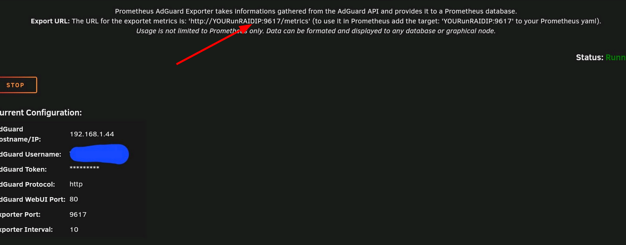

I have the ad guard exporter up and running, it starts just fine but I can't get it to work in Prometheus. The link is always down. I added the target to the yaml. I have other exporters up and they work with zero issues so not sure what the problem is.
Ad guard runs on a stand alone device with a static IP. I'm able to ping ad guard from unraid. The exported is running. It's added to the Prometheus yaml. The one thing I can't confirm is that I was told it might not work if there are special characters in the pass word, is this still a fact or is this a question better suited on the Prometheus support page? Any insight anyone can provide would be greatly appreciated
Special characters are still an issue.
Does the exporter page from the exporter itself display anything (IP:PORT/metrics in the description from the plugin)?

I'm not quite sure what you mean. Here is a snap shot of the exporter.
I've read that changing the password is a pain but I'll work through that and see if it makes a difference.
Is there any output if you visit the site?
Nope, states site can't be reached.
On the exporter plugin page it says Running correct?
If that is the case something fundamentally is not working.

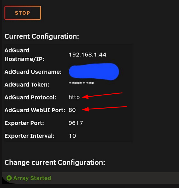

5 hours ago, ich777 said:
The exporter does state that it is running. Ad guard home is up and working. I'm going to uninstall everything and delete the folders reinstall and see if that fixes it.
Quick question, the exporter connects to ad guard home via port 80 or the 9617?
You see that right here in your screenshot:
