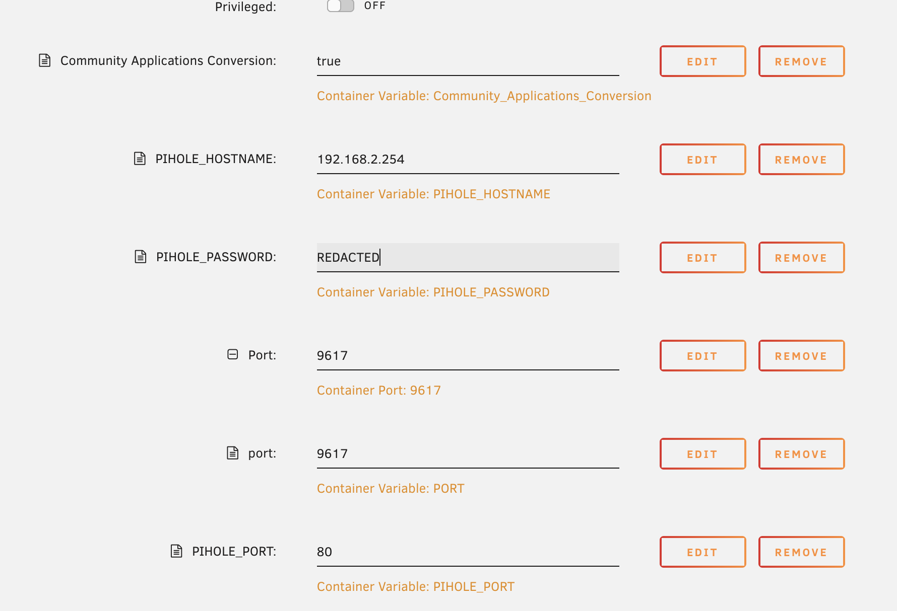

Hi, I've been trying to get pihole exporter working. I followed the ekofr docker but am seeing the error below. I've tried just the password and API key. Any pointers would be appreciated, thanks!
level=warning msg="An error occurred while contacting 192.168.2.254: error fetching stats summary: failed to parse authentication response: invalid character '<' looking for beginning of value\n"
I would recommend that you report that in his GitHub Repository, here is the Issue tracker.
