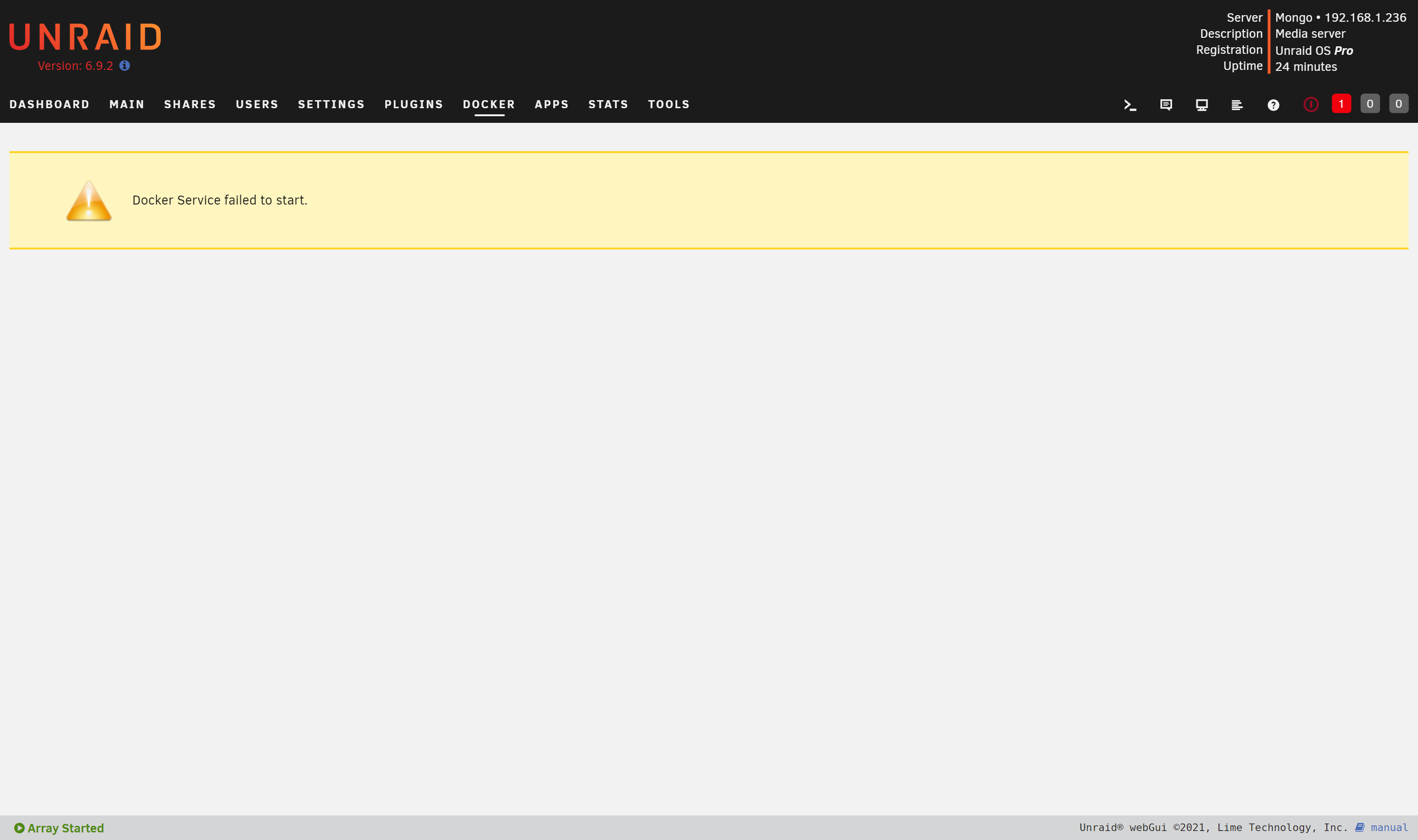

I upgraded unraid last week and have been running into issues with a few dockers not starting and not upgrading and then this happened. Can't get the docker service to start anymore. What can I do?

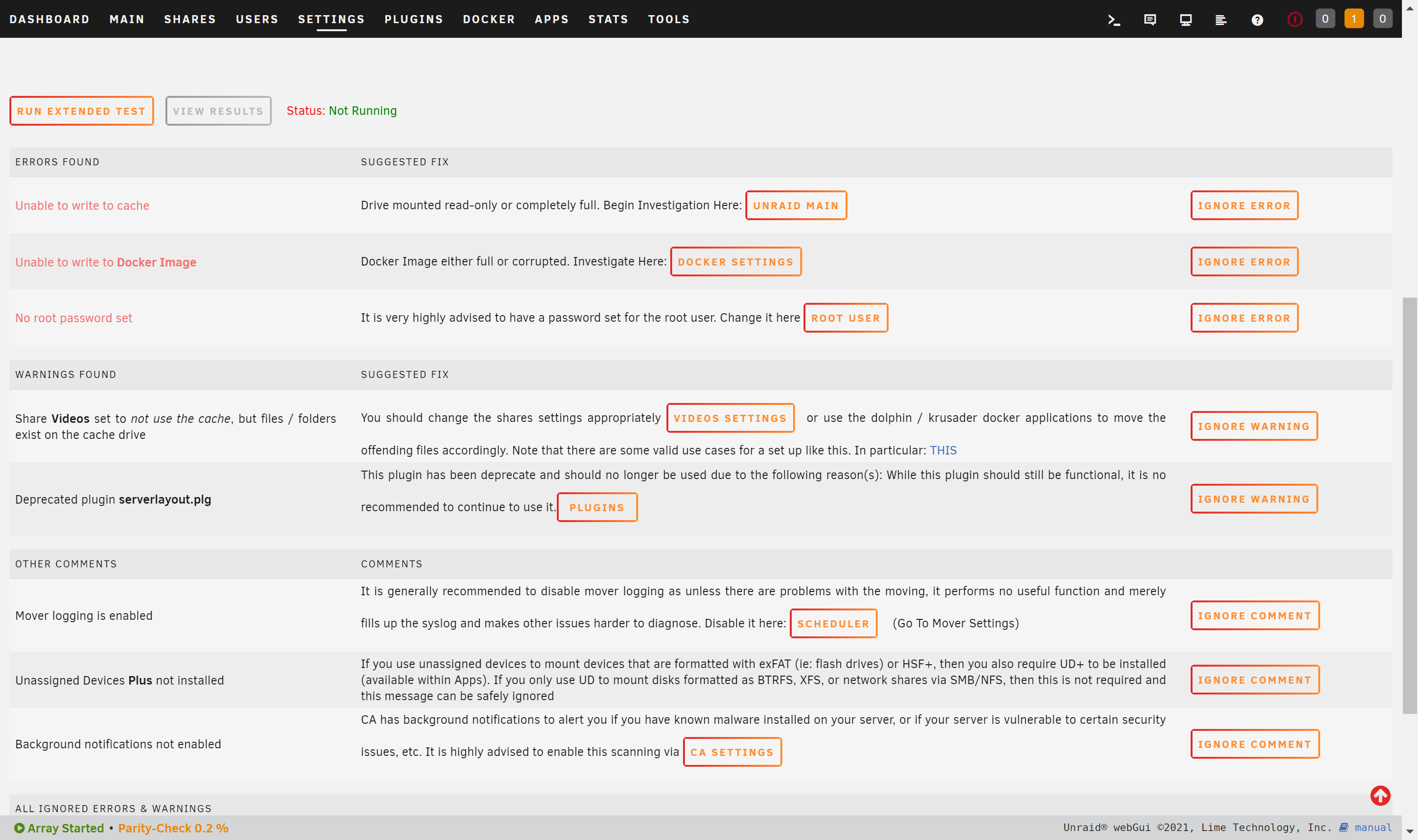

Looking at it now, it seems my cache drive is completely full.
You should move data from your cache.
Maybe your issue has to do with your video share ? Is it possible that videos are downloaded on cache and moved to "video" ? Since the mover does not consider files with cache set to NO, they might pile up.
In anycase, your diagnostics might help provide better advices. Go to Tools / Diagnostics and attach the full zip to your next post.
The System Notification should have alerted you of the cache pool getting past certain thresholds.
Is it not set up to send you emails or other type of messages ?

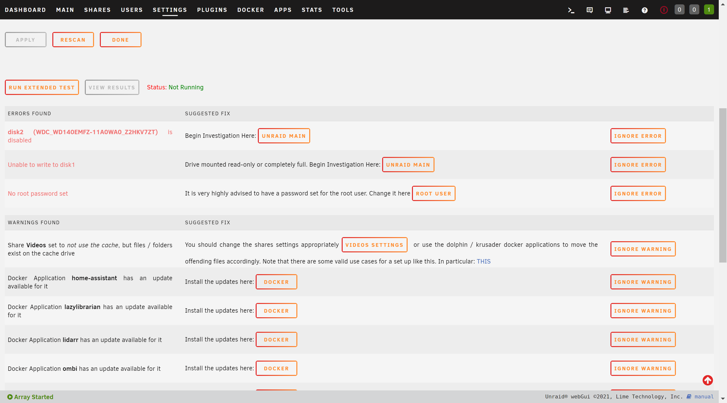

Now there's another new issue popping up, it says my disk 2 is disabled and stuck in read only or something.

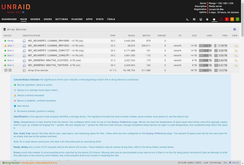

I'm doing a disk rebuild on that disabled disk, so I guess if that works fine, it's not that big of an issue.  Mostly just the mover not running now.

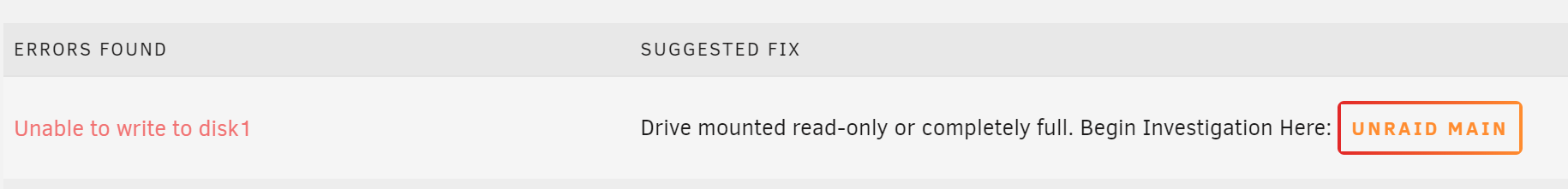

Ugh, now it's saying that Disk1 can't be written too.
Disk 2 is currently being rebuilt.
Disk 1 started throwing millions of errors during the disk 2 rebuild.
Am I going to lose 20+ TB of data?

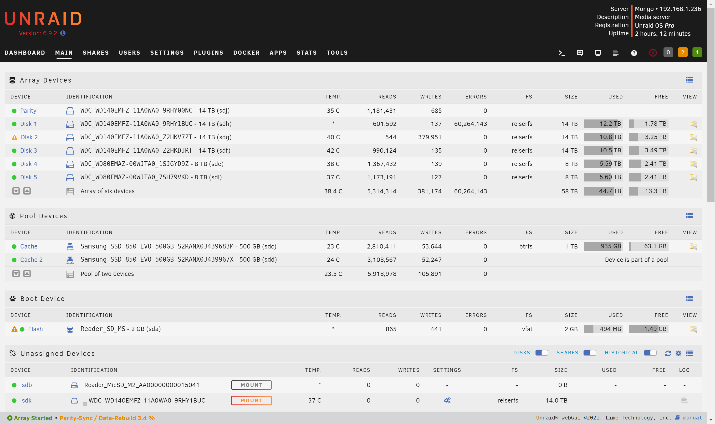

@JorgeB the rebuild of Disk 2 did finish (not 100% sure if finished correctly). I hope I didn't screw myself by doing that :(
I only had one spare SATA cable so I replaced it on Disk 1 (which was the one throwing the errors). I rebooted and Disk 1 is showing disabled. If it was a bad cable that did it, how do I get the array to pull Disk 1 back in?
mongo-diagnostics-20210727-1755.zip

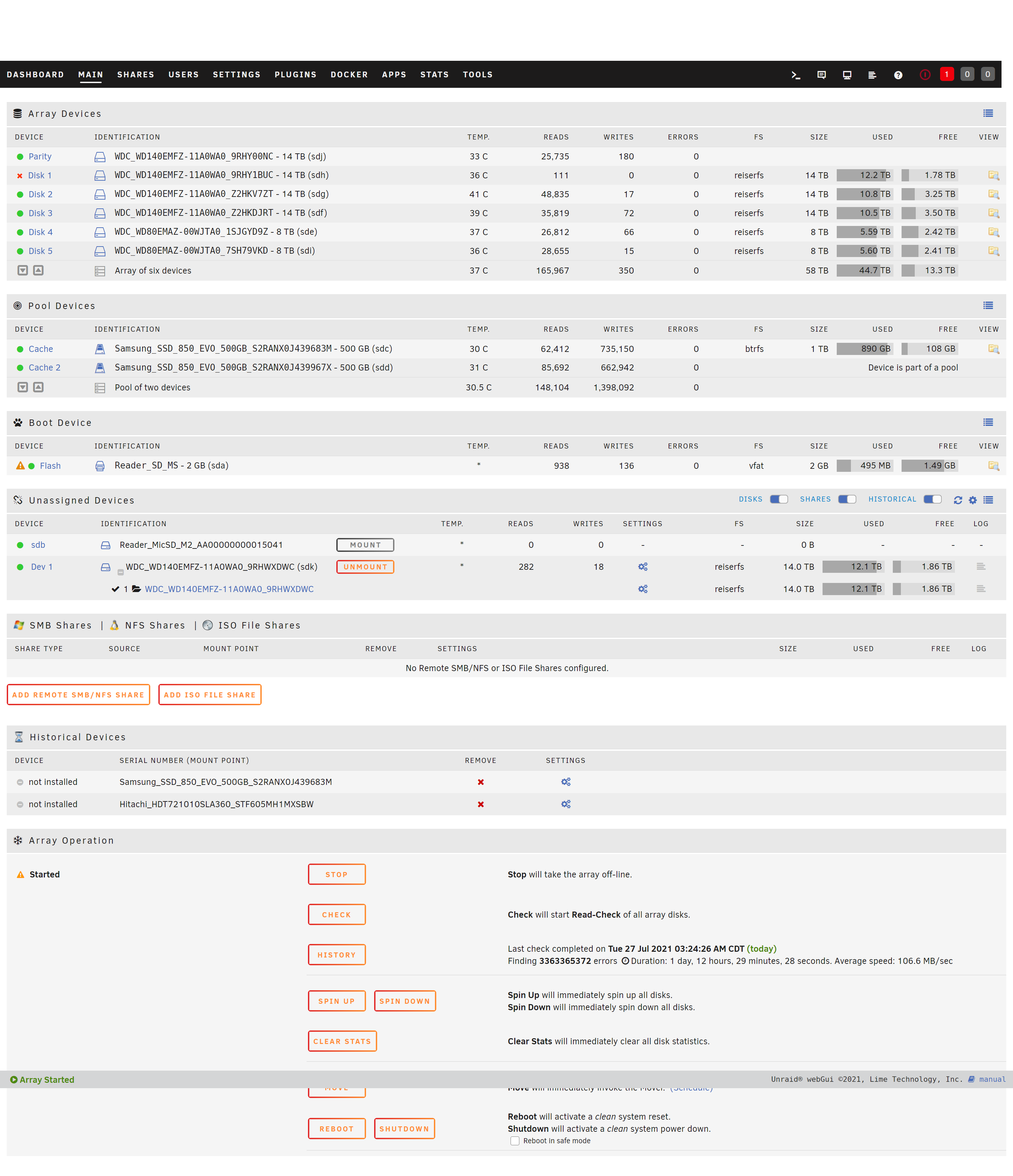

rebuild it
1 minute ago, trurl said:
rebuild it
So I just want to be sure about something.
I had Disk 2 go down last week, so I replaced Disk 2 and started a rebuild. However, during the rebuild Disk 1 started throwing errors and I couldn't access files on that disk. But the rebuild supposedly completed on Disk 2 (says lots of errors).
If I now try a rebuild on Disk 1 and the Disk 2 data is corrupted, will I lose the data on both drives?
Just now, cypres0099 said:
replaced Disk 2
Do you mean you replaced it with another disk?
Oh boy, I think I'm losing track of what disk went bad when.
A disk (pretty sure it was disk 2) went offline last week and I replaced it with a spare disk I had in case of this situation. While it was rebuilding, Disk 1 started throwing errors.
2 minutes ago, trurl said:
Do you still have the original disk?
Yes
What made you think the disk needed to be replaced? Connection problems are much more common than disk problems. Probably nothing at all wrong with the disk.
Can you mount it in Unassigned Devices?
I just didn't think through the problem very well. Saw a failed dis and thought "I have another disk to pop in there" so that's what I did :-/
I just hooked up the drive that I thought had failed to an external sata enclosure. It's now showing in unassigned devices.

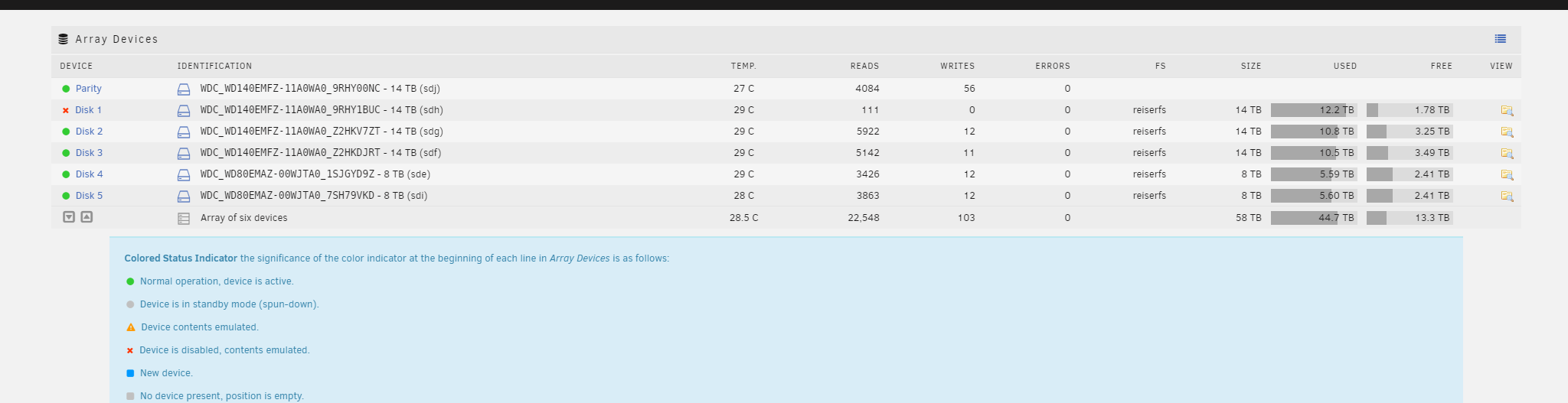

This is what my current situation looks like. The unassigned drive (that i thought had failed) is accessible in my windows network folders and it's about the same size as Drive 1. So maybe I got confused about which drive was having the errors and replaced the wrong drive? So the unassigned drive is actually a still good version of drive 1 and I can just put it back in place of the red x Disk 1?
Do the contents of disk2 look OK after the rebuild?
Do you have backups of anything important and irreplaceable?
Any disk you assign as disk1 at this point is going to result in a rebuild to that disk.
Post new diagnostics since you mounted that original disk with Unassigned Devices and wait for further instructions.
Would have been better if you had asked for advice before doing anything.
