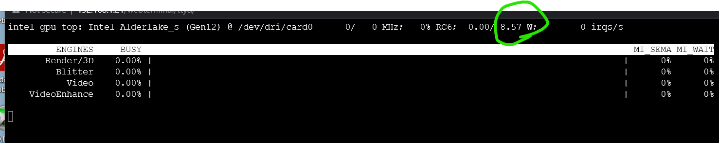

running the latest RC3 unraid and latest plex pass version of plex with HW transcoding/encoding/decoding enabled with HDR off it seems to transcode fine except when finished transcoding the gpu plugin still shows power draw. In my second screenshot is the value I have circled in green gpu power draw or CPU usage power draw? EDIT: I believe it is CPU power draw, i kicked off a cpu intensive task and watched the power jump.
No crashes yet, just noticed this odd behavior.
Edited by philbar715
Yeah, my GPU stat's plugin also maintains the power draw bar at full after I have finished the transcode. I think it's the plugin though that just needs updating.

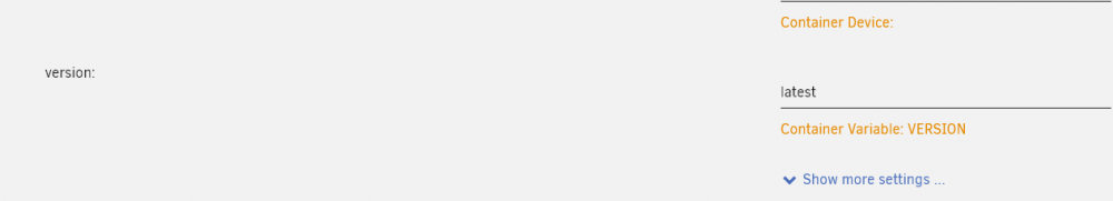

on the linuxserver container there was already a version tag that I changed to 'latest'. honestly have not figured out how to add tags yet, unless tag=variable or label.
I can't get an image now, but there'll be a field "Repository" that has "plexinc/pms-docker" (or "plexinc/pms-docker:latest") you just add the tag to the end of that, so change it to "plexinc/pms-docker:plexpass"
