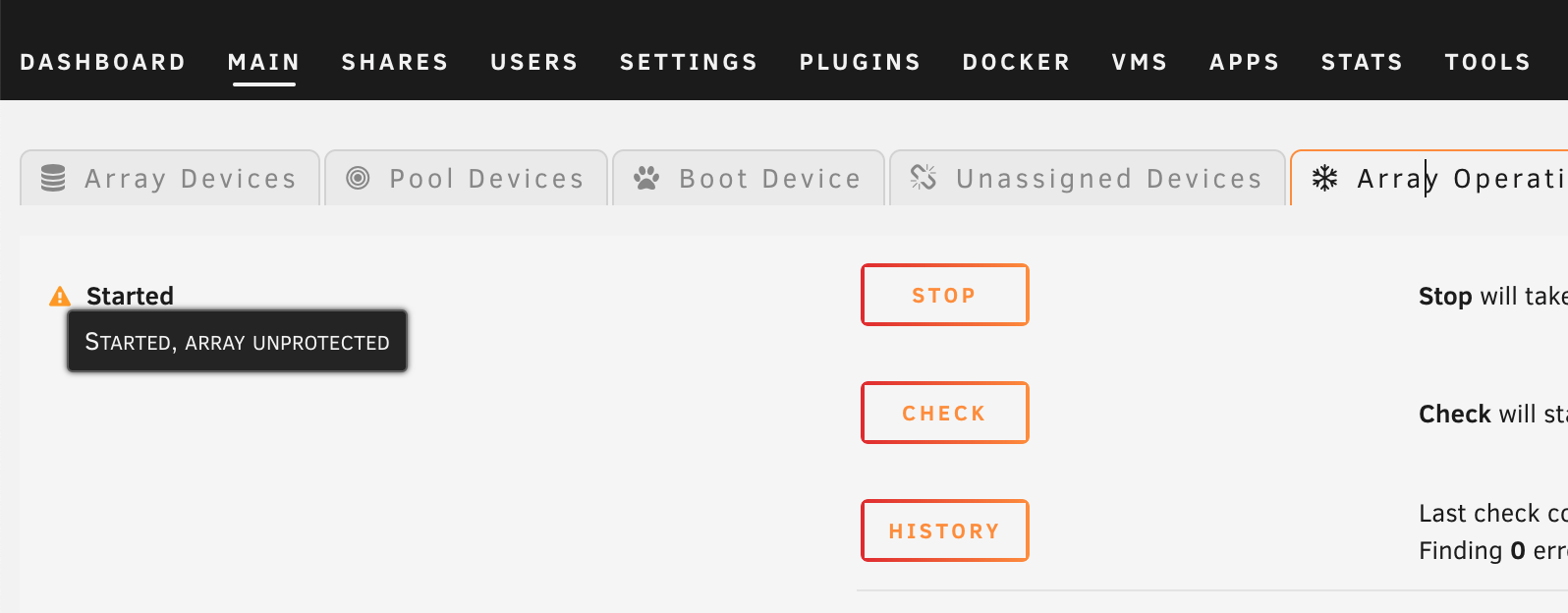

It went a little bit different as in the description: unraid did not present an option to say "Partity is valid". It just wanted confirmation that I really want to start the array. The array is running now with 2 data drives being unassigned  (and showing up in "Unassigned Devices" (just according to my plan).
However, in "Array Operation" it says "Started, Array unprotected"
In contrast to this it says in the "Main" view: Parity is valid.
Reminder: 2 data drives unassigned, and there are 2 parity drives.
Observing the Reads and Writes under "Main>Array Devices" it seems like it is doing a parity check or rebuild: it is reading from all drives and writing to the parity drives.
But - nowhere on the UI it is saying that a parity rebuild is running.
This behavior is  - at least to me - confusing (mixed signals: Array unprotected vs Parity is valid; not saying that a parity rebuild is in process).
Is it in fact rebuilding the parity now? How can I confirm this?
Or do I need to trigger a parity rebuild? How? (6.9.2)
Edited by b0m541

The data transfers were not caused by a parity rebuild, I found a container that continuously write to a drive. After stopping this container there are mostly 0 reads and writes -> not a parity rebuild ongoing.
So the question is, why unraid did not ask whether the parity is still valid and why it did not start a parity rebuild.
Even more important, how would I trigger a parity rebuild now manually?
Edited by b0m541
As far as I can see I can only start a Read Check, which is peculiar. The Wiki says:
"A Read Check is also the type of check started if you have disabled drives present and the number of disabled drives is larger than the number of parity drives." (https://wiki.unraid.net/Manual/Storage_Management#Read_check)
Since I have 2 parity drives and I unassigned 2 drives I should be able to run a parity check or parity rebuild?
This is what my original question was about: May i unassign 2 drives at the same time and then run a parity rebuild once? The answer was positive.
Obviously it does not work like that.

Due to lack of options I repeated this procedure: https://wiki.unraid.net/index.php/UnRAID_6_2/Storage_Management#Reset_the_array_configuration
This time the result was as described in the Wiki, the content of the parity drives was invalidated and a parity rebuild started when I started the array.
I do not understand why that did not happen the first time, but now it works.

Perhaps you did not successfully run the New Config step?    If so that would have explained your symptoms.
Possible, but if so, it was non-obvious.
