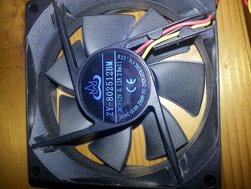

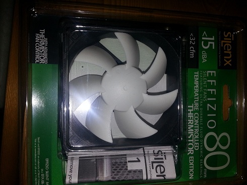

I attached pictures of both fans, in the same way they were installed (I think)
- label up for the stock fans (black)
- the same way, I think, as shown in the other picture for the SilenX fans. I will check when I get home tonight.
From the Effizio instructions:
*Determine whether the fan will be used for intake or exhaust. The label faces the direction of the airflow. If you want to sue the fan for intake, the label should face into the case. If you want to use the fan for exhaust, the label should face away from the case
In this case, as I am sucking air through the front to the back of the caddy, the fan, if understand correctly, is being used for exhaust.
Therefore, I should be able to see the label from the back of the caddy, once the caddy is put back together, right?
I was able to see the label of the stock fan at the back or the x-case...
In your two photos, the stock fan is blowing the air towards us, the replacement fan is blowing the air away from us.
Ouch Charlie... It would seem that I HAVE installed the fan incorrectly.
Will check tonight and confirm, thank you all for your help so far...
Well, it looks like I did install them correctly, pics attached.
