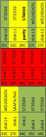

Finally tested the swif2 fan on the middle caddy, drives circled in the picture, temps are 2c or 3c up compared to stock fans. Test was parity calculated for two hours. I shall treat the Noctua next and see if I can get even better cooling.9epugamu.jpg

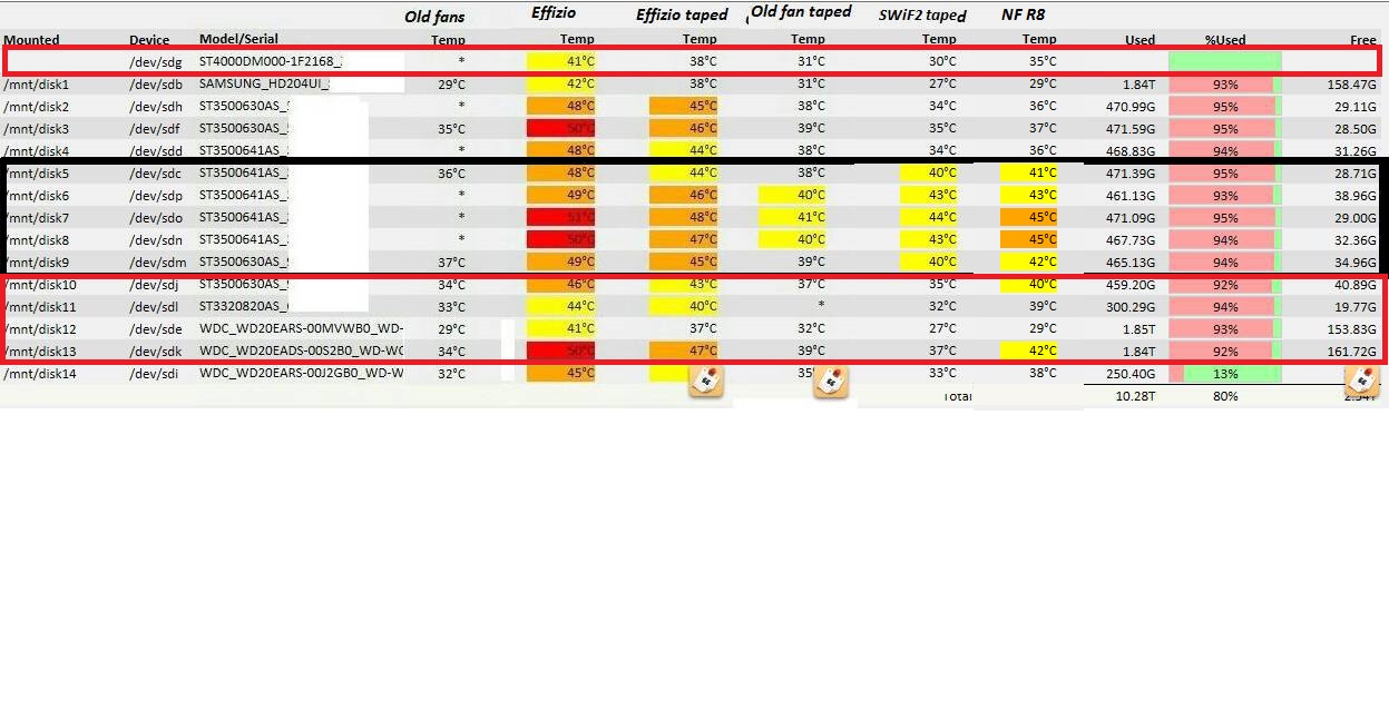

A quick pic showing hard disk temps in my current setup during parity calculation. I will switch around the drives so all the yellows (less than 32C) are together in the same enclosure, and focus on reducing the temperatures or the reds (40+) with the NF-R8.
So installed the NF-R8 in the same setup, in the same middle caddy where I previously installed the SWiF2 (black square in the temps pic).
I moved the SWIf2 in the top caddy (red squares around the drives in the temp pic).
I am getting a couple of degrees hotter drives with the NF-R8 in comparison to the SWIf2 when calculating parity.
So far the winners are the SWiF2 for hot drives cooling it seems.
Interestingly the cooler drives are getting 5 degrees hotter during parity with the SWIf2, whilst the hotter drives were only getting 2-3C hotter (might also have to do with airflow for the upper caddy).
I am going to buy another one and then I am going to put it back on the hotter drives.
In the new setup temps will stay below 45C, which I am happy with, when calculating parity (once in a blue moon), and below 35C when watching movies.

I received the last swif2 fan installed it in the remaining caddies.
I also swapped hard disk around between top and bottom caddies to place all the cooler drives together in the top caddie (circled in green). I used the NFr8 fan for the top caddie, and slowed it down to 1300 rpms.
For the other drives circled in black (the hottest ones), I used the swif2 fan I used previously, in the same caddie, with the same drives. Interestingly temps with the same setup in that caddie are higher after two hours parity calc.
The other drives not circled are in the bottom caddie with the new swif2 fan.
I must say it's real quiet now and I can live with this extreme temps for parity calculation which will only happen when I replace the parity drive next.upe2a3ar.jpg
