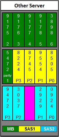

You can print out some stickers and label the drive trays yourself, or just organize your trays in a logical manner (parity in tray 1, disk1 in tray 2, disk2 in tray 3, etc.) so that you can easily identify a failed drive.
With the help of another unRAID user, I use Excel templates for disk cataloging. I can send along the blank template to whoever wants it. Just send a PM. Once I input the serial numbers, I snip the relevant section, and save the file to server\flash\unmenu\images\ and MyMain displays the exact layout of all installed disks.
This works best with a hard disk serial number file. Mine is in Excel so I can sort by warranty expire.
